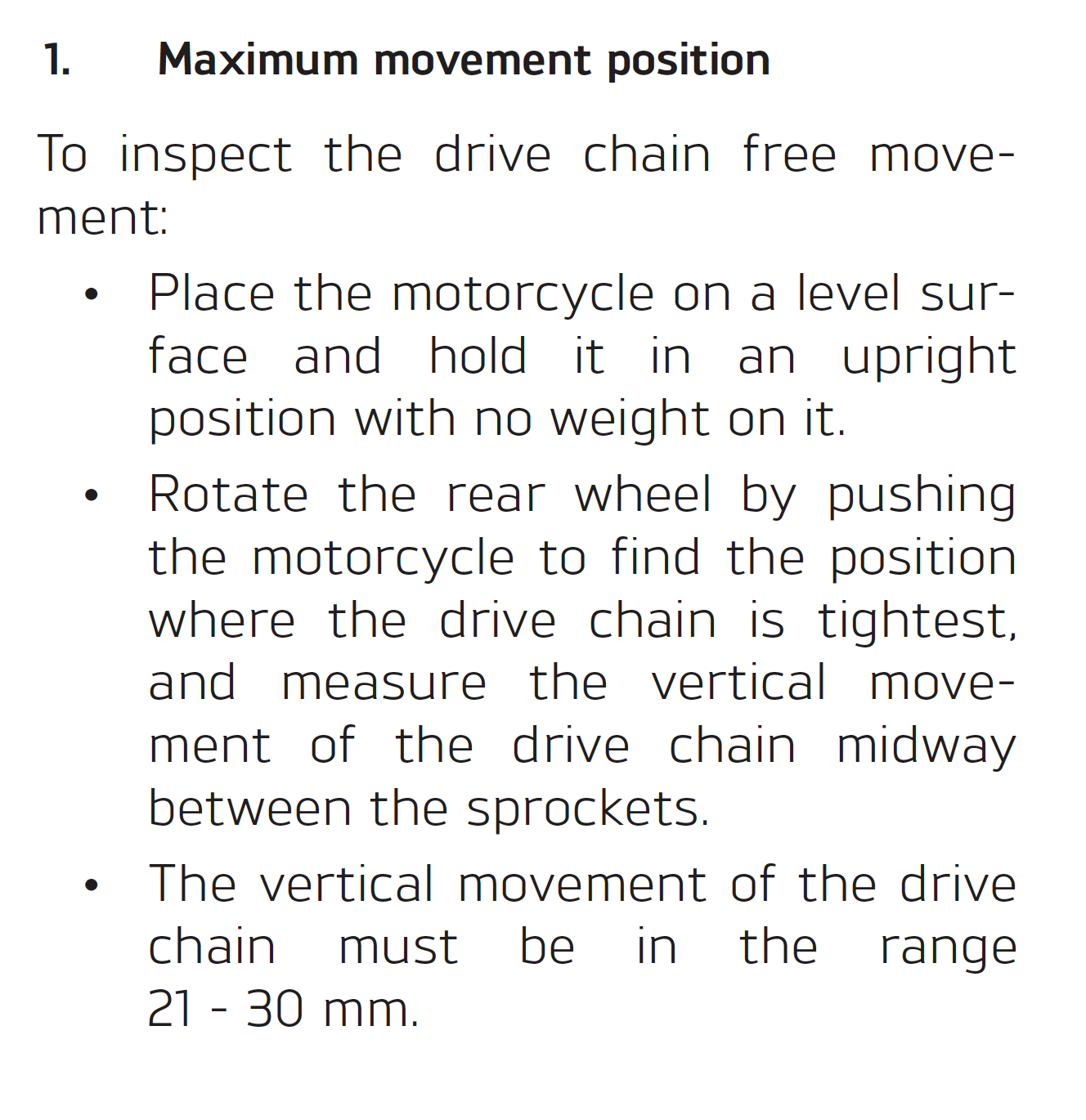

    Well...I described my approach, which has always worked out for me.
    I thought it worth checking what it says in the manual...perhaps I should have read it before posting :D
    I inherited my method up from a different bike (Yamaha possibly) and didn't think it would be something that would vary. What I'm realising now, is that the measurement range given by the manufacturer is based on a specific method of measuring it.
    I assume then, that 21 - 30 mm requires just the bike weight to be on the rear wheel and a different measurement would be given if it was on paddock stand, or with a rider sat on it.

    But you're disagreeing with an excerpt from the manual itself. Go figure.
  16. Oldyam
    Oldyam Grumpy Old Git
    May 14, 2017
    613
    ireland
    This method describes the chain slack measurement when the bike is unloaded resting on both its wheels ( NOT on a stand ), as it describes rolling the bike forward to find the tightest point in the chain run.
