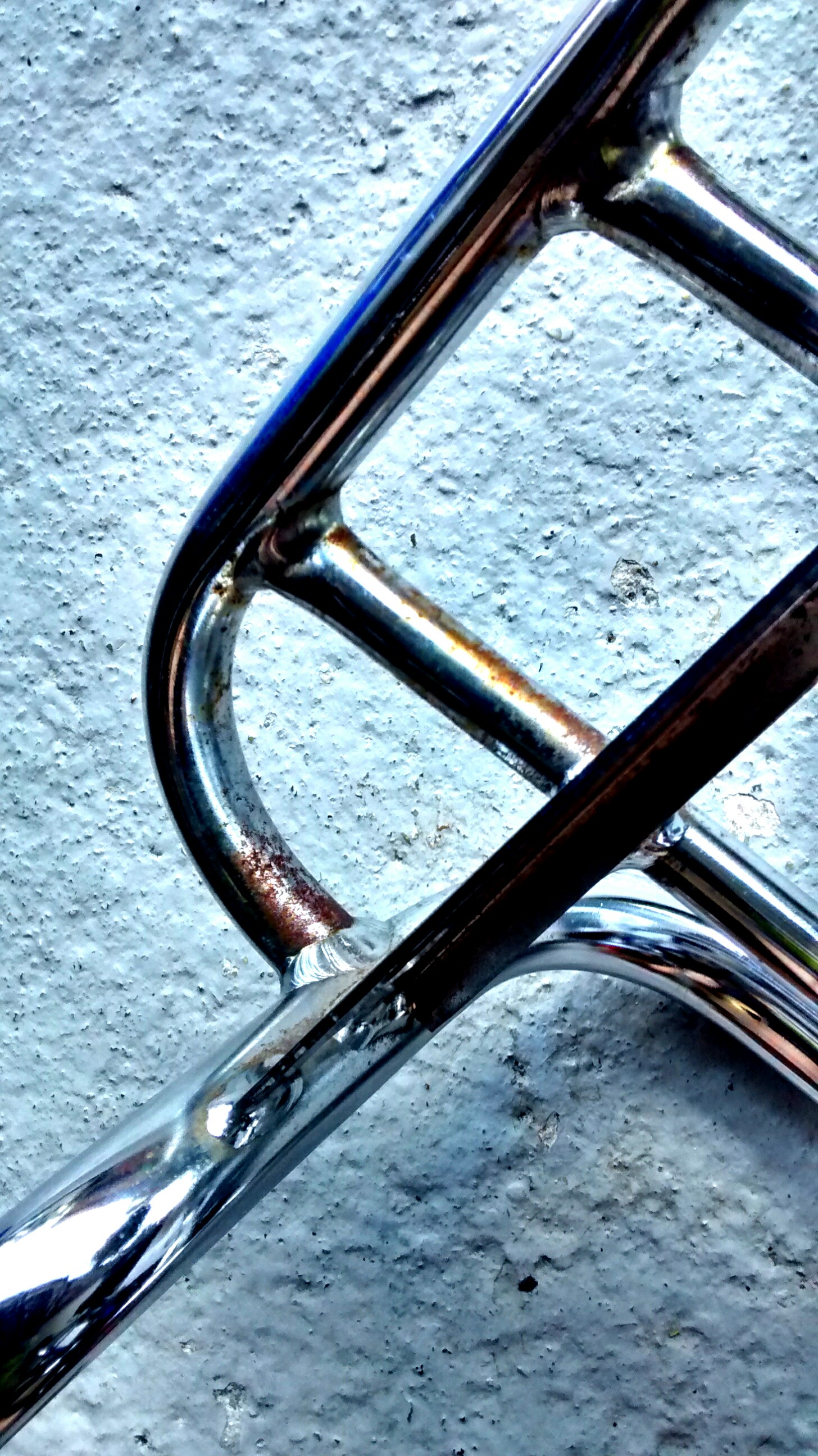

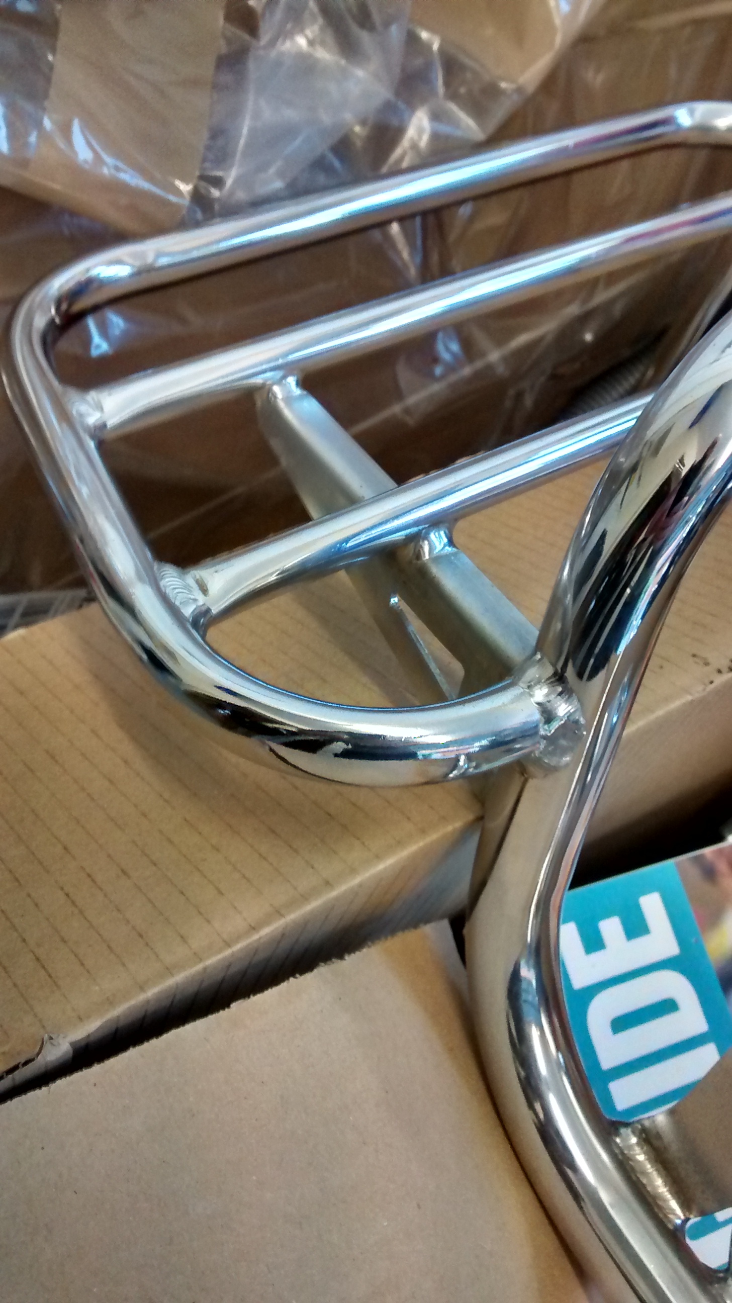

    You can clean rusty chrome with tap water and kitchen foil. Don't ask me how it works but it does.

    4,082
    WOW that's impressive. Do you know of anything that I can rub my wife's car with that'll get rid of all the bumps and scratches ???
  7. andypandy
    4,082
    Could it be because the aluminium in the foil is more reactive than the chrome so oxidises thereby removing it from the chrome ????????
  8. steve lovatt
    9,228
    It could be - it sort of forms a dark grey paste after a short while and the rust seems to disappear at that point.
