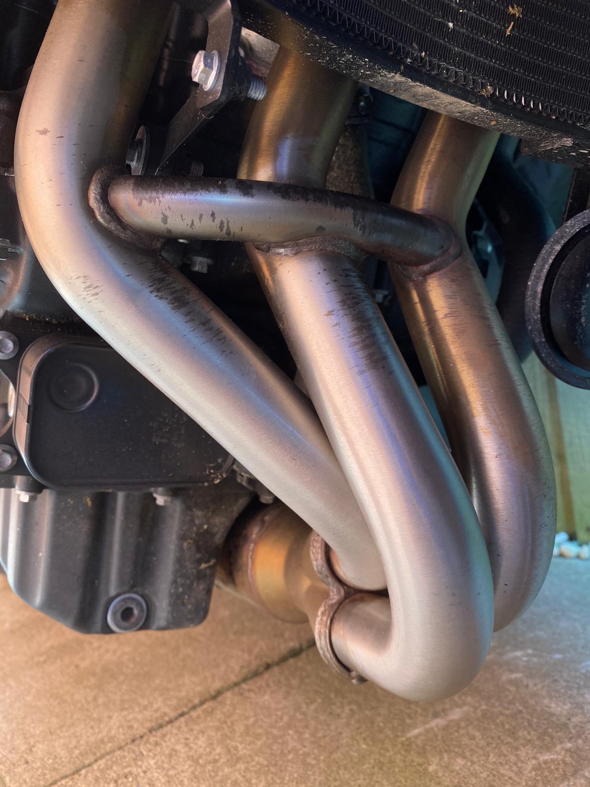

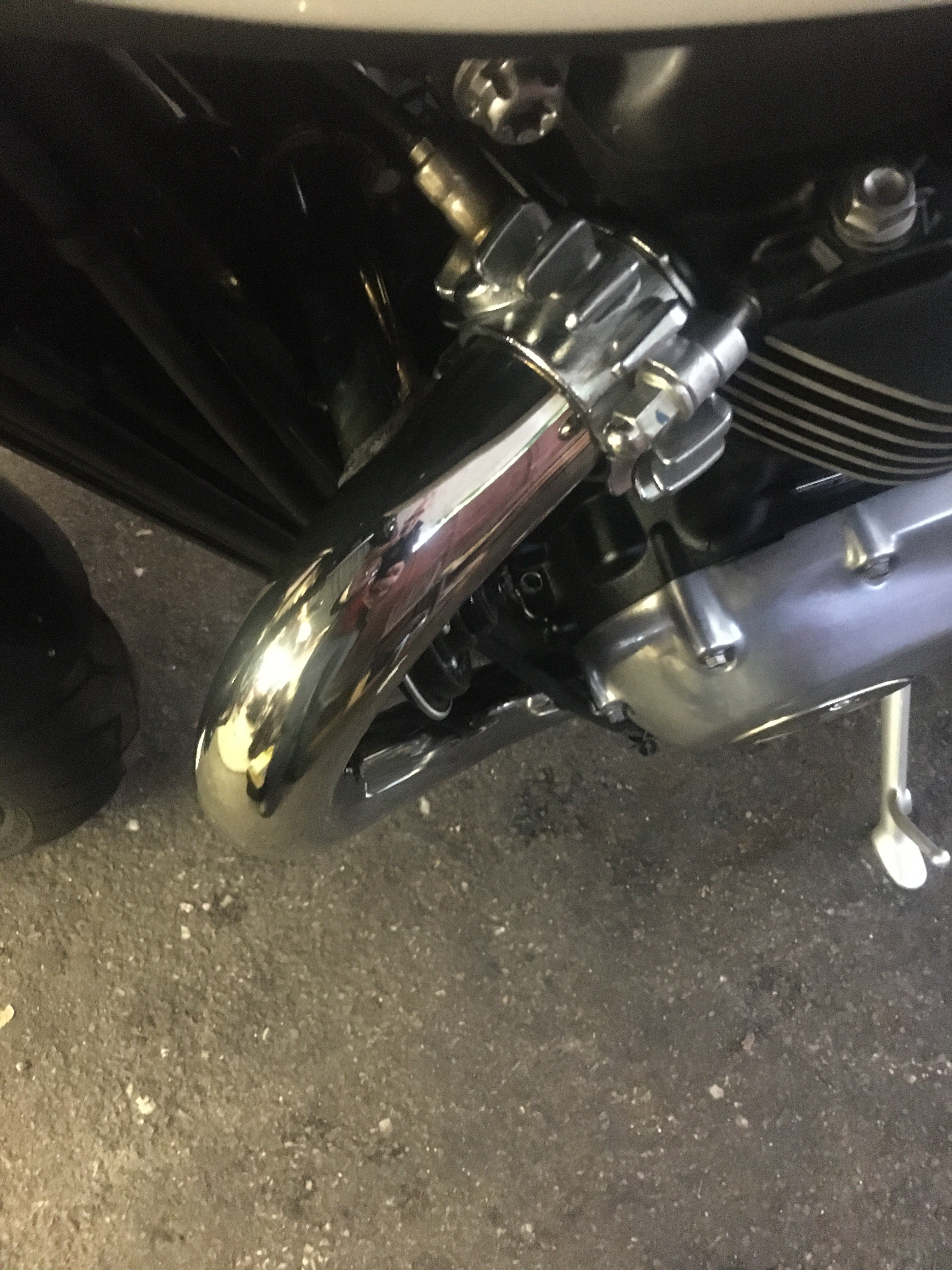

    I just cleaned the oxide layer from the downpipes on my TT1200, only took 15 mins to do both sides, not sure how long it will last but I did the same on the fake pipe near the catalyser about 500 miles ago and it hasn’t returned yet, here’s what I did.
    1. Clean the area with brake cleaner and kitchen towel to get rid of any grit.
    2. Applied “Zephyr Pro 25” cutting compound using soft material from an old T shirt, lots of rubbing in a circular motion, occasionally changing the area of cloth and reapplying the cutting compound.
    3. Clean off area with furniture polish on kitchen towel.
    4. Clean area off with brake cleaner to remove all residues.
    as I said not sure how long it will last but I will report back once I start riding again (when the salt is gone and dry roads reappear!)
    Here’s a before and after. 175ACA2D-457B-4B0E-A004-C7B4CE7A836C.jpeg BA93C451-F490-4BAF-8B18-45A2EBC2C06E.jpeg

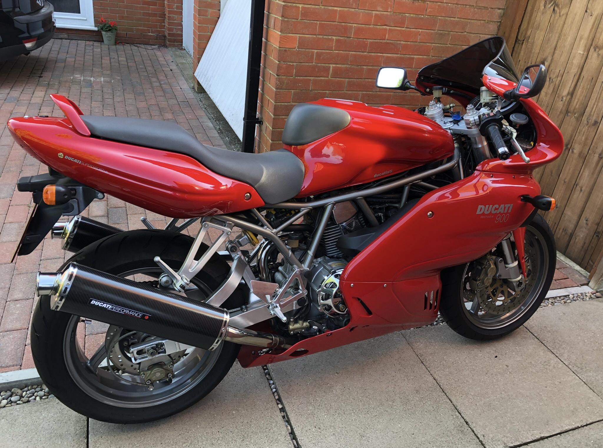

    You can get SS pipes to look pretty good if you have a buffing machine. Below you will see the before and after of the pipes on my Ducati.

    Apologies but my iPad is telling me that the after photo is smaller than the before one but the forum is telling me that it is too large. You can catch a glimpse of the after version in this photo.

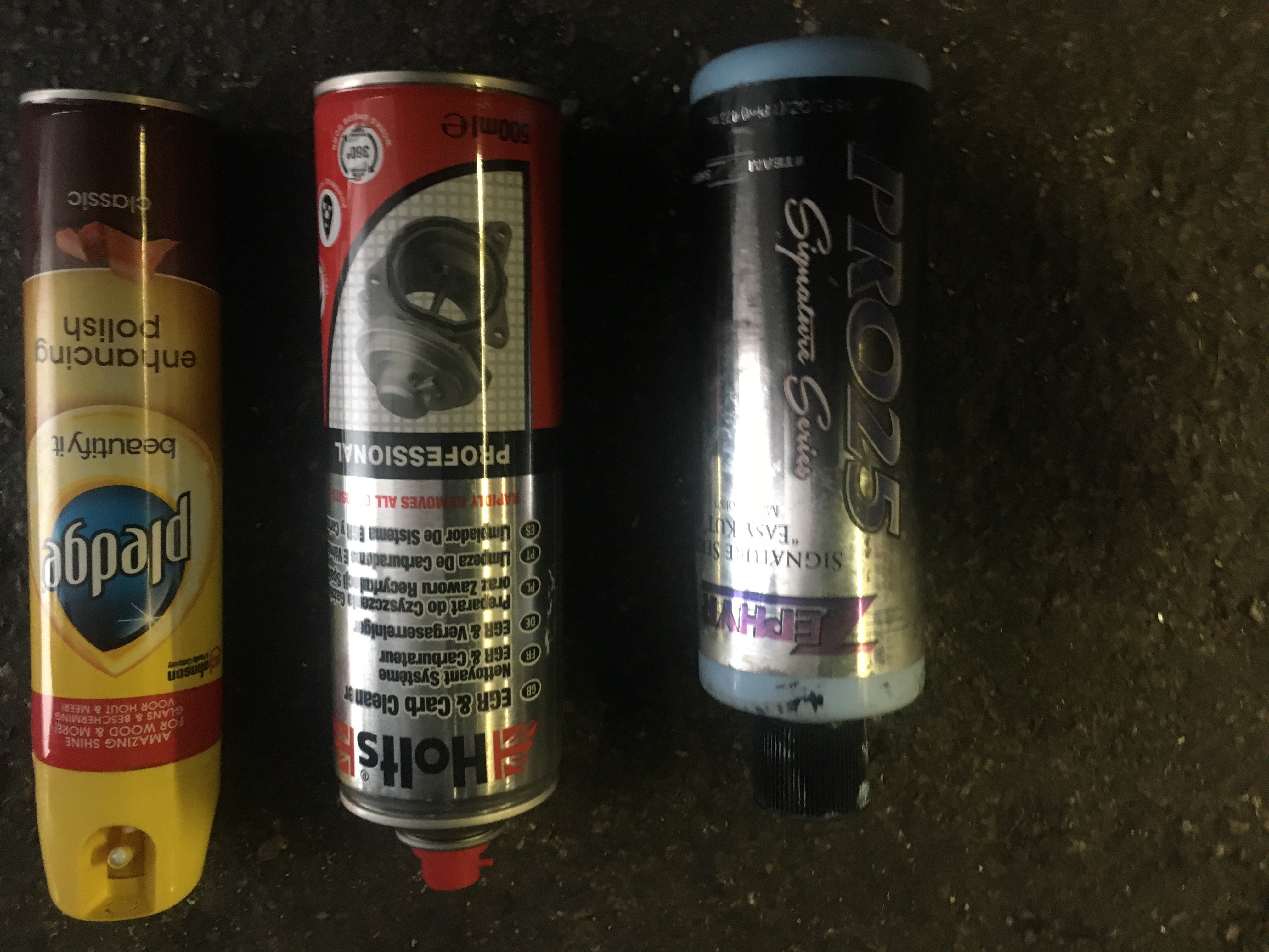

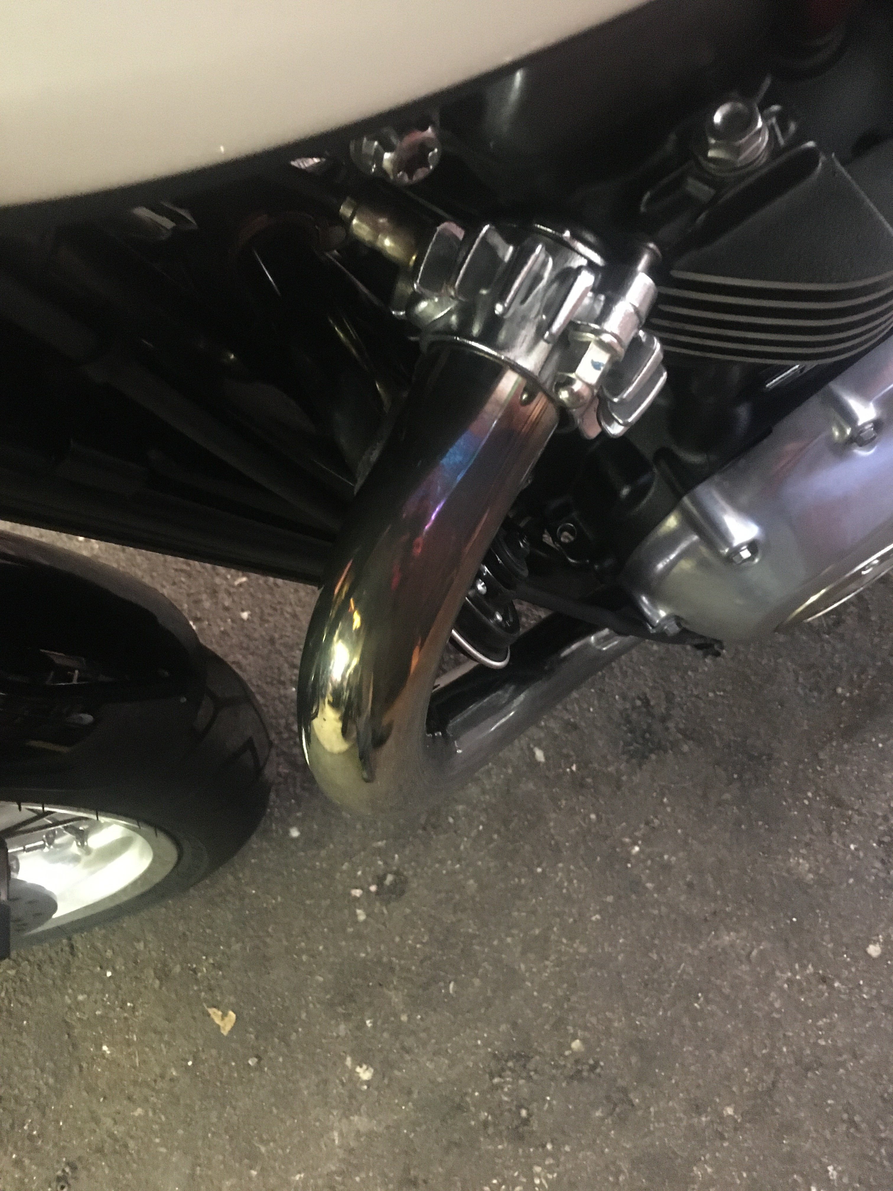

    For SS pipes I had read that a well known toilet cleaner produced amazing results. So, having some to hand I thought I’d give it a go. The recommendations tell you to use it in conjunction with Scotchbrite but as this was just an experimental trial I just used a wad of kitchen towel, so no abrasive used to produce what you see below.
    Here’s the product.
    And here’s the result. Only used it on two of the pipes in order to show a comparison.
