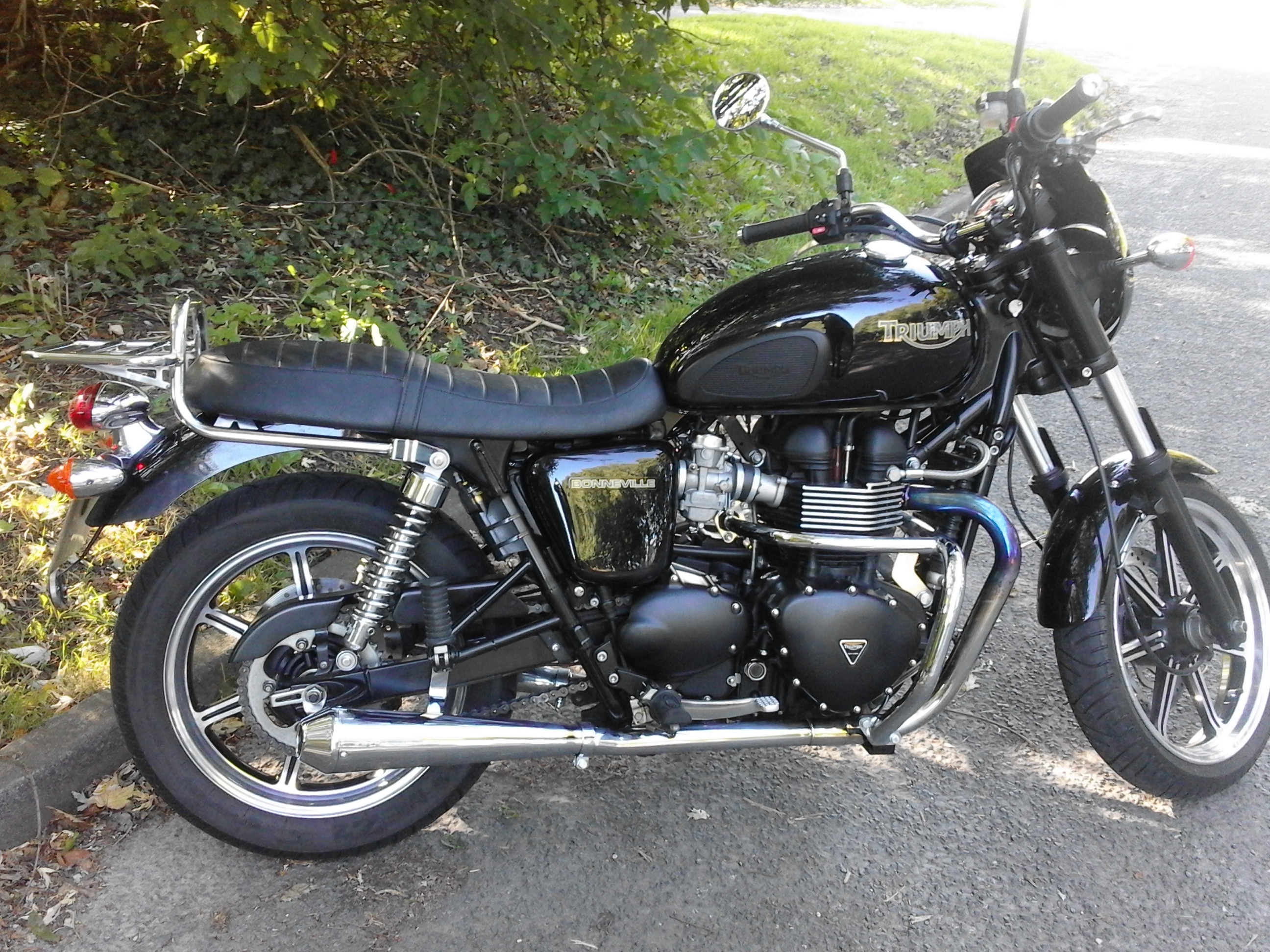

    A review of the new exhausts ie short megaphone. Well on tick over nice grumble sound, but afterwards LOUD. However it was the banging & popping which made it seem i was riding a firework. Now i realise i havent taken off the SAI system but it's annoying & the centre stand had to come off. I am going to ask if i can return them unless anyone else wants them at a reduced price. i hope the pictures do them justice as they look good. 2016-10-05 13.59.00.jpg 2016-10-05 13.59.00.jpg

  17. crispey
    7,198
    The popping will stop with the sai removed/ disabled. Are the baffled removable? If so you might be able to wrap them to quiet them down a bit

    The baffles are meant to be wrapped already according to the description. I would remove the SAI if i was going to keep them, but hoping to return.
  19. thebiglad
    5,064
    Hi TP, I hope you don't mind me saying but those pipes are currently set really, really low.
    1. Wrapping the baffle will reduce the sound, but honestly you may be concerned by their loudness only in comparison to the original Triumph pipes, which are whisper quiet;
    2. Removing the AI system will stop the banging and popping on over-run. Having open pipes just shows up what is happening that much clearer.
  20. Taxpayer
    Taxpayer Member
    Sep 20, 2016
    17
    Lancashire nr Blackpool
    Yes i agree with the low position but when using the link pipes they made the exhausts splay upwards & outwards & looked terrible. Its a shame i didnt take some pictures so you could see what i mean. Looking from the side they were raised up & okay but the back view looked out of character with the bike. I know its all a matter of opinion but the minus outweighed the plus.
