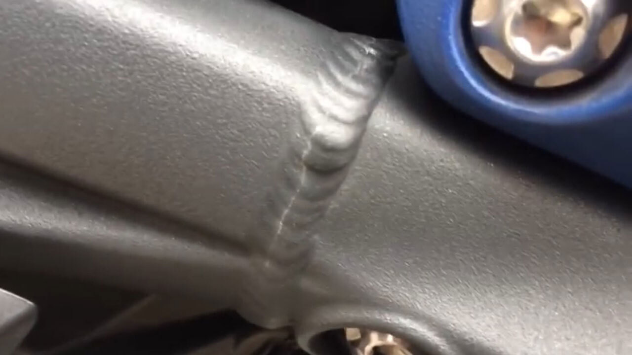

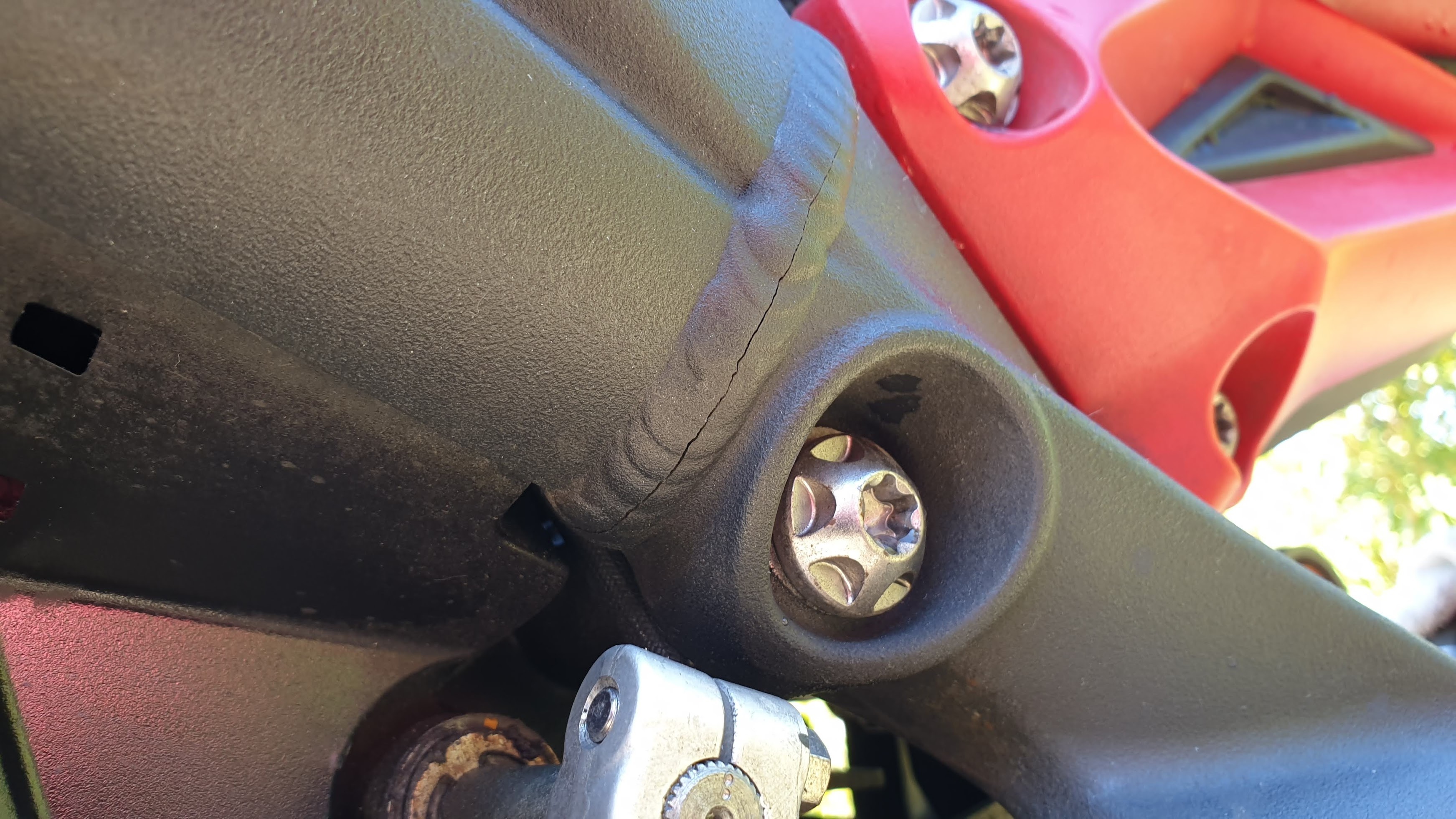

    If you own a 2013-2017 Street Triple or Daytona, check your engine mount bolt torque and frame welds! This may also affect ANY Triumph motorcycle with this frame installed.
    Hi all - I wanted to bring an issue to your attention which is serious and unfortunately is being dismissed by Triumph.
    I own a 2013 Street Triple R. I bought it brand new from a Triumph dealership. It's covered ~19,500 miles and has full service history, all undertaken by the same dealer. The most recent service was on September 30th 2019 @ ~19,200 miles. A few weeks ago I was cleaning my bike and found this;
    Check your bikes - who knows what could happen to you if these welds snap while you're riding!
    The issue appears to be that the engine mount bolt has come loose (you can see that it is sagging) which has put undue stress on the frame, causing a crack down the middle of the weld.
    If your bike uses this same frame check that your engine mount bolts are torqued to spec or this could happen to your bike as well.

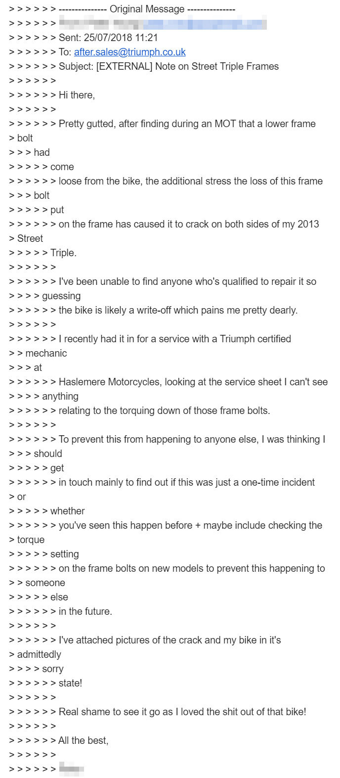

    Here's the part which really disappoints me that everyone needs to know about.

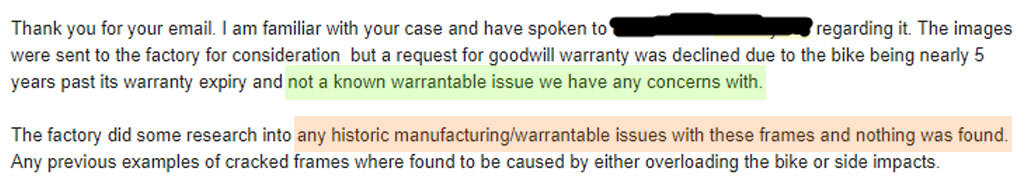

    I reached out to Triumph and their response was dismissive and inadequate. I was told that it's 'not a known issue' and that 'they're not concerned with it' - denying me a repair or replacement of any kind;
    Here are more examples of this 'unknown issue';
    Here is proof that the issue is known and has been previously addressed.

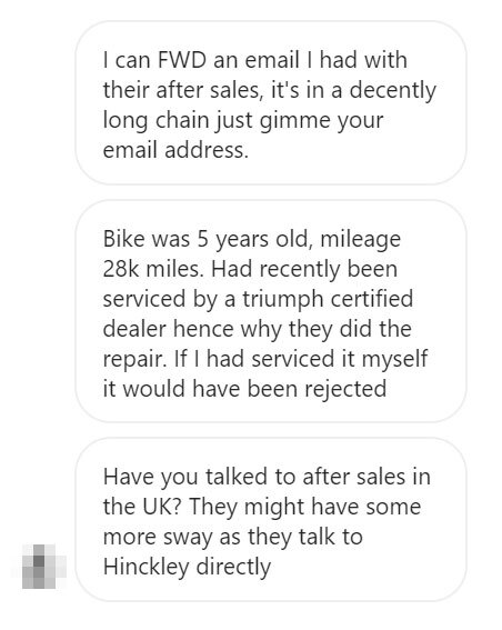

    Someone reached out to me who had reported the same problem. Triumph repaired his bike in 2018. He even deliberately draws attention to the bolts;
    So we know that this issue is happening to people, we know what causes it and we know that Triumph is aware of it. However, this is the annual checklist that was used to service my bike in September 2019;

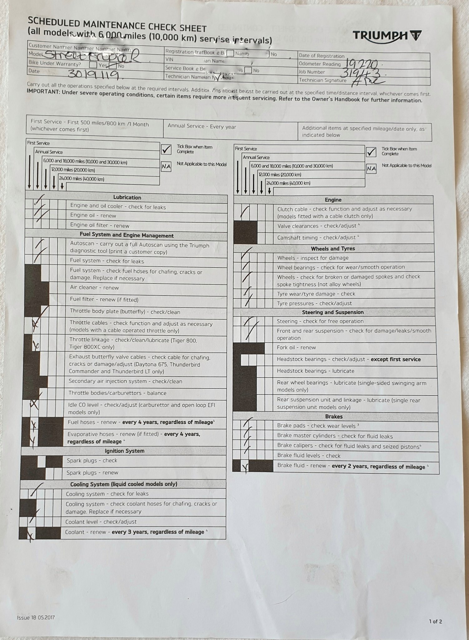

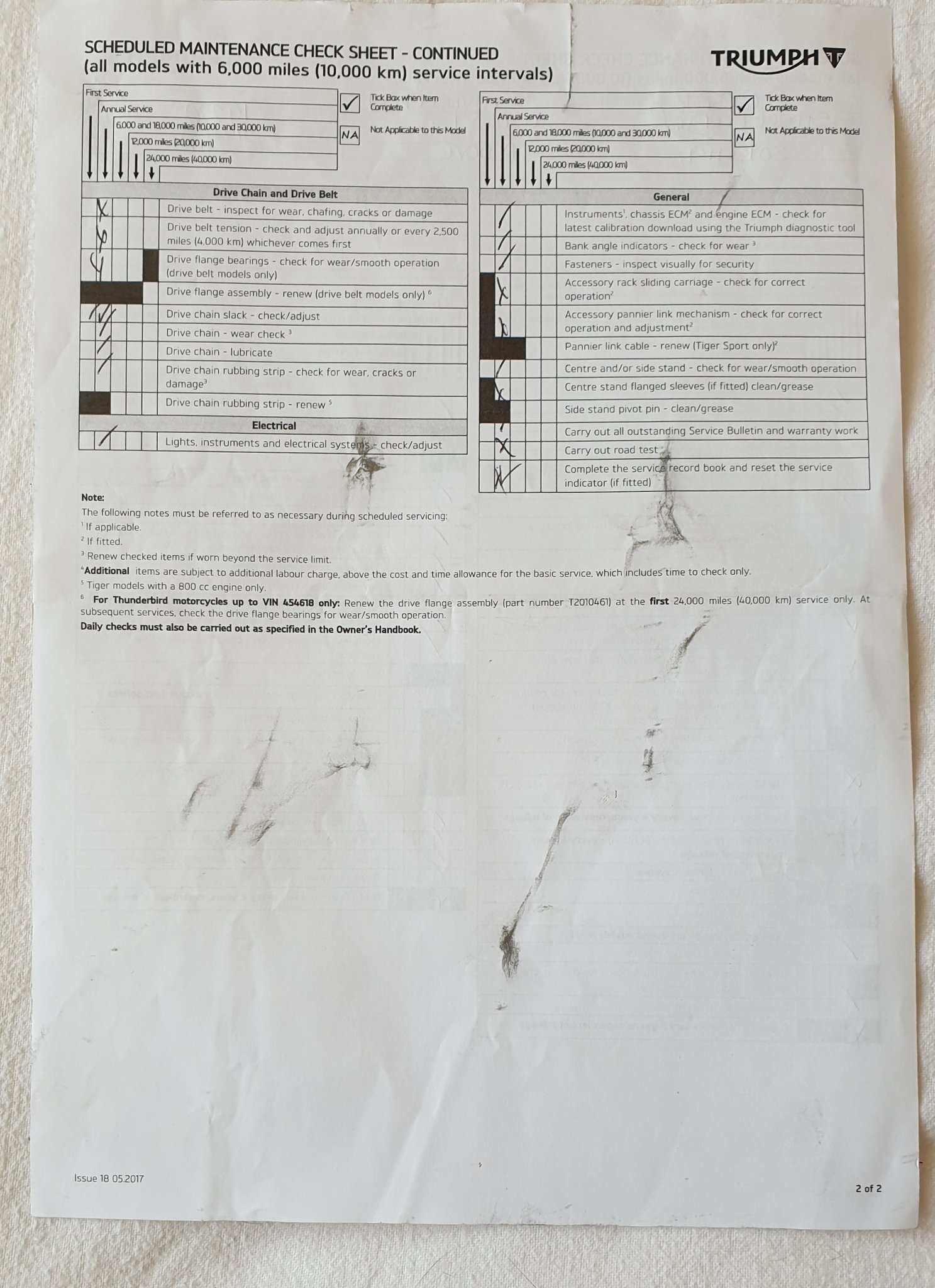

    At no point on this list is the technician instructed to check the torque on the engine bolts. The closest 'arguably related' check is 'Fasteners - inspect visually for security' which is clearly inadequate and will not prevent this problem affecting other motorcycles. At the time this check was carried out Triumph have known that this happens for at the very least 14 months, yet haven't amended their service sheets.
    I was turned away for a repair when a structural, non-consumable part of my motorcycle failed catastrophically due to a flaw that was outside of my control, not checked by Triumph dealerships and not present on Triumph's own service sheets.

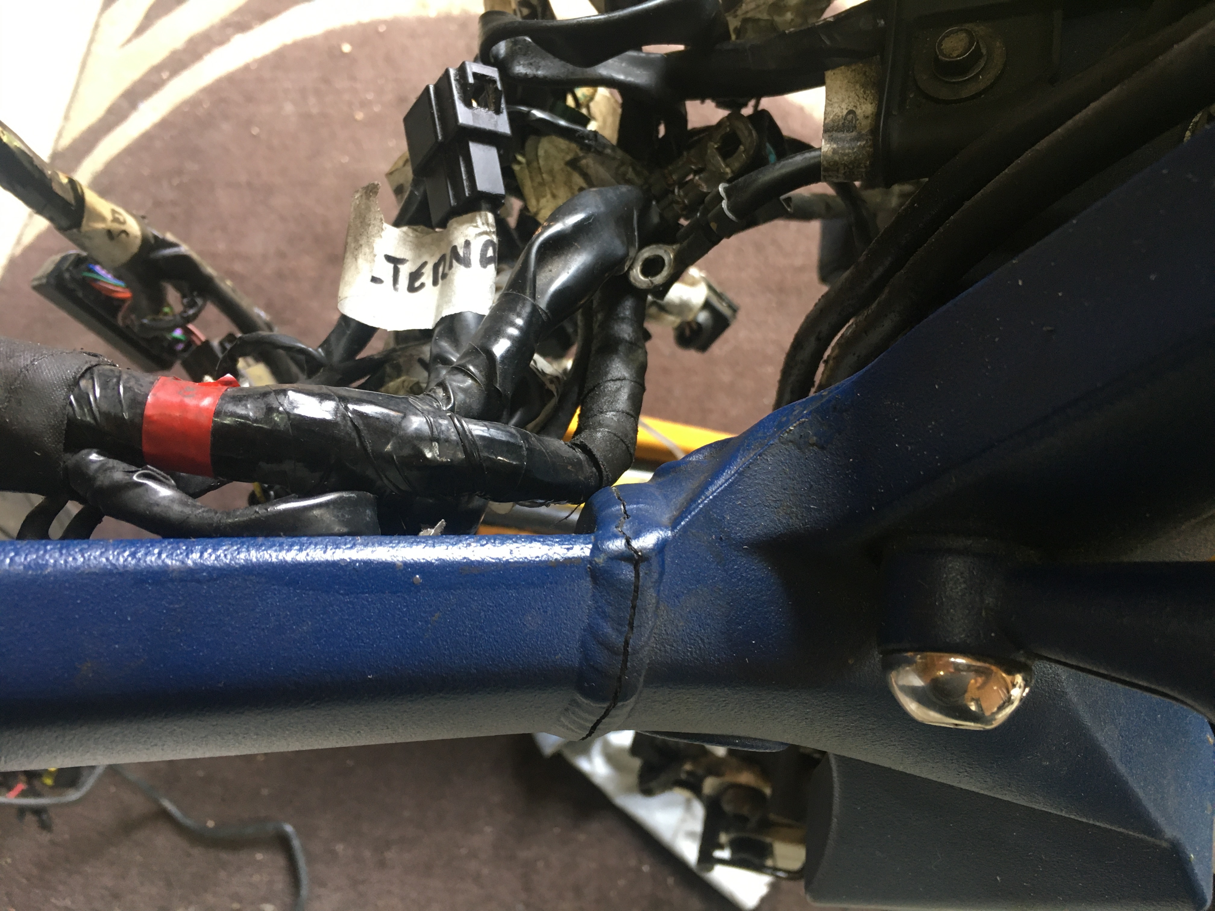

    I also have come across this problem. I have a 2010 Daytona, which I’ve owned for 6 years and has 31k miles on it of which I’ve done over half that myself.
    I noticed the crack after getting it out of winter storage. I have my bike serviced by Triumph and they didn’t pick up on it at the time (but why would they? It’s not on their servicing schedule).
    I immediately contacted my local dealer who told me to contact Triumph UK aftersales report so I wrote them an email which I got a prompt reply to effectively go f*ck myself and it was my fault I didn’t check my engine mount bolts were torqued correctly. I’m on my own. I understand that my bike is now 10 years old but if your car or bike literally snapped in half after 30,000 miles you’re telling me that you’d just put it down to simple wear and tear? Thought not.
    Triumph seriously need to acknowledge that this is a really serious manufacturing defect. The sad truth is, this can so easily be avoided but literally tightening the engine bolt nuts periodically.

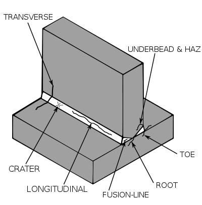

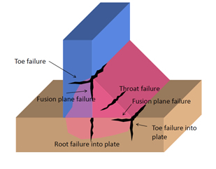

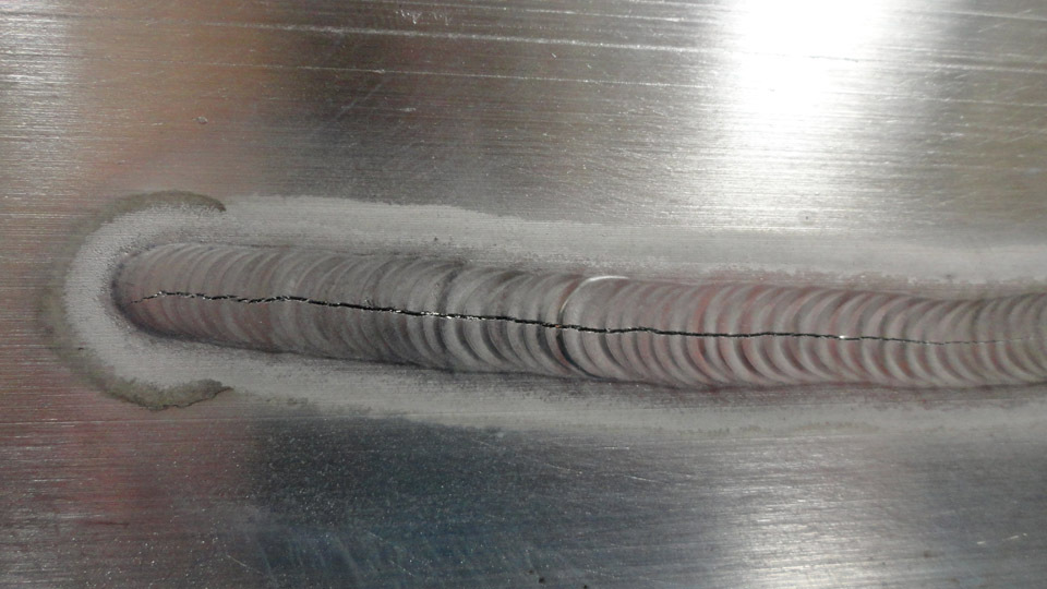

    I don't have much knowledge of welds, but as Tricky-Dicky said "if the welds are that bad...."
    As far as I can find out, welds fail in specific places for specific reasons and you need an 'ology to talk about it. But I looked at Mr Smo's photo and thought it was odd (and rare I think) that the crack formed right down the centre line of the weld and in a short run of frame that can't move much between two engine bolts. The vertical section of frame behind this bolt, to which the swing arm mounts, is much longer and has all the loads from that.
    If you search for weld failures you find details of "throat" and "longitudinal cracks" for which there are very specific reasons which seem more to do with the quality of the weld than the stresses being put through the joint.
    Now most of us don't touch frame to engine bolts apart from those with crash bungs, so why is it reasonable to expect the owner or dealer to touch them or check them periodically if they are not deemed safety critical, like caliper bolts or something.
    If the bolts has come loose since the factory did them up with loctite, then there is a problem with the loctite or the torque setting. (like the gear linkage coming undone).
    I can see that if the bolt comes loose, and they would have to on both sides, which is not a coincidence, then the stresses from the swing arm will mobe up into that short section of frame with the welded joints.
    So my questions are;
    -did the bolt come loose on it's own or was it helped by the owner/mechanic by not correctly re-torquing?
    -is the focus on the bolt a deliberate red-herring to hide the fact that the weld was a bad one from the start and it was always going to crack?
    If Triumph know that it's a bad weld, then it's not surprising they want to brush it off as a recall on a batch of frames would hurt big time. It's certainly easier for them to assert that it was someone else doing something with that bolt after it left the factory and very hard to prove it wasn't.
    And I'd certainly agree with Rocker that if the bolts are tightened onto the engine without shims to correct any misalignment caused by the frame springing away from the jig after welding, then the stress crack there could be caused by the factory.
    Quote here from an HSE pdf on weld failures written by The Welding Institute;
    "In load-carrying fillet welded joints, which may involve welds either transverse or parallel to the direction of the applied stress (or a combination of the two), there are two potential modes of fatigue cracking. One involves failure at the weld toe and the other cracking from the root through the weld throat. However, if weld throat failure occurs it is clear that the optimum strength of the joint has not been developed, since a higher strength could be obtained by increasing the weld size.
    When toe failure supervenes no further strength increase is possible by increasing the weld size. Hence in the current fatigue design rules (1) two sets of design stresses are given, one relating to plate failure (Class F2) and one to weld throat failure (Class W), and the effect of using those design stresses should be to arrive at joint dimensions close to the optimum."
    And a couple of diagrams from an image search
