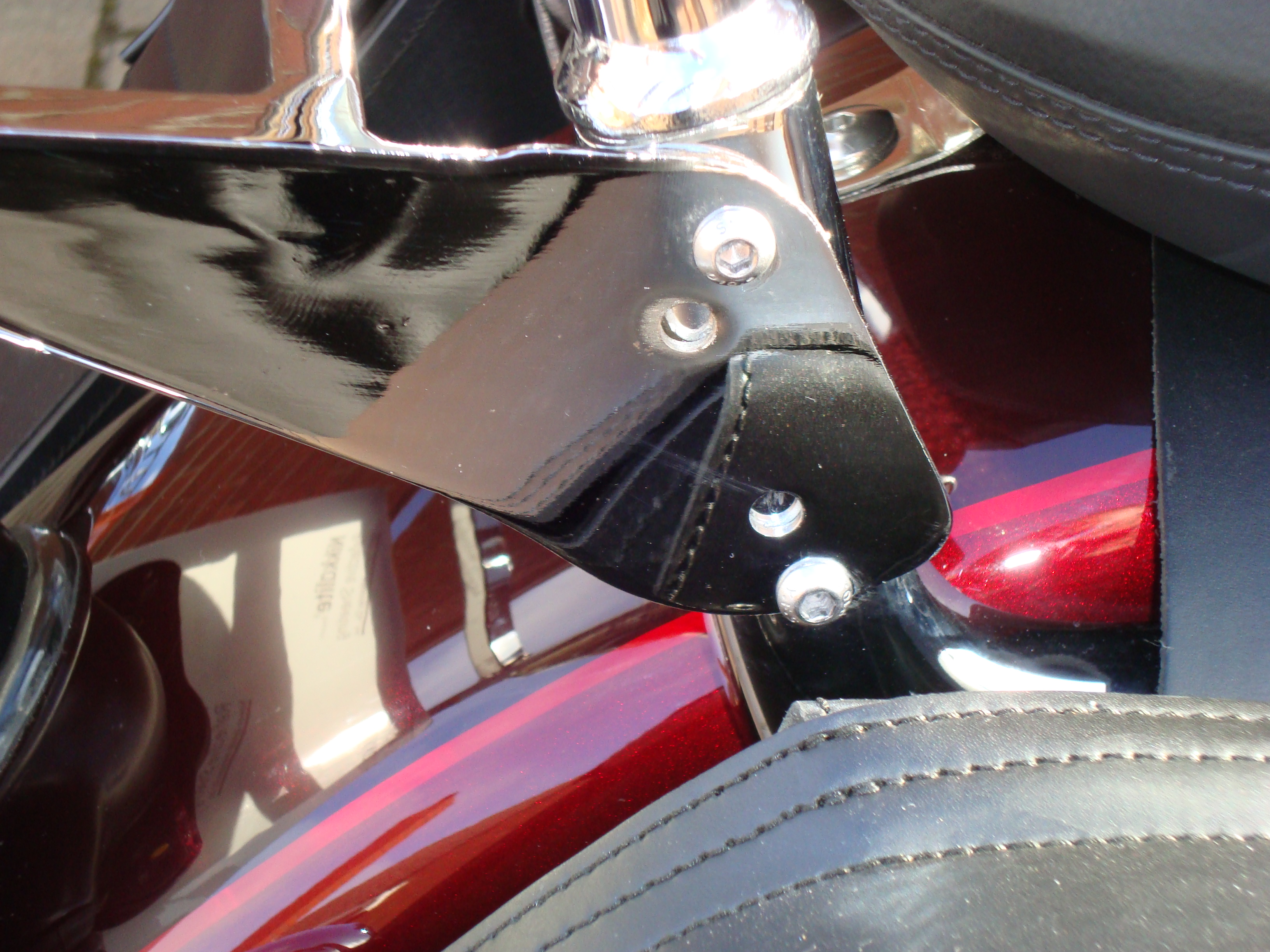

    OK FELLO TRIUMPH FORUM MEMBERS, THIS MAY BE OF INTEREST TO SOME !!!!, ( 2014 AMERICA )
    JUST BOUGHT THE BIKE BUT CAME WITHOUT A REAR RACK WHICH I NEED ----- SO I DID THIS
    FIRST LOOK HERE PLEASE - http://www.ebay.co.uk/itm/Fit-Yamah...981023?hash=item3388a70bdf:g:vnEAAOSw0HVWAkQb
    NOTE COST ME 13.50
    ONE HOUR LATER FOUR HOLES MEASURED AND DRILLED , FITTED TO OUTSIDE FLAT EDGE OF SISSY BAR
    RATHER THAN INSIDE AS IT SHOULD HAVE BEEN HAD YOU BOUGHT TRIUMPHS HIGH PRICE ORIGINAL !!!!
    NOT TO BOTHERED ABOUT ORIGINAL HOLES IN RACK SHOWING. BUT LATER I MAY MAKE AND POLISH
    UP A PIECE OF STAINLESS JUST TO COVER THEM UP.
    PS - NO EXCUSE FOR BEING A TIGHT ARSED GEORDIE, ITS IN THE D.N.A. LOL

    Nice job! …… and the price was right too! It's always satisfying making something that works and look good whilst doing the intended job saving cash in the process.

    Hi Tez, that is an excellent mod at my kind of price - very well done. It looks great !!

    Nothing wrong with a bargain Tez - always appreciated by a Yorkie!

    Nice One Tez. You must have been a mech eng in a previous life. I'm looking at making a thing to reposition the front indicators on my Speedmaster, (don't fancy paying Triumph prices for something I can knock up myself and I'm not a tight aR$ed Yorkie either, just a careful Lankie)
