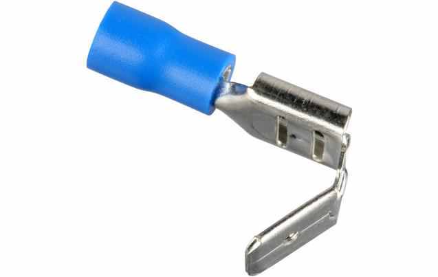

  7. crispey
    7,198
    You can get piggy back connectors which means no splicing or soldering! Then you connect to your horn. I put a post on here somewhere when I did it, plus someone else posted a link to another forum explaining it but I can’t find them. This is the connector
    Attach your satnav live to that connect it to your horn then connect the horn live to it. Get a ring connector and connect your earth wire to it and find a decent place to earth it, not the horn earth though!

  10. crispey
    7,198
    The pic isn't actual size DD! :rolleyes:
    They are small enough , I don't notice mine as it is hidden by a load of motorbike and admittedly not as neat as a solder, it isn't that large, there are different sizes and the one to use is fairly small and has the convenience of not being permanent so can be swapped between bikes.
  11. Sir Trev
    Sir Trev Senior Member
    May 27, 2017
    652
    Buckinghamshire
    This is exactly what I did. Piggyback spade crimped to one wire and a ring connector to the other for the earth. Route the cables alongside the existing loom so it looks neat and Robert is your father's brother (Bob's your uncle). The bike is tucked away under a cover in the garage for winter and it's cold outside so no piccies I'm afrid.

  13. steve lovatt
    9,211
    Used these years ago on many additional wiring jobs on old cars i once owned. Not that reliable though.
