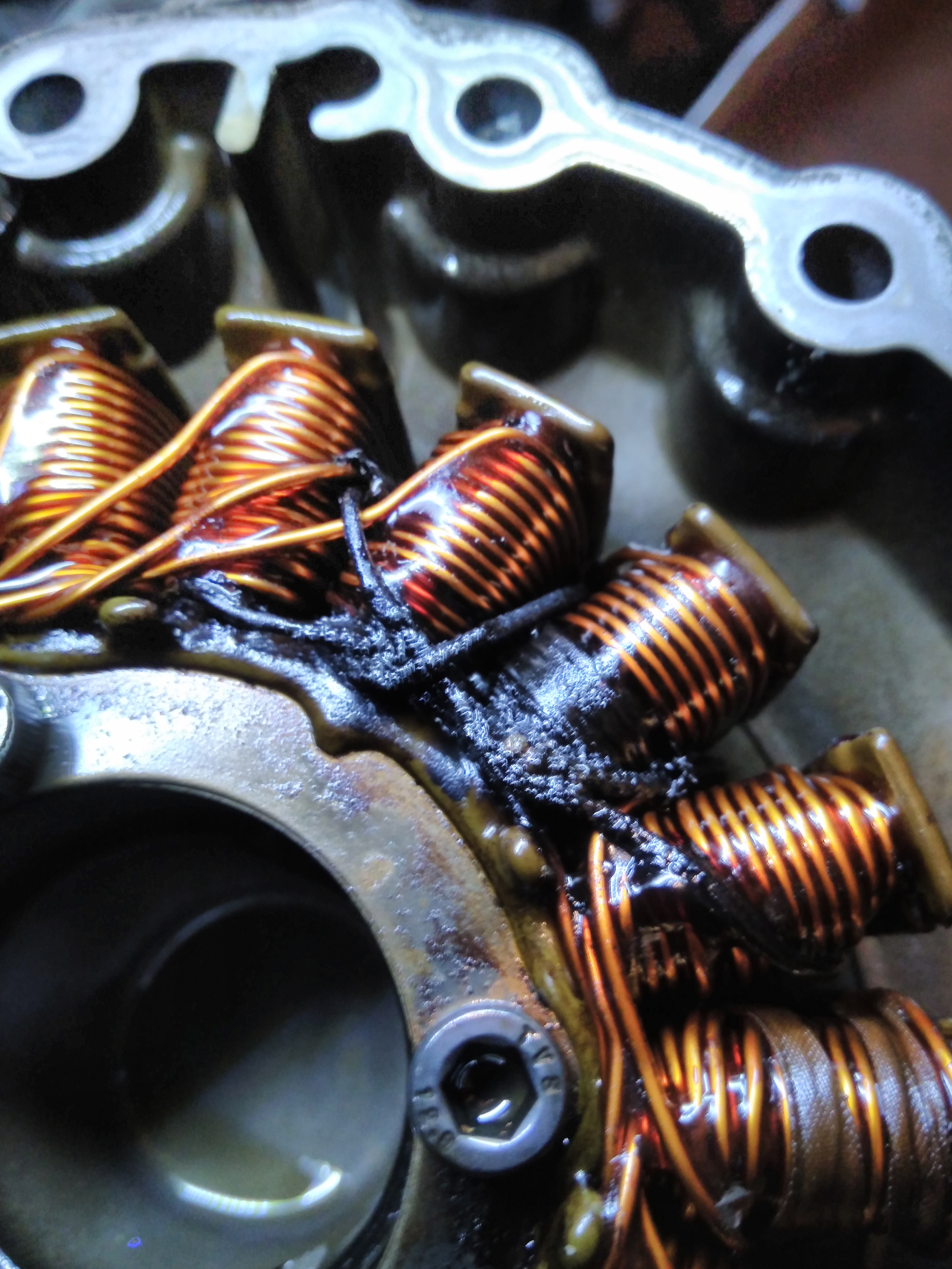

    Hi all,
    So a month into my 1050 and I'm suffering from the typical charging issues.
    It's an 07 tiger 1050 abs model.
    So I took a ride out 40 minutes later the ABS light comes on followed by the electrics dropping out then quickly after the engine.
    I've run a diode check on the RR and a spare I got with the bike and both are showing fine.
    I've run a resistance test on the stator again fine - all consistent. I also ran a ground check that came back fine.
    Tried and tested the system with two bsttbatte that have also been checked so it's not a battery issue either.
    Any ideas??
    Could it still be the stator even though all tests are coming back fine? Or are there other possibilities?
    Cheers
    Craig

    Enough damage to stop the stator working?
    Tests came back fine

    There maybe a break in continuity under that burnt coating, that fully opens when the engine is hot, but closes up when cool / cold , so you don't get any charging happening when you are using the most power (12v electrically) if your machine is electronic ignition and fuel injected your battery won't run the bike for long..

    That's a great photo to add to your post. It certainly makes me believe that you've identified the source of your problem. A thermal issue like the Capt. has suggested is probably a good starting point. It's a shame that Triumph's prices are so high on the rotor and stator. Maybe you can find an electric motor shop (alternator repairs) that could look at this to confirm the problem and possibly repair it. I also see some used and new stators on eBay that are available for reasonable prices.

    Cheers Capt, I hadn't thought about the state of it changing as the engine warmed!
    All of the tests I did were ''cold" engine off style checks.

    Winner - as suggested the stator which was showing up fine on a cold tests was indeed shot.
    Replaced the stator and RR while the bikes was in pieces. Fitted an aftermarker voltmeter to the dash too so I can monitor charging whilst riding.
    Been commuting on it for two weeks now without a single issue.
    Good to know even with all those checks that you can run...you should still trust your intuition over tools.

    You problem sounds just like mine, I had none of the tests comeback negative...so I bit the bullet and opened the stator anyway and sure enough a burnt out element.
    My conclusion was that as the stator warmed up it opened up a split in the stator.
