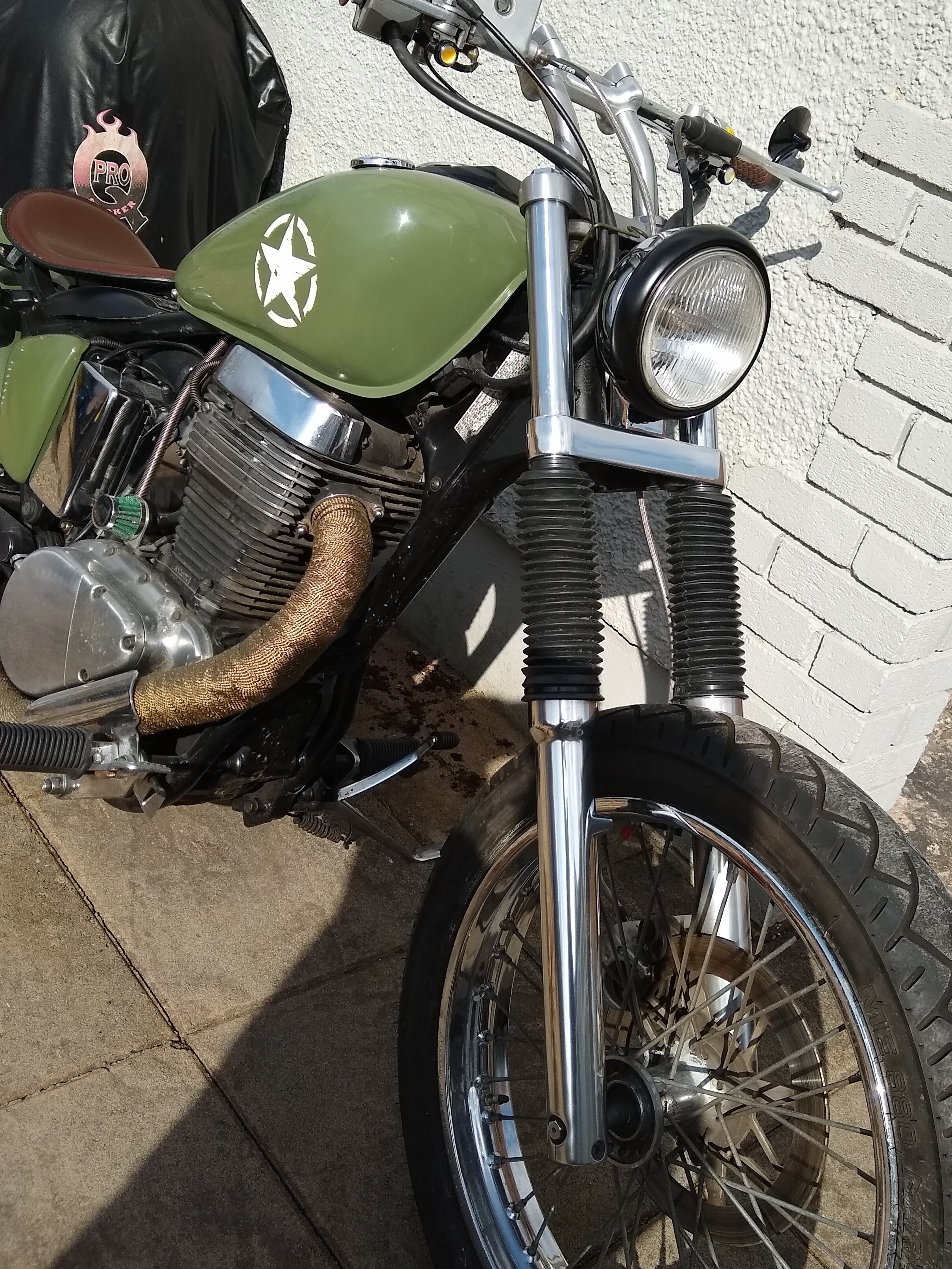

  8. Camperman
    Camperman Senior Member
    Mar 23, 2019
    220
    283
    Wales
    These were originally black, cleaned them up using various grades of wet and dry paper, 400 to 2000 grit. Finished off with good old Solvol. IMG_20200403_155251773 (2).jpg

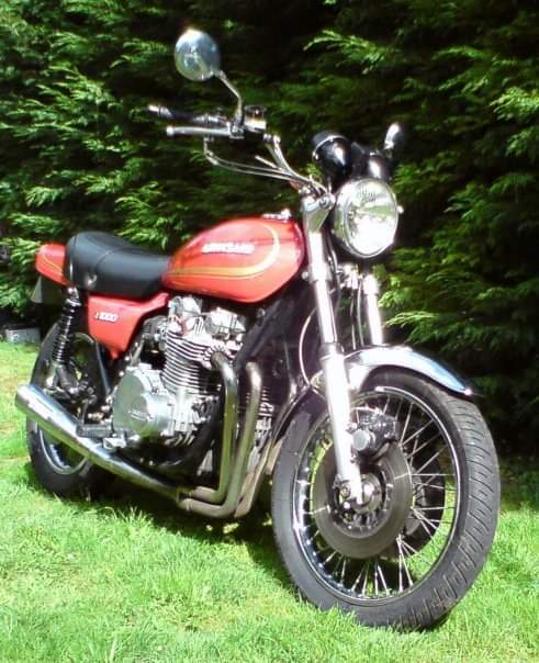

  9. ChasChas
    ChasChas Marxist Scum
    Aug 9, 2020
    518
    I used a lot of solvol on this
