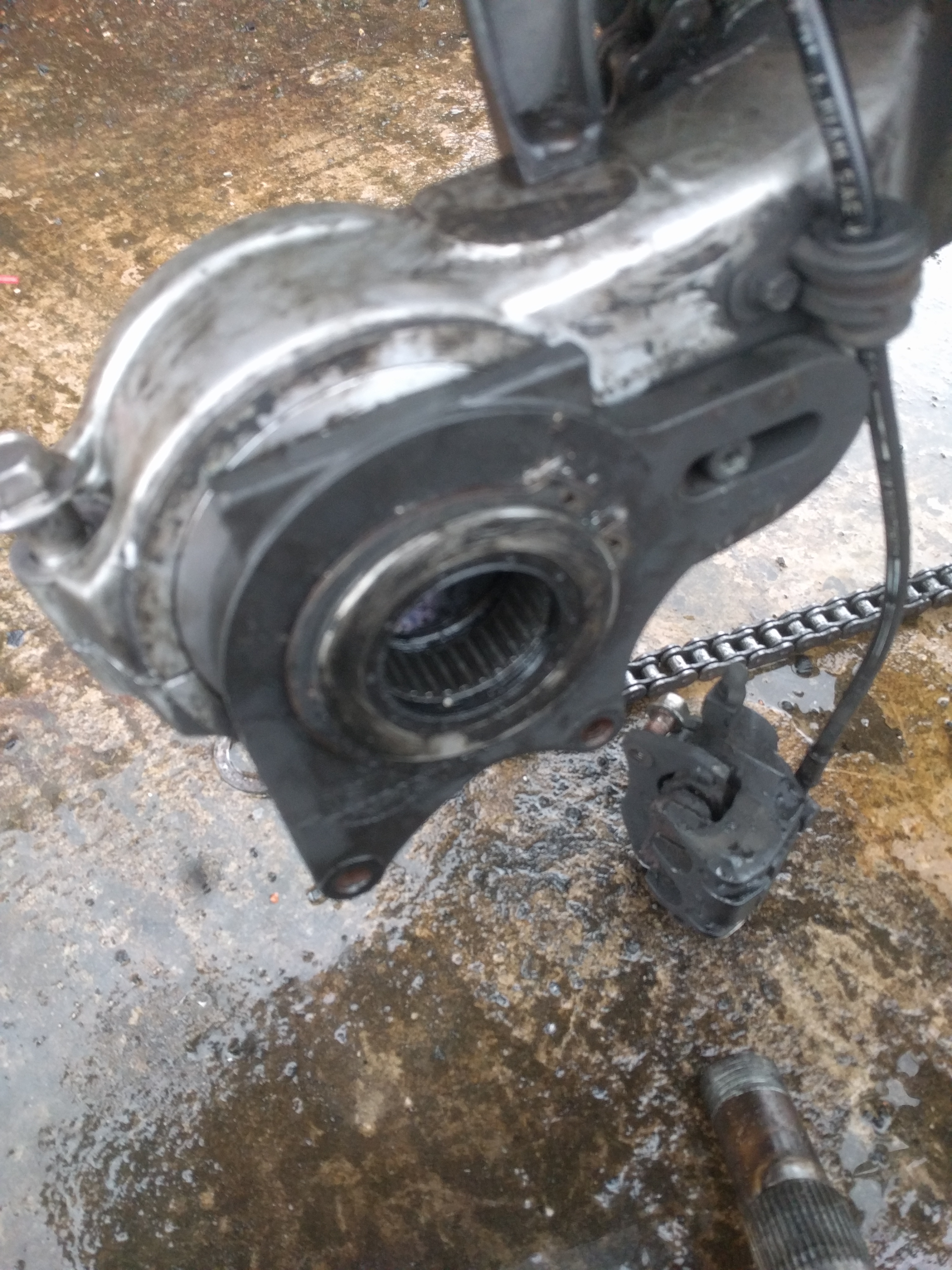

    Looks like the buggers seized at the brake callipers holder (see pics) any idea how to get it off / unsure it please
    Sorry fir all the questions I'm really struggling

    This is where brute force, a mallet and a few choice words gets the job done. Check the Allen bolt that stops it spinning is tight. They have a habit of coming loose

    Allan bolt is rock tight. But looks like there's a lip that will stop the bracket sliding off. I've looked for a exploded diagram to check in right but can't find one

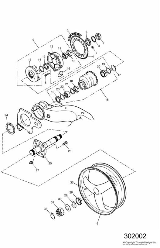

    Here's a parts fiche that may help.

    Yer thats great thanks. Looks like the calliper holding bracket is the only thing on that side i will dig out my Rubber mallet and teach my dog some new words lol thanks

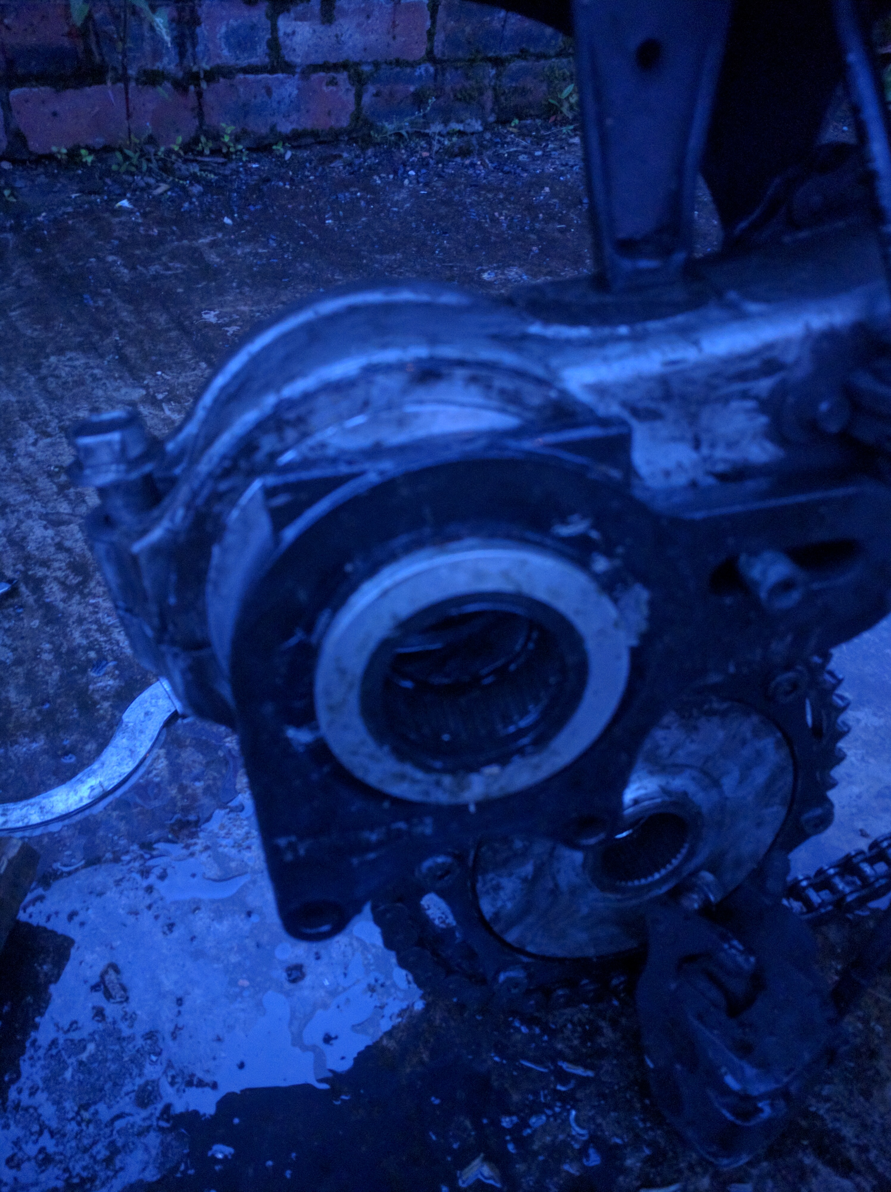

    Lots (nearly a full can) of Wd40 and a hammer and I still can't bash the break calliper holder off. Has anyone got any words of wisdom that might help.
    Can I also check that the calliper bracket( black bit in picture is definitely meant to slide off please

    Yes slides off. try a bit of heat to expand it. maybe take out the allen bolt so it can rotate to loosen it

    And.............it's off many thanks for all your help
