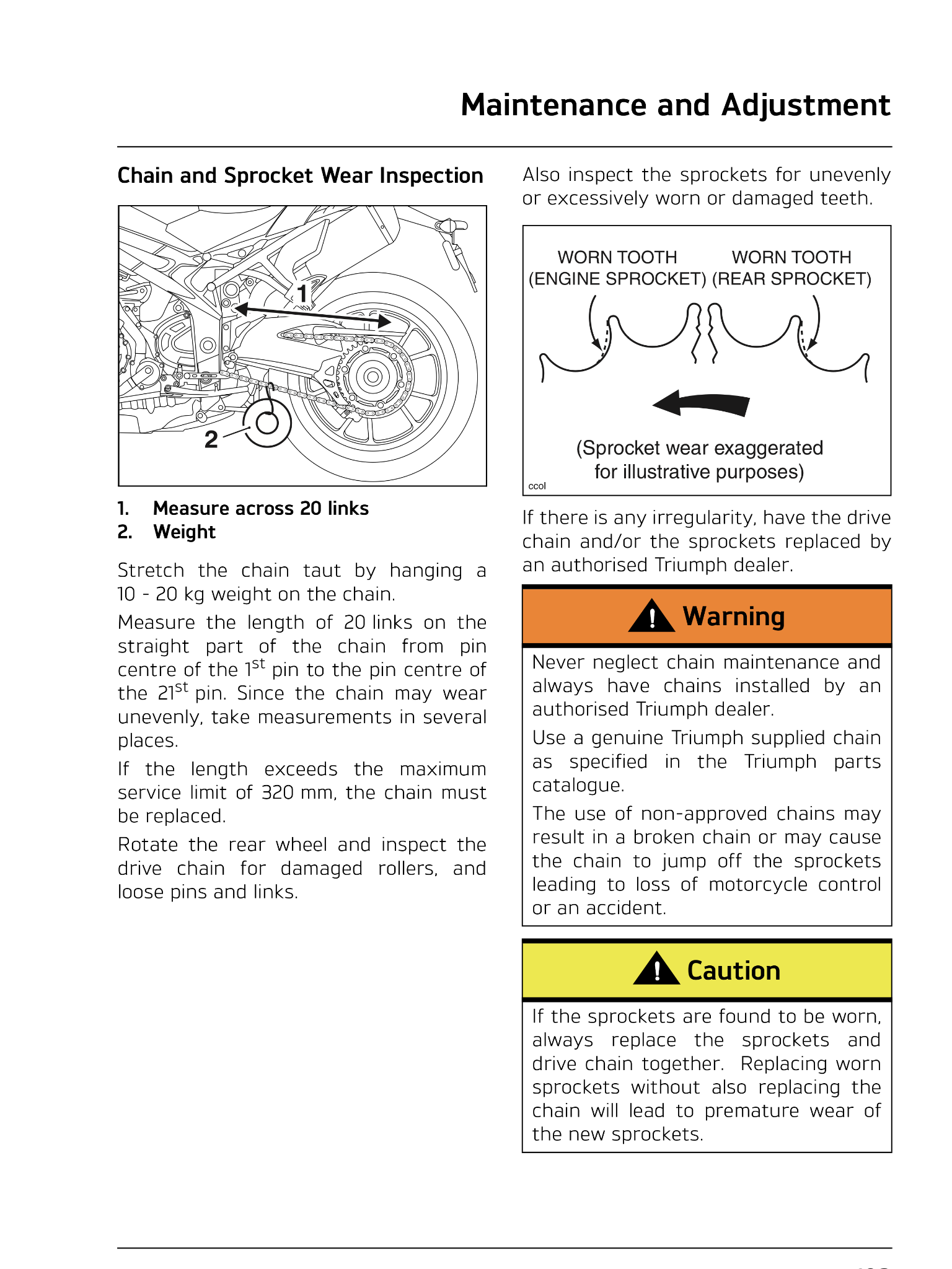

    Have you looked in your Owners Handbook? If you've don't have a copy you can download one. Under the section 'Chain and Sprocket Wear Inspection' it includes measuring length of links to detect wear.

    I agree. The OM shows you exactly how to check for chain/sprocket wear.
