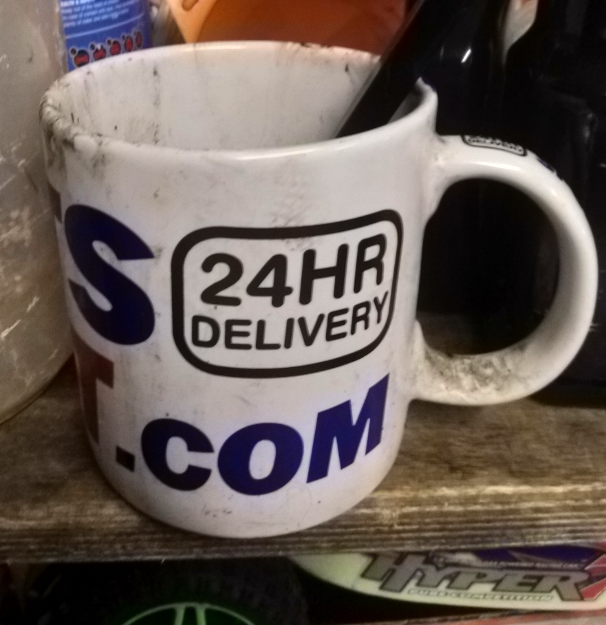

    Kerosene and a paintbrush to clean (heating oil), then I keep a pint mug full of oil, that's left over from everything, 10w40, gearbox, chainsaw oil is good, and any bits left over when oil changes. Cost £0.00. Paint that all over, go for a brew, come back and wipe down.
    After a full day out, will paint chain and wipe down. Hot chain retains oil in better.
    Never replaced a chain or sprocket on a road bike. My record is 24k on my SV, and it still looked like new. :cool:
    Was getting low, just chucked some ep90 in
  12. Sprinter
    That cup is filthy.
