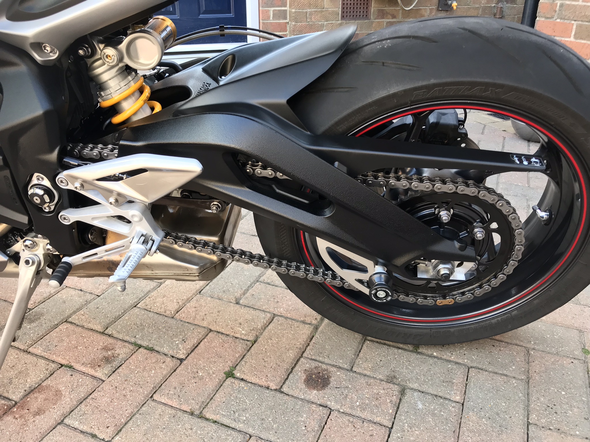

  8. Shaun64
    Shaun64 Senior Member
    Feb 23, 2020
    429
    653
    England
    I use gearbox oil on my chains and expect 20.000 miles out of them, I never have to clean my chains I just wipe them down after every ride, brush on oil , wipe excess off , the chain in the pic has only done 8000 miles and has just been oiled and wiped.
