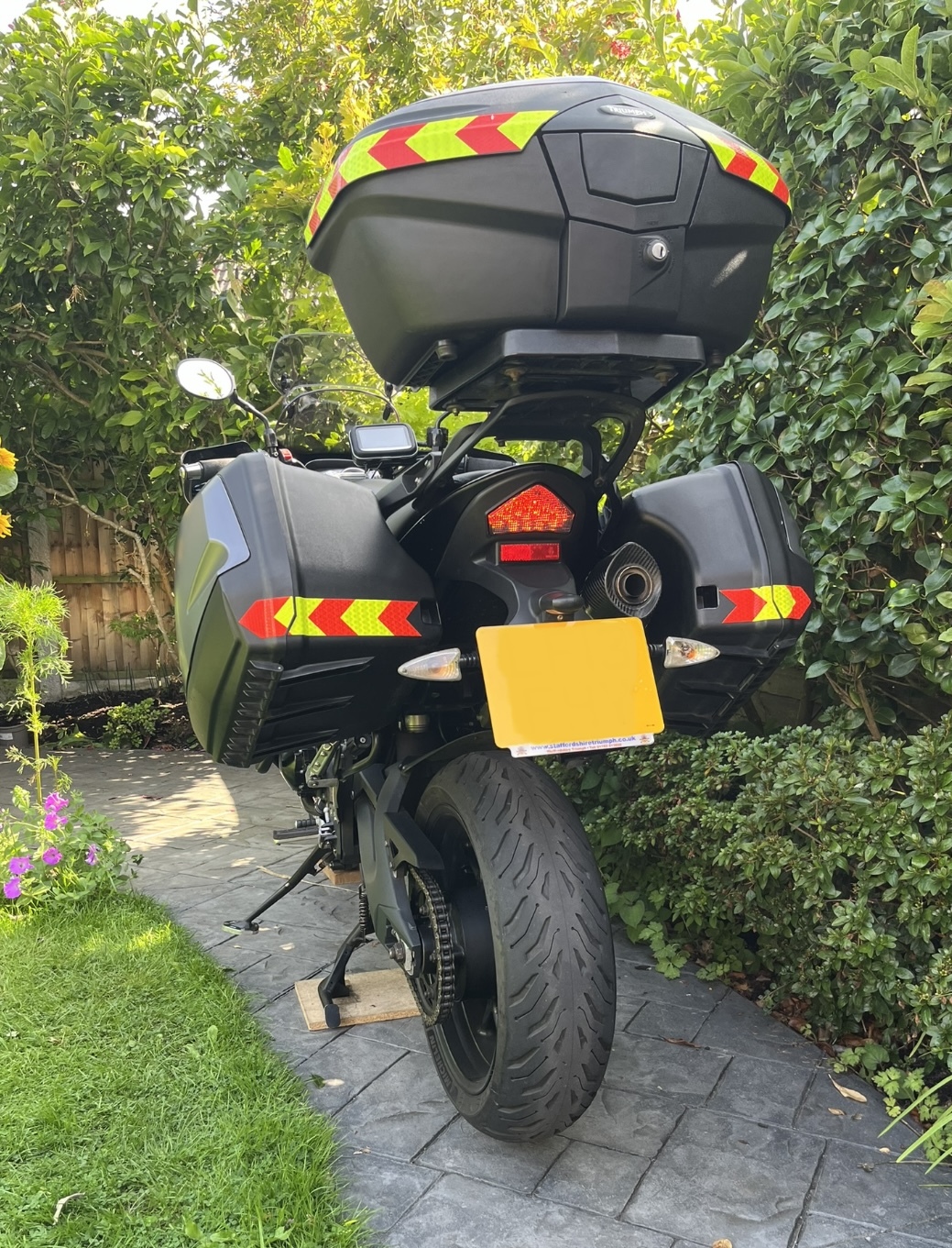

    God knows why its copied the photo of my bike in but for whatever reason i cant delete the image through the edit function :confused:
