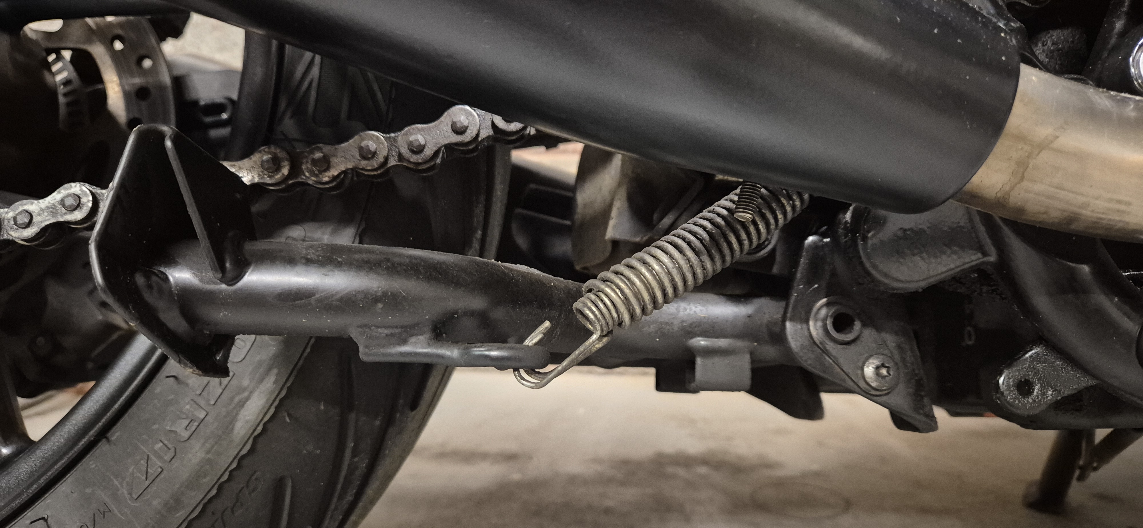

  6. Eldon
    Eldon Crème de la Crème
    9,340
    The installation is so easy it is unreal, I removed mine to correct the crash damage and repowdercoat.
    One bolt holds a cross pin.
    Lay on the floor and easy fix.
    To put the spring on, use a loop of string, n jobs a good un ;)
  7. Eldon
    9,340
    Here you go....
    Chain looks Shi7e so ignore that as it's well lubed, but as inherited.
  8. Eldon
    9,340
    #8 Eldon, May 2, 2025
    Torx 30 ;)
