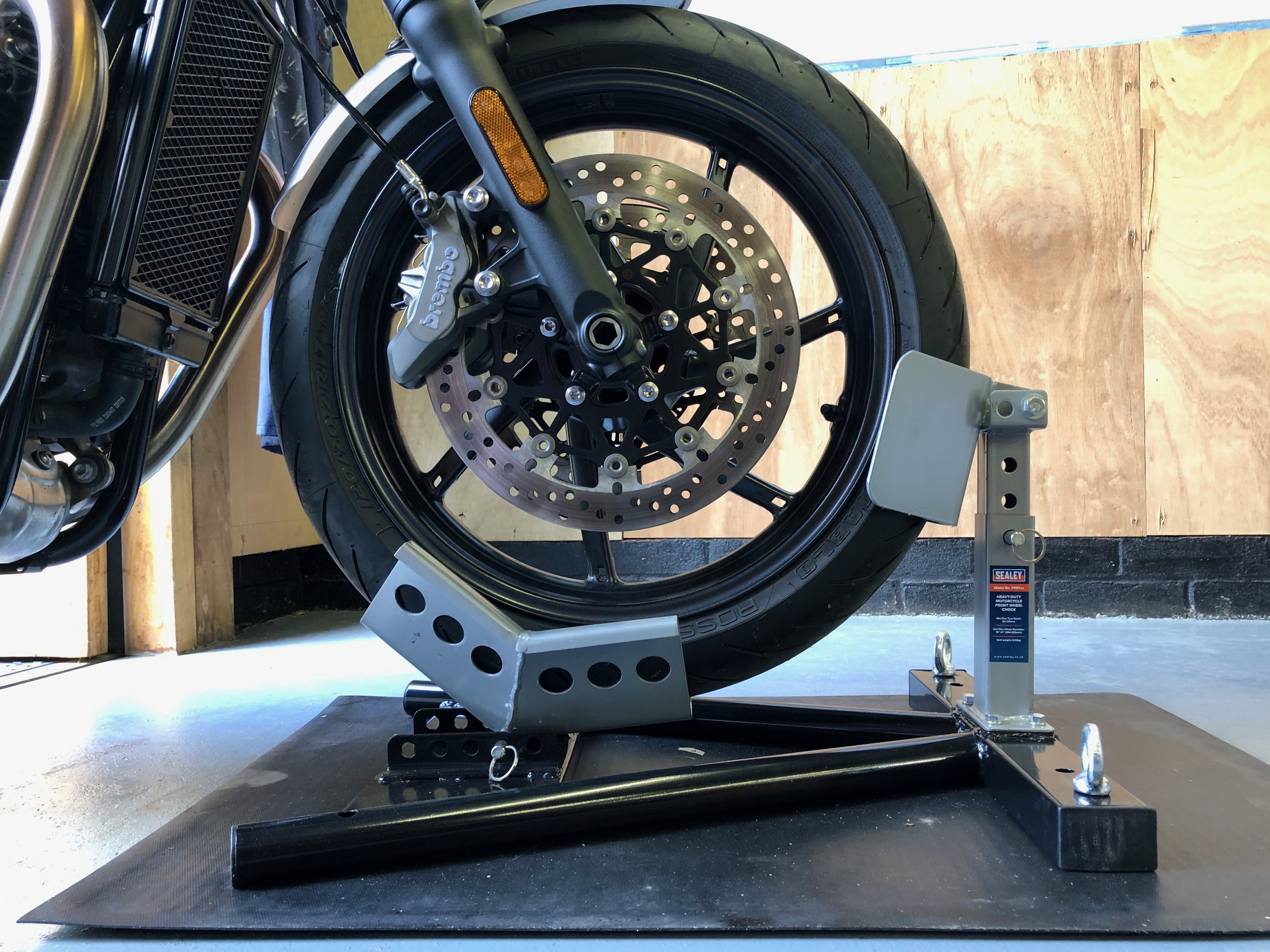

  12. SpeedTwin1200
    SpeedTwin1200 Senior Member
    Jul 21, 2019
    261
    Hampshire
    Here's the Sealey chock. I flipped the door mat over to give it some grip and stop the stand skidding across the floor. Works ok. I tried a couple of holes before this set up and I think I could move the rocking bit another hole back maybe. It isn't very wide and it is designed to be bolted down to a floor, like a trailer or van floor, as I may well do. I might bolt it to a thick sheet of ply for use inside and outside the garage so it's a bit more stable.

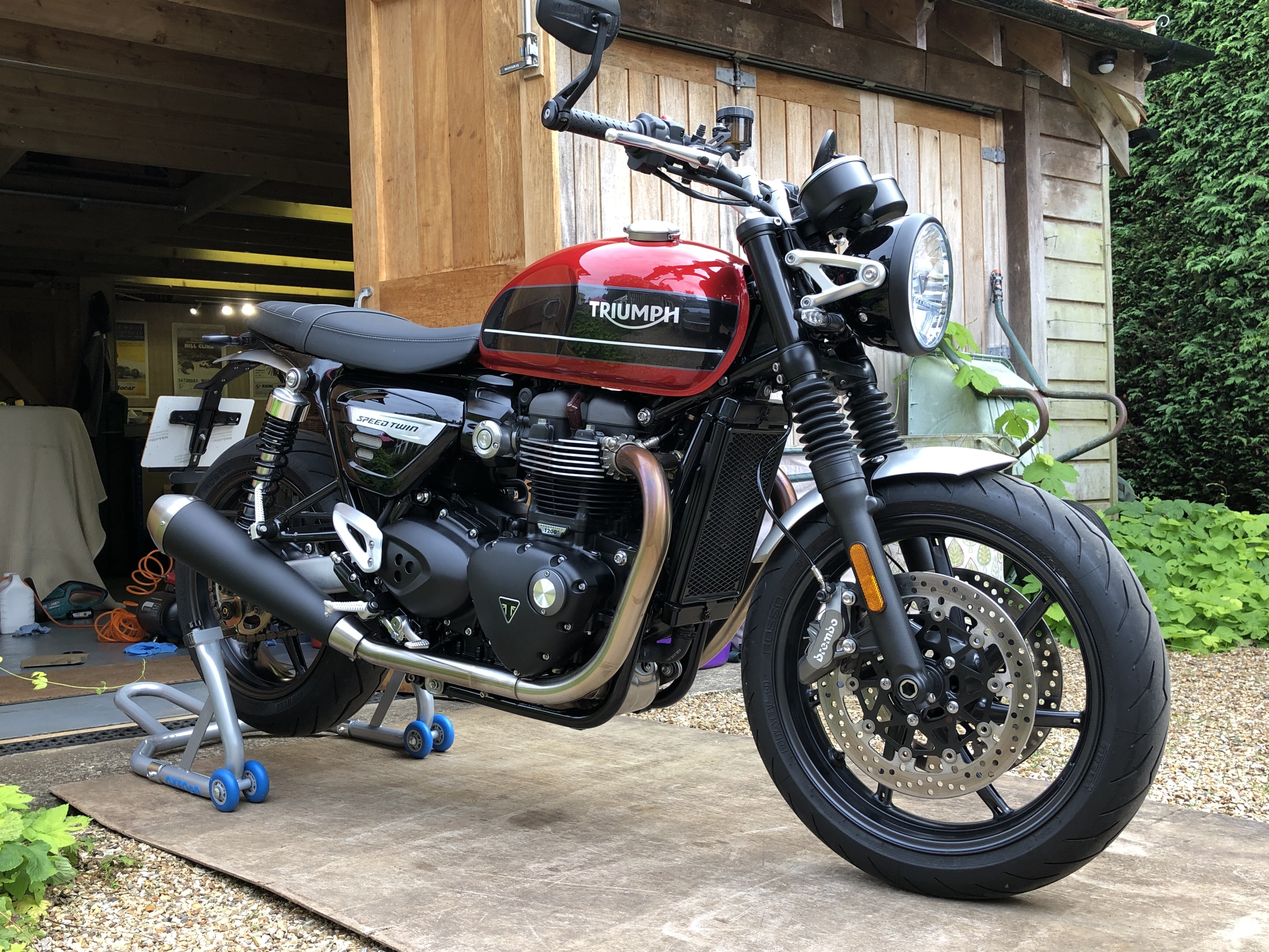

  13. SpeedTwin1200
    Jul 21, 2019
    261
    Hampshire
    And here's the bike up on the Oxford stand. Works well and do it on my own.

  16. SpeedTwin1200
    Jul 21, 2019
    261
    Hampshire
    Not yet actually Adrian. Keeping the bike balanced while I get the rear stand sorted was a bit of a worry with a brand new bike but I've got the hang of it now.
    If anyone has some advice on the front chock I'd be grateful. I think one more hole back towards the bike would get the wheel to drop a bit deeper into the stand......and be a bit harder to pull back out.
  17. Bryf
    Bryf Guest
    #17 Bryf, Jul 29, 2019
    I have heard that using wheel chocks long term can cause problems with the forks, seals going causing leaks and even distortion of the forks themselves, there are forces generated when the wheel hits the stop, apparently it also causes unnatural pressures on the actual forks whilst just sitting in it which is further increased when used in conjunction with a rear stand as this tends push the bike forward slightly increasing this pressure?? why don't you consider a simple front stand which is designed to be used in conjunction with the rear and which also allows you to be able to spin the front wheel which is handy when cleaning the bike etc also if you put the bike off the road for any reason, over winter storage etc, it keeps both tyres off the floor which stops them distorting as well. The chock is brilliant if you need to move the bike within a van etc but other than that I would choose simple paddock stands for general use.
  18. SpeedTwin1200
    Jul 21, 2019
    261
    Hampshire
    That's interesting Bryf. As you say, long term, the forks will be compressed a bit while in a front chock as the wheel is effectively off the ground a bit and if you then lift the rear it sort of pulls the two wheels apart a bit until the rear stand is fully under the rear.
    I was going to get the matching Oxford front stand for cleaning and work on the front etc and as you suggest, maybe over-winter storage.
    Although I have now seen the stands made by Harris Performance which I rather like the look of so my Oxford stand might be on ebay soon.
    https://www.harris-performance.com/...fork-universal-stainless-steel-paddock-stand/
    If I can get the front wheel to drop deeper into the chock so the bike is level and upright (and/or put a bit of wood under the rear tyre to compensate), it would be a good way to be able to check oil and coolant levels.
