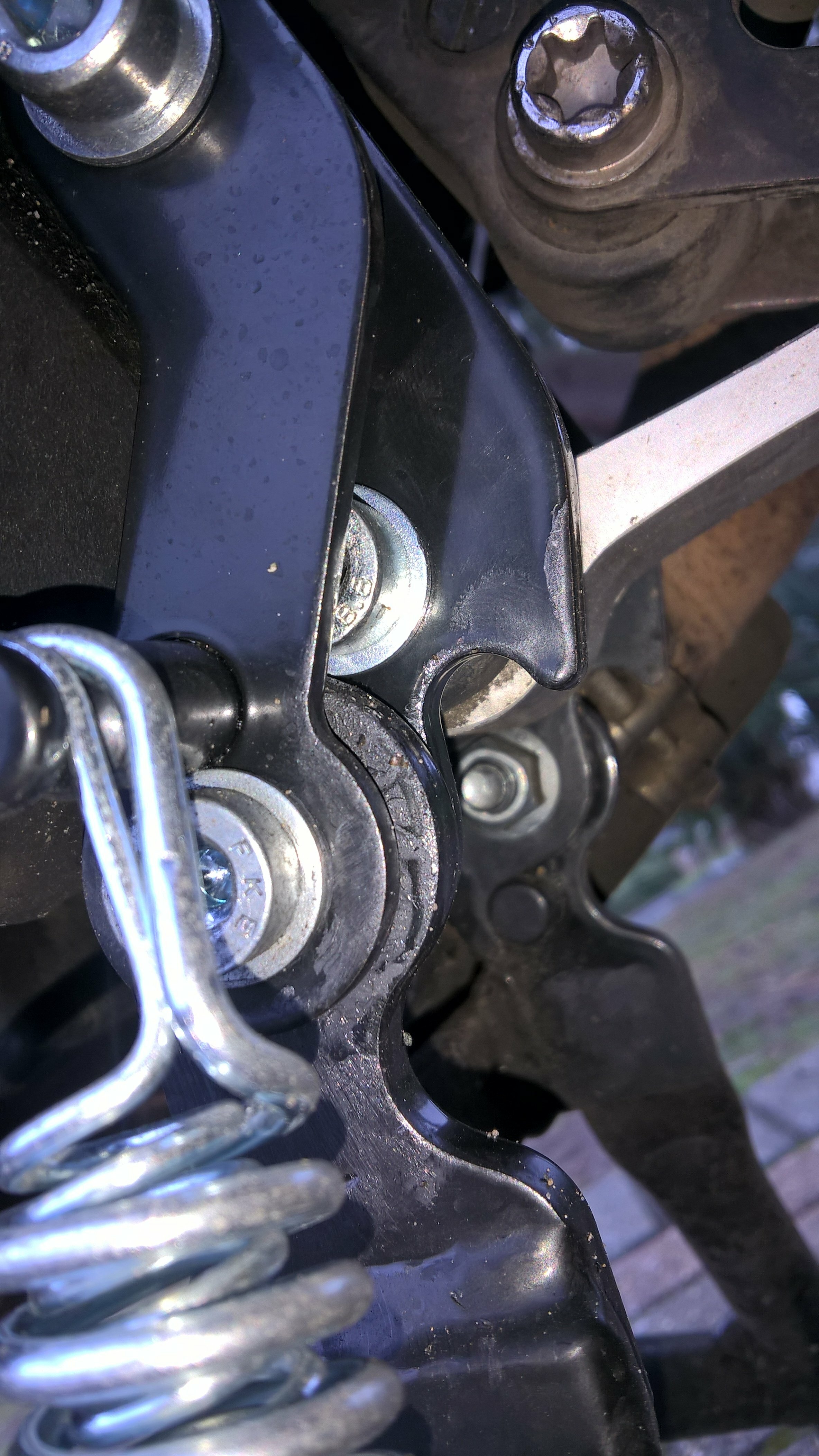

    Fed up with the limitations of only having a prop stand l went for the motech kit.
    To fit this the bike has to be supported with the suspension unloaded, this stage is important as you do not want the bike falling over while you are underneath..
    It could get damaged!
    I removed the rider footrest pins, turned them over,refitted pins and then lifted bike onto a couple of axle stands.
    Fitting is a bit fiddley but provided the instructions ate followed EXACTLY all will be well.

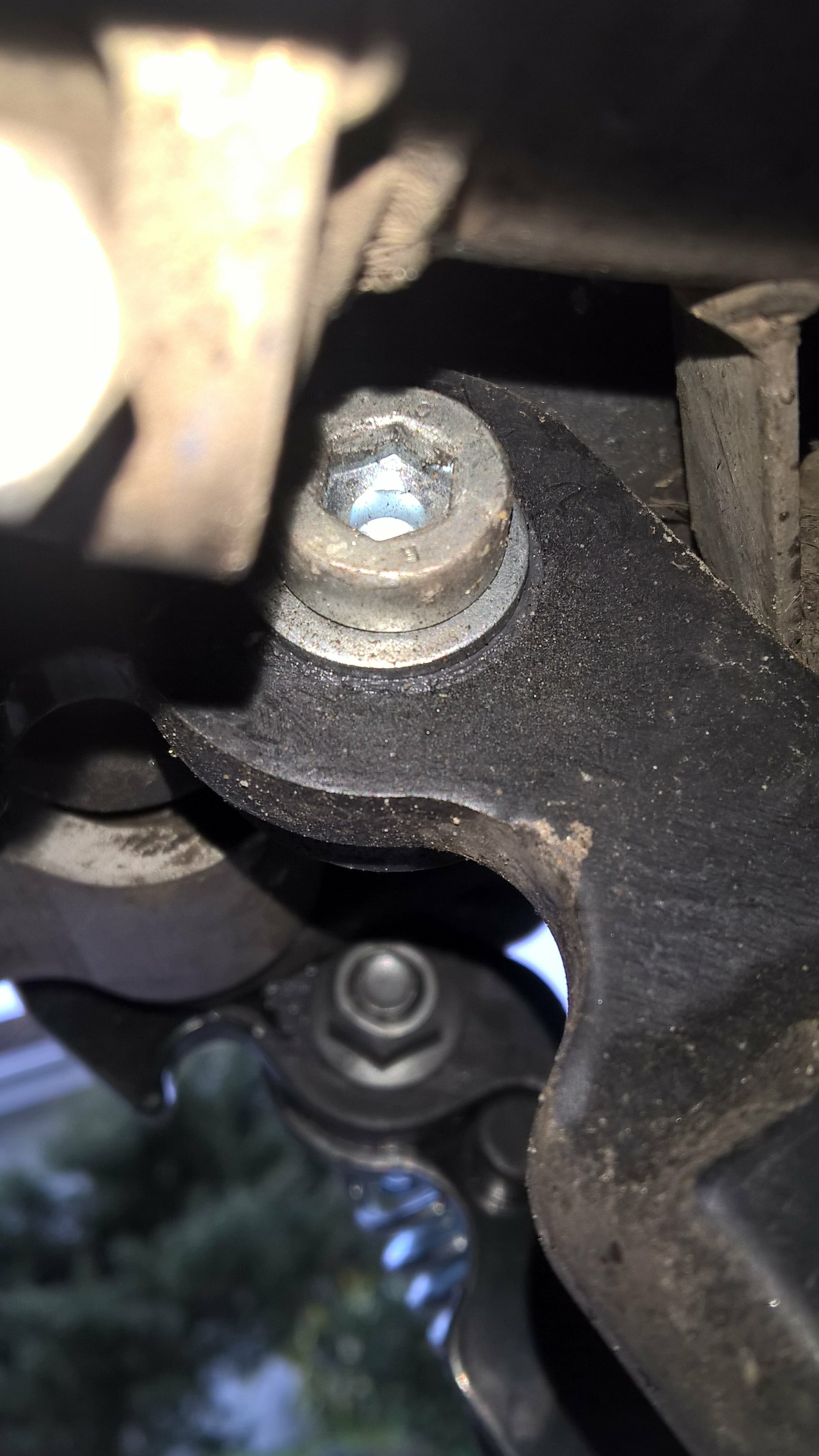

    Tip: When removing the lower engine mount bolt slacken the nut first, it is easier than trying to loosen it from the other (torx) end.

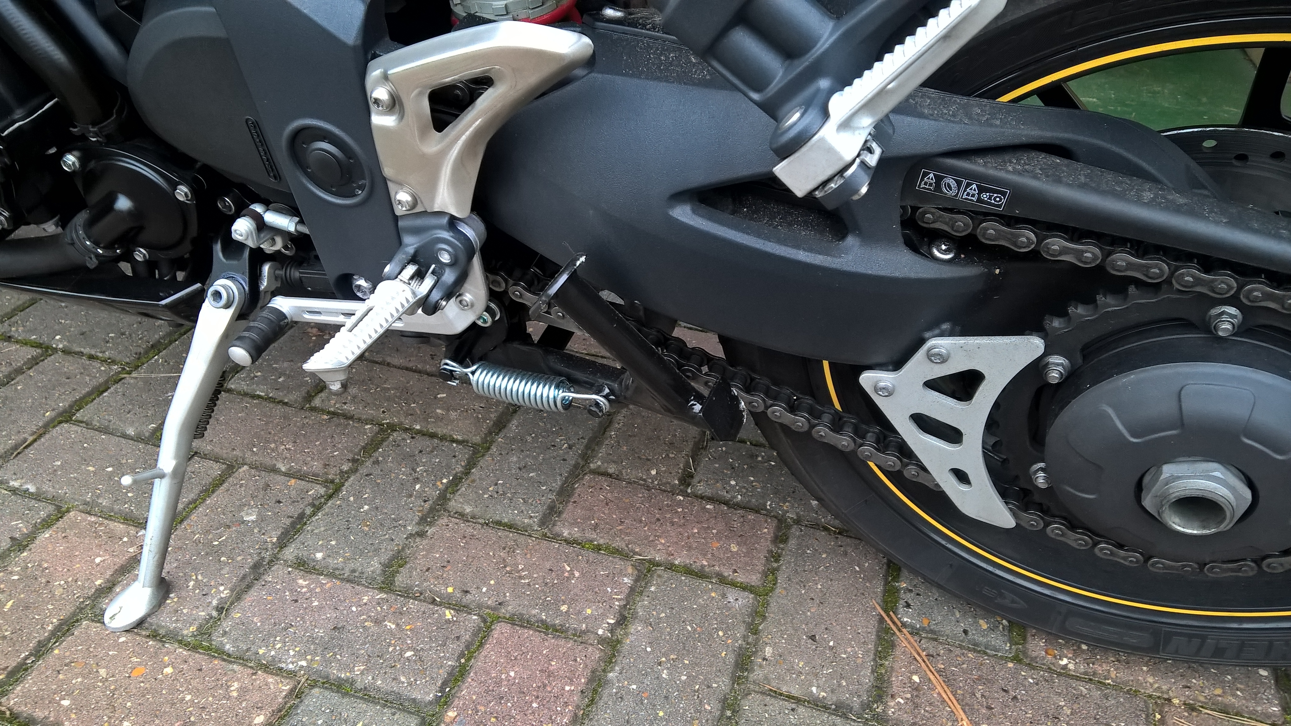

    Fitting the spring is easy using a steel rod about 10 mm diameter wit a slot ground onto the end, a special tool is available for this by I made one easily.
    Now I can remove either wheel with ease and adjust / replace the chain, even cleaning the bike is easier .
    Incase you were wondering, there is no chance of grounding the stand on corners,it is well tucked up out of the way.
    In my opinion this is the best single mod anyone could do on a speedy.

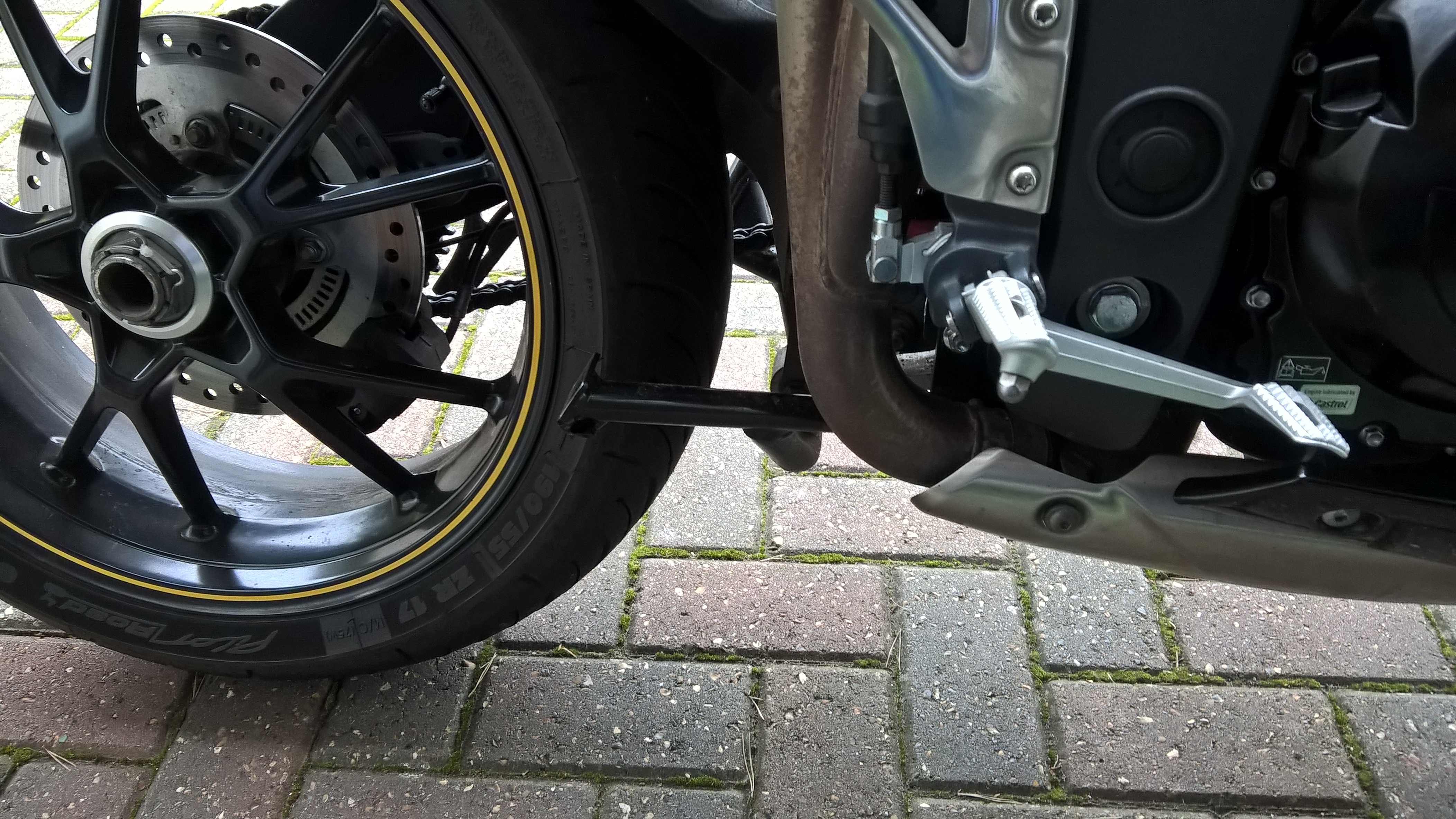

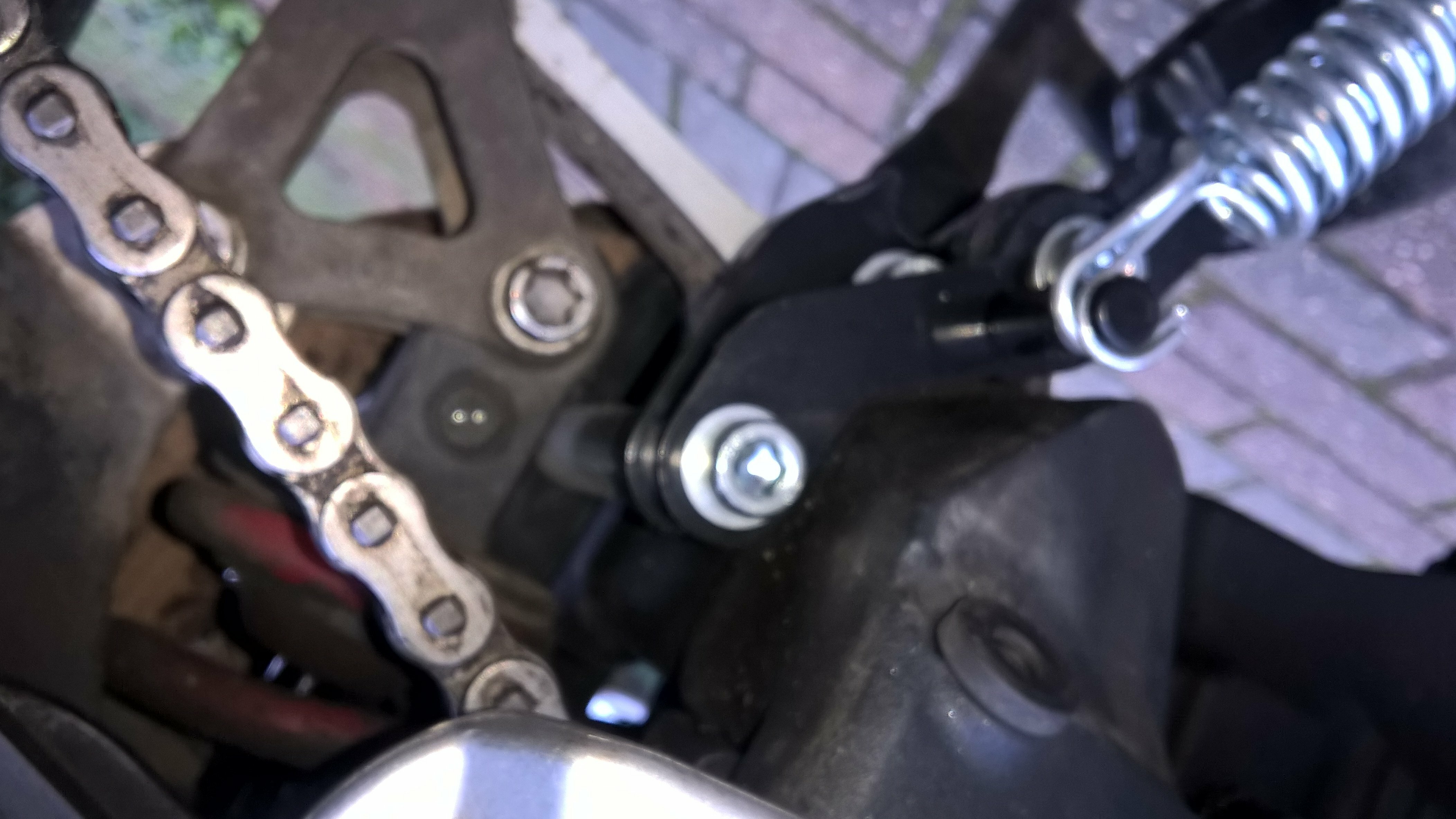

    Hi dozer,
    No, it's well clear of the arm....the pics are not very clear, what you are seeing is the foot peg part of the stand and the paint has rubbed where I stick my size 13 boot on it!

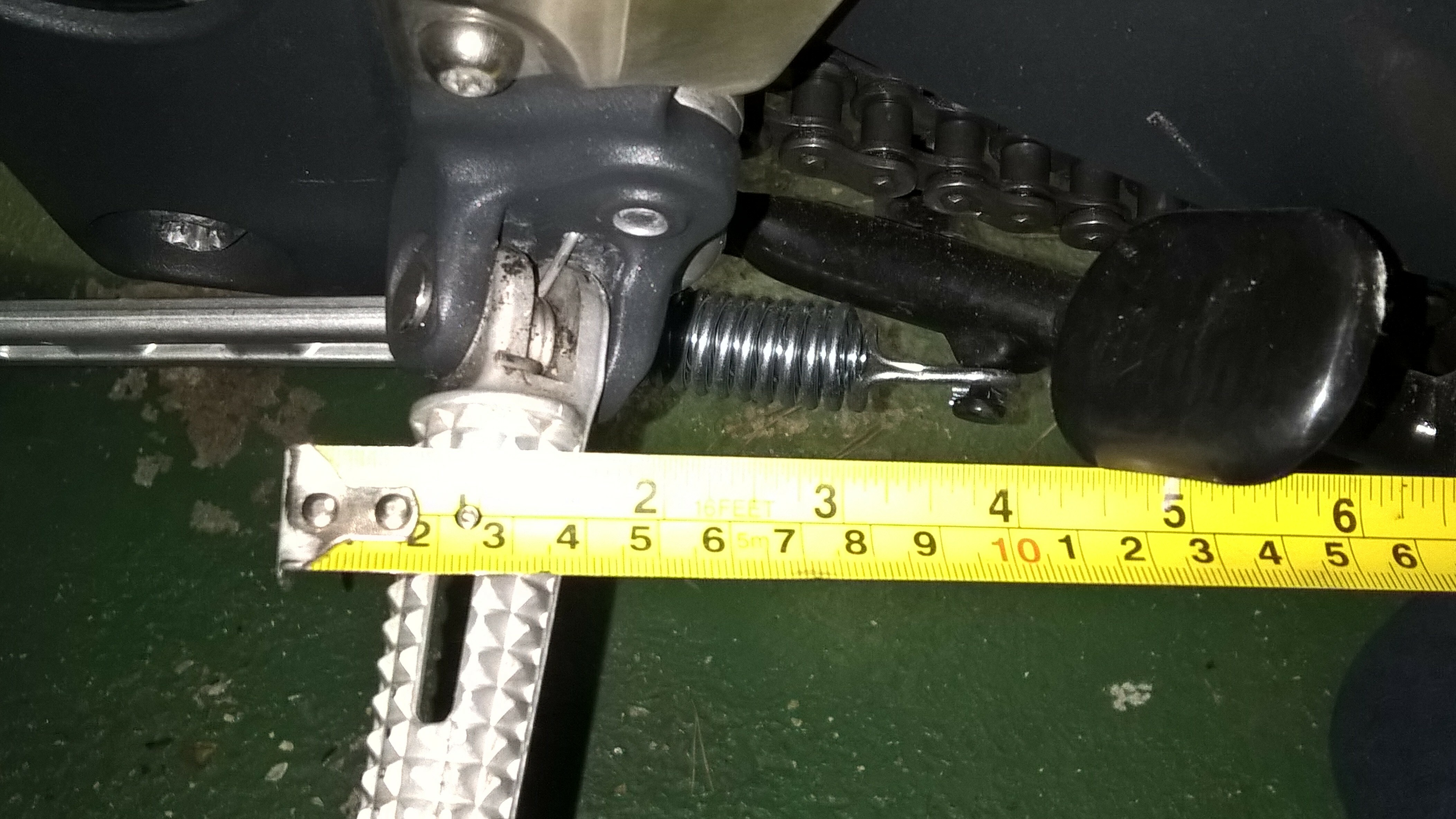

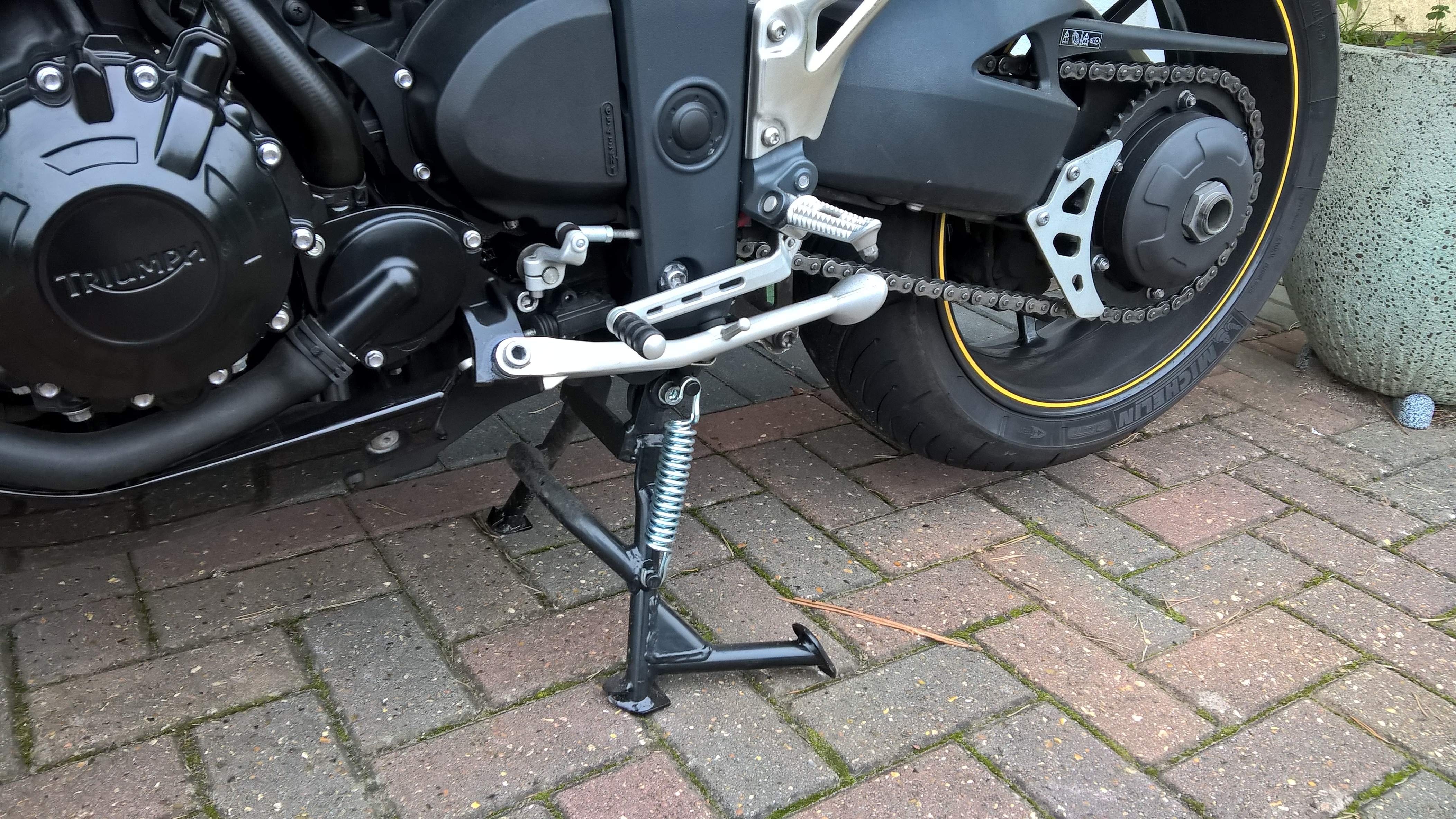

    Hi Speeder, would certainly make chain oiling easier when away touring and looks a well made piece of kit. Can you measure the distance between foot peg and the stand foot plate (when up), still not sure if it will leave space for my size 10's with ball of foot on the peg.

    Hi,
    I doubt you would have a problem, l am size 13 and my heels do not touch the stand, it is slightly inboard of the rider footpeg.
    I have attached a picture.

    Thanks for that Speeder, it must sit inboard of your boot as I need about 8" ball to heel for clearance.

    No problem, in practice your heel is seldom level with the peg, usually it is slightly higher I.e. your toes point slightly downward so I don't think you will actually be touching the stand.

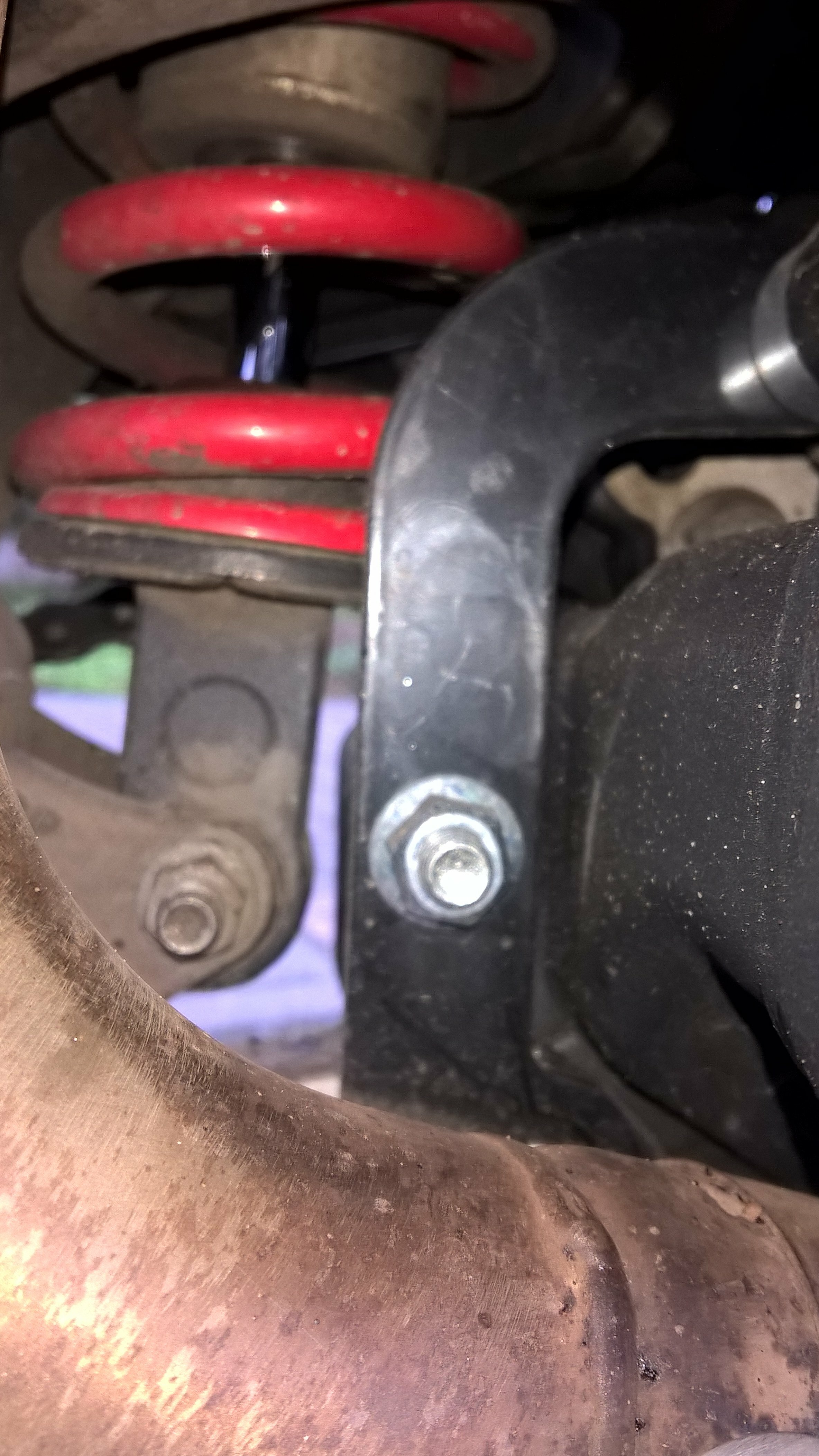

    would like to see a few pics of where its mounted to engine casings

    Difficult to get a decent shot under there, the stand pivots on plates bolted to the lower engine mount and fixed suspension point.
    Quality and design are good, completely rigid and no flex whatsoever.
    When you see the amount of hardware that comes with the kit it is easy to see why they are a little expensive.
