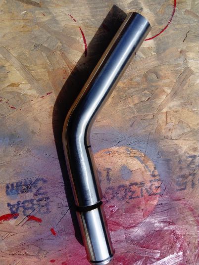

    OK so two elbows arrived today
    https://www.ebay.co.uk/itm/202755388839 (22.92) It apears that these now have a raised edge each end so item can be used on silicone hoses too, this raised section needs cutting off one end the other end needs shortened by 75/80 mm. (which has changed slightly from info I used some years ago because of the pipe changes)
    [​IMG] [​IMG]

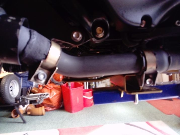

    So both painted in UHT paint and hanging in my scenic painting booth:rolleyes:
    The pipes need fitting long side(with just the raised area at end removed) to the header's and 75/80mm shortened end to exhaust section, place pipe in exhaust first and offer up placing other end to headers place rear bolt in exhaust to hold in place, refit clamps,
    Once happy refit exhaust covers quick wipe and continue on to other side.
    Taken down from lift started without any throttle and left to run for 12mins plus, Sound is much much better deeper, any other ride performance differences will have to wait for now.
    So no platt cat removal pipe or X pipe just two elbows costing 22.90 a good cheap Geordie fix that works well. :D:D:D:D
    [​IMG] [​IMG] [​IMG]
