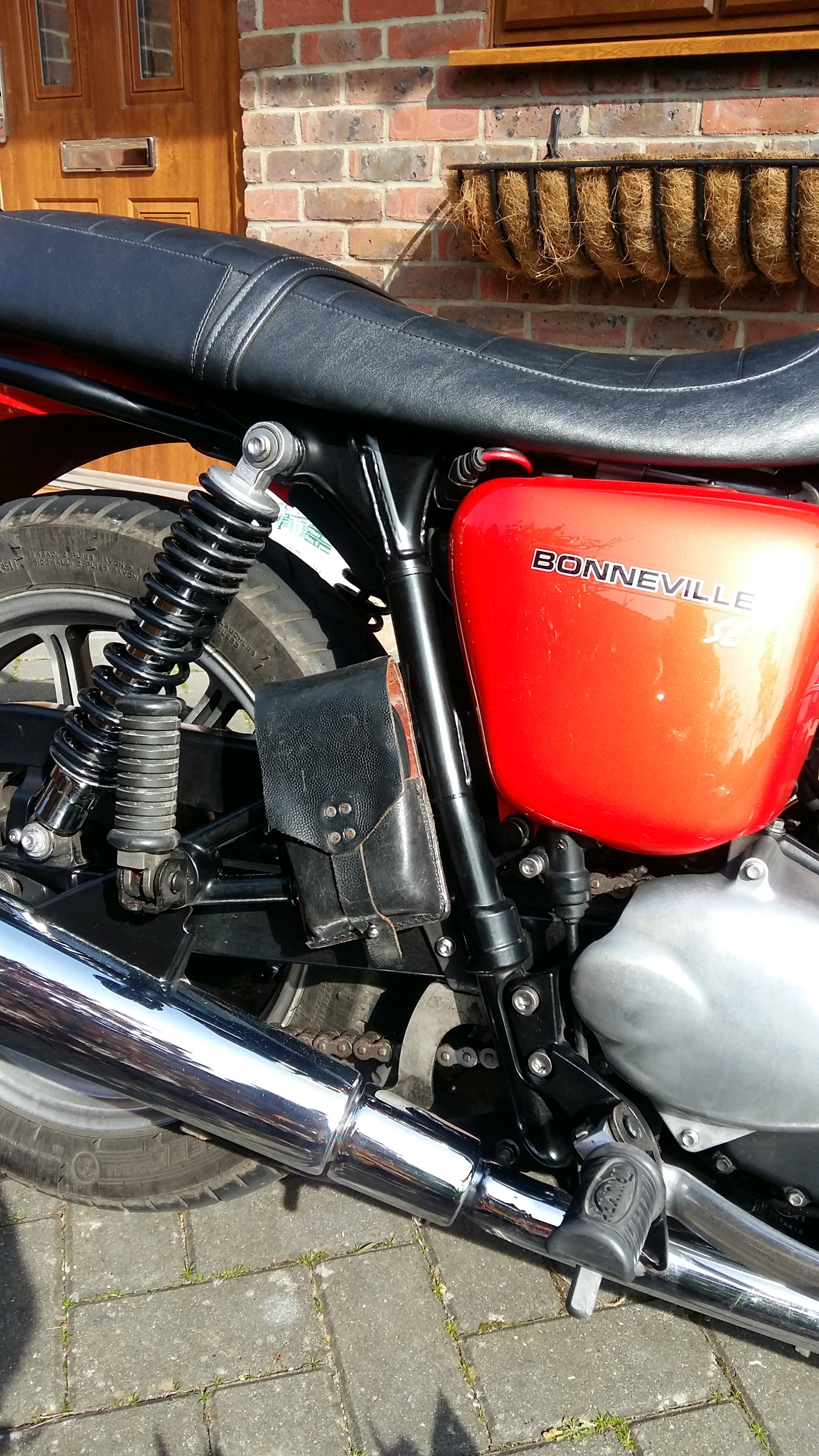

    I always carry a disc lock under the seat of the Tiger as a minimum security measure (I carry a chain and padlock if I'm leaving the bike longer). Can't really fit one under the seat of the Bonnie so I adapted a leather ammo pouch to carry one - I have one on each side now so also room for a tool kit or sunglasses etc.
    Still available on ebay for £6.99 - http://www.ebay.co.uk/itm/181808779494

    Great idea that Steve, I have just ordered a set for my Bonnie.
    What have you used to secure them, tie wraps ?

    Yes Mick, originally I just fastened the two on one side of the bike with cable ties but was not happy with the fit. To separate one from the other you need to remove the metal plate on the back with the D-ring by drilling out the four rivets and then cut carefully with a Stanley knife avoiding the stitching!
    I then drilled out the bottom two rivets on the belt loop on each pouch and used that to attach it to the bike frame by looping a steel cable tie through the holes and back so the pouch is actually secured to the bike by the belt loop.
