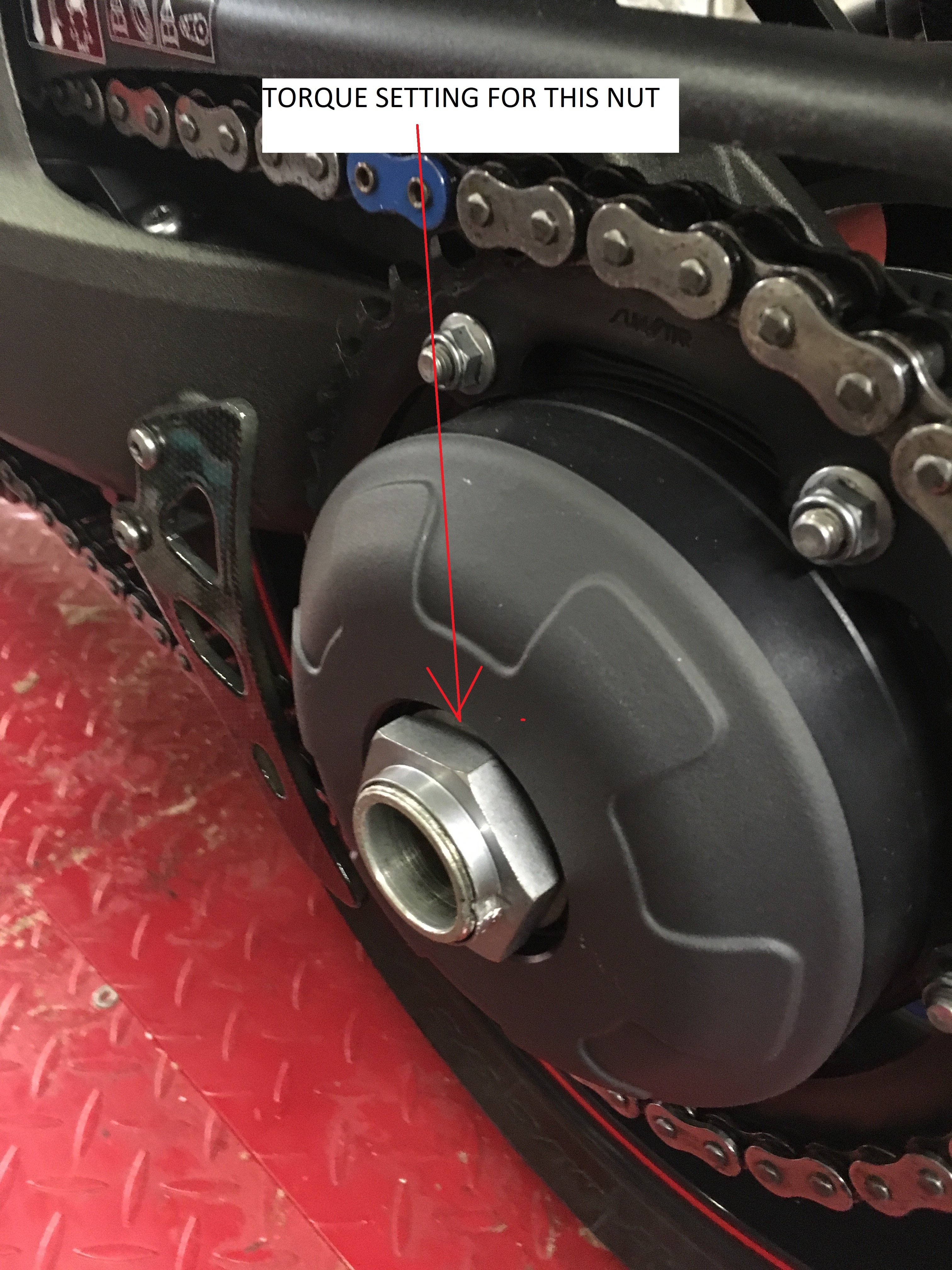

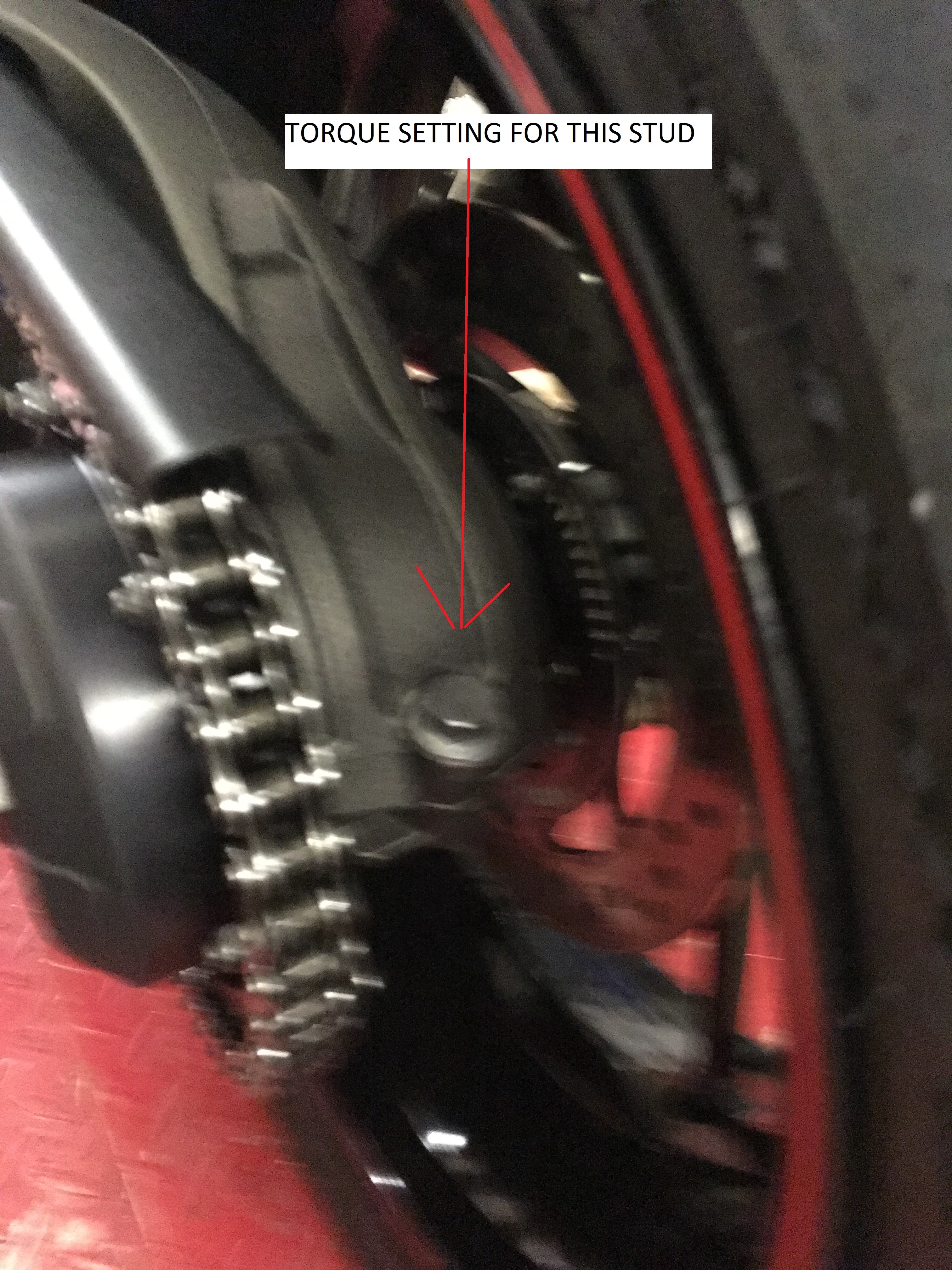

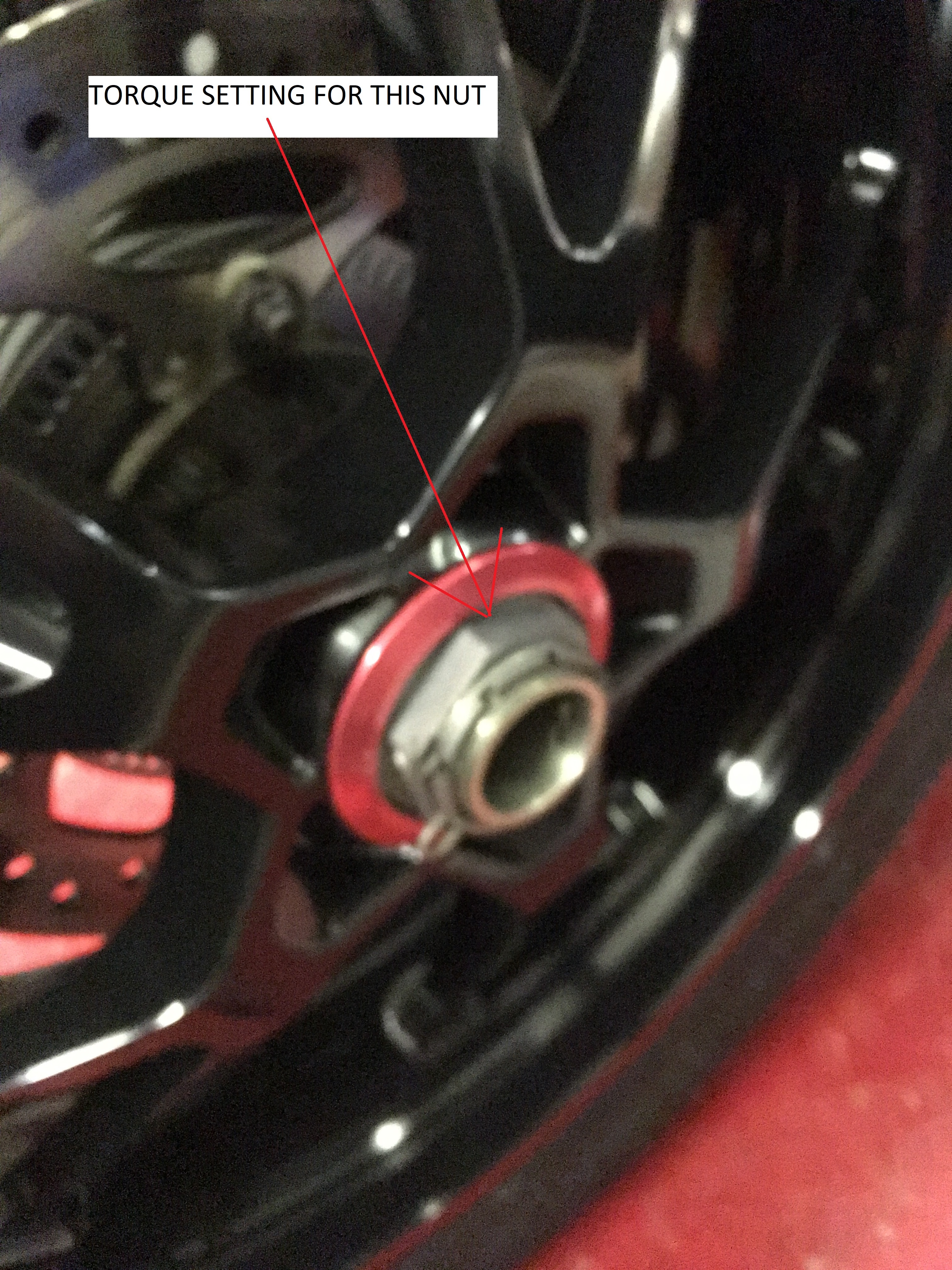

    Going to fit the chain guard this weekend, I would imagine it is a rear wheel removal job. I'm not adjusting the chain but I would like the torque settings for the attached photos.

    Hey buddy, I just removed mine and all you need to remove is the wheel and the rear hugger. There is also a couple of bolts above the chain. Just push the chain down and you’ll be able to access them. You don’t need to remove the axle nut on the chain side.

    Oh, and the torque for the axle nut is 146 nm.

    and its same torque setting for both sides, 46mm socket needed too.

    Les, to remove the rear wheel all you have to do is take off the nut on the right hand side. The one on the left (sprocket side) is for removing the stub axle, and should only be necessary for greasing the hub bearings. You also have to remove the brake calliper to get the axle out.

    Cheers Yorkie, I owned a 954 blade that I put a VFR 800 SSWA, so I am used to this set up, I just think that the 146nM for the hub pinch bolt seems a bit high, if it is 146nM.

    It’s 55nm for the pinch bolt. 146nm for each of the 46mm nuts.

    That’s correct. Both of those torque specs are in the owners manual.
