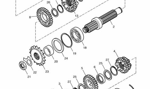

    You can do the job by:
    1. slackening the front sprocket nut
    2. slackening the rear axle, moving the adjusters all the way forward,
    3. there will now be enough slack so that you can then lift the chain off the front sprocket;
    4. Replace the current sprocket with the new one and refit the the retaining nut using a small amount of locktite and a new tab washer;
    5. Re-set chain tension.
    It's good to have a couple of new tab washers in stock, part number
    21. PFKL1182311 NUT. GEARBOX SPROCKET £ 4.25(€ 4.85)
    22. PFKL1198524 WASHER.SPROCKET £ 6.30(€ 7.18)
    23. PFKL1198671 SPROCKET. G/BOX. 17T £ 20.28(€ 23.12)
