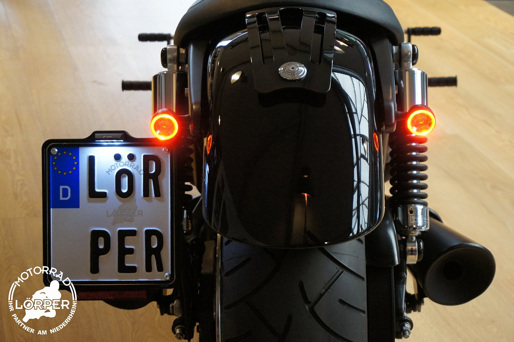

    Good info mate... Ill be doing similar in the near future. Cheers... Also gonna swap rear indicators for those 3-in-1 bullet style light straight from the fender fixings.
