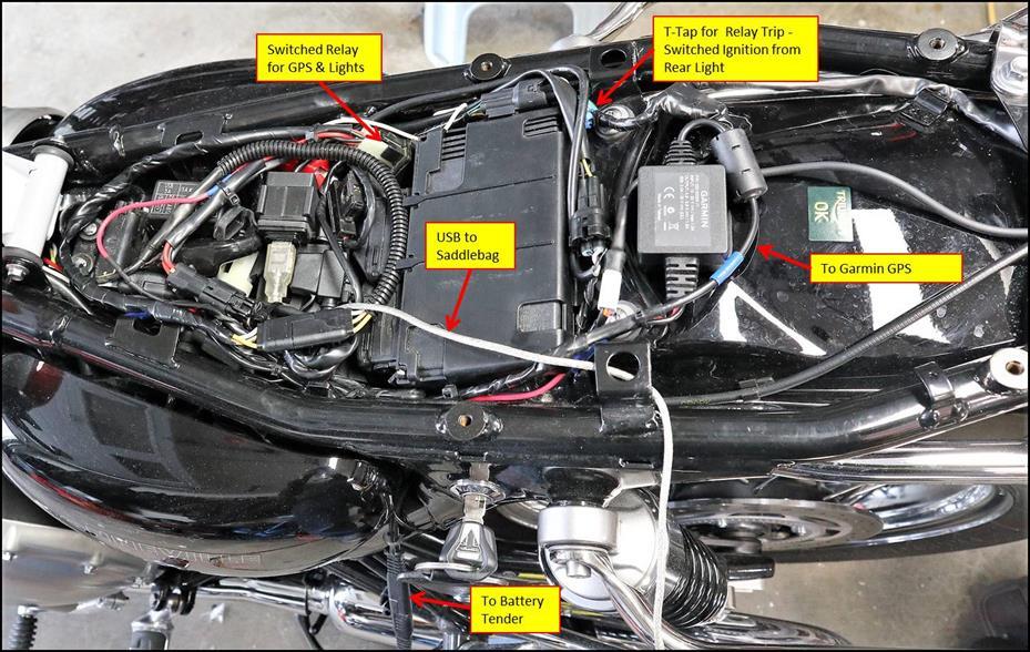

    I went a bit further you may intend. I've recycled my M/C Garmin Zumo and fog lights - now on the 3rd bike!
    Basically, I tapped into a switched live from the rear light to hook up a relay switch for the GPS and the fog lights - everything is ON/OFF with the ignition key. I use the USB port to go inside the left saddlebag.
    The pics show the under-seat wiring (I know, it could be a little neater) and the Garmin unit with the fog light switch just below it.
    On other bikes I've mounted a cigarette power socket and run a switched power to it, then use the cigarette power plug from the GPS.
    Before, I've used a combined fuse block with relay - then you can simply hook up to this device. One problem is that there isn't much room on a Bonnie to hide things but the wiring is fairly simple. I did read somewhere that there is an O.E. accessory socket under the gas tank. I think I found it but I didn't try to use it. BTW, the Triumph electrical connectors are diabolical to separate!

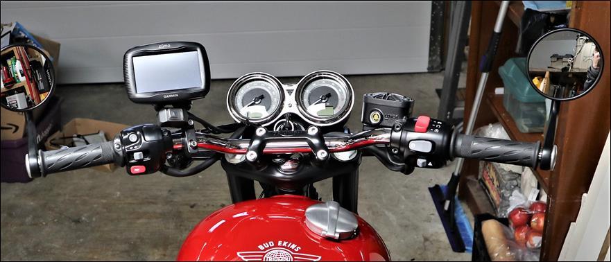

    This may sound like it's coming from way out in left field, but how are your eyes? I have to depend on reading glasses for close-up vision, which I don't need while riding. I use a Garmin on my T100 and I can't read its' instructions without my glasses. So, to make a long story short (maybe) I have a Garmin with Bluetooth capability, an inexpensive Sena communicator, and I've paired the 2 together so that the GPS can "tell" me where to turn, and I don't have to rely on seeing it's instructions. You can get a Ram mount to attach a Garmin to your handlebar. Most Garmins have a USB-Micro connector, so you could get a 3 or 4 foot charging cable, attach it to your GPS, then run it under your tank to the USB connector under your seat. Here's a pic of my arrangement

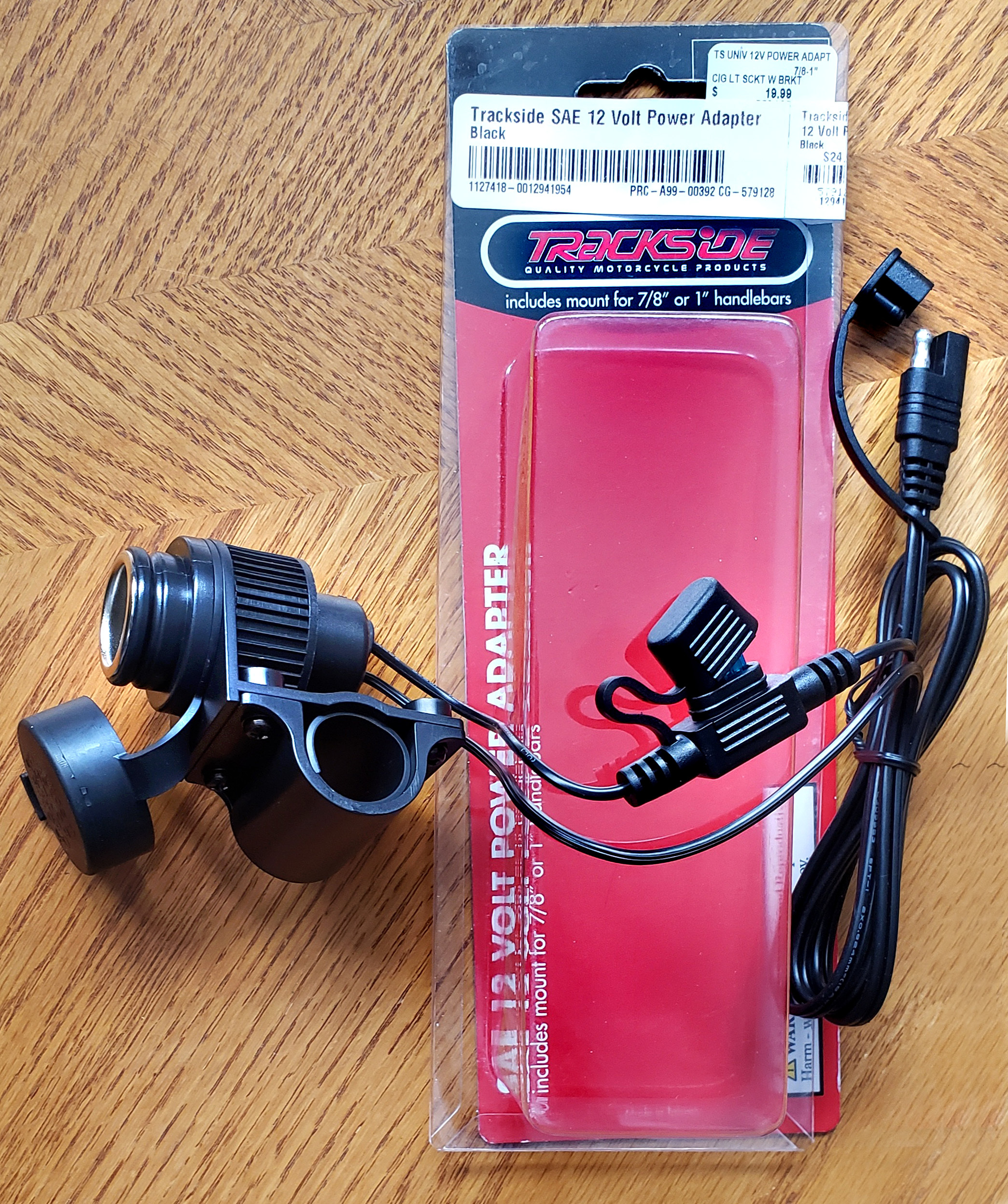

    I hope this can help some others. I believe I have found my solution. The dealer pointed out to me a slightly dangling wire outside of the seat, on the left side. He told me that was the charger port should I want to hook up a battery maintenance tender for the winter months. So.......while at the cycle gear store, I mentioned my dilemma and they pointed me to this adapter for the cigarette power source on the Garmin GPS. It should work perfectly although I have not hooked it up yet. Has female cigarette port, inline fuse, and the other port matches the battery tender port dangling outside the seat. Hopefully all I will need to do is zip-tie the wiring all the way up to the handlebars under the tank and my connection will mount there. It even includes a handlebar mount. All for $20. Hope this helps anyone else. Picture attached.
