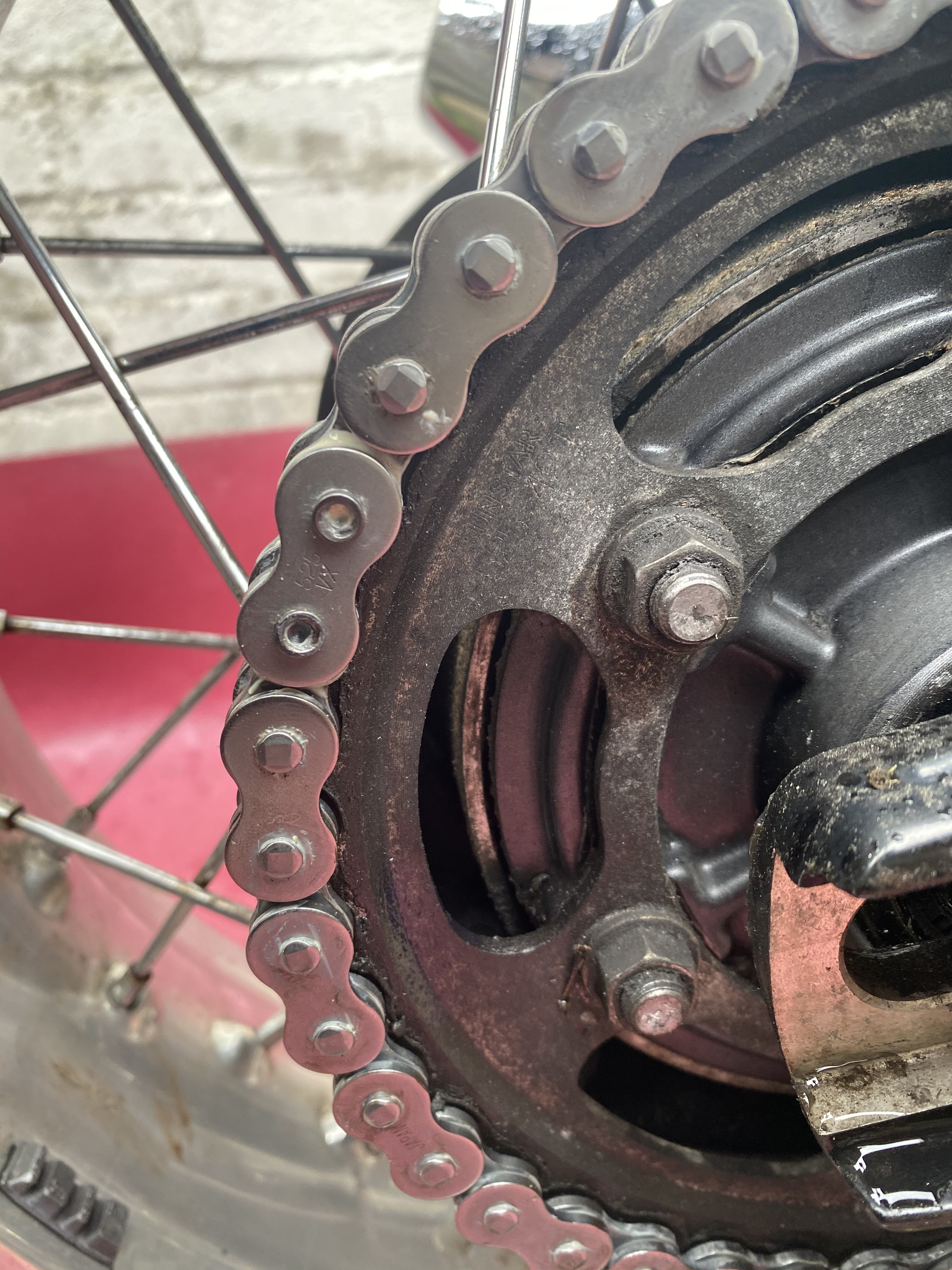

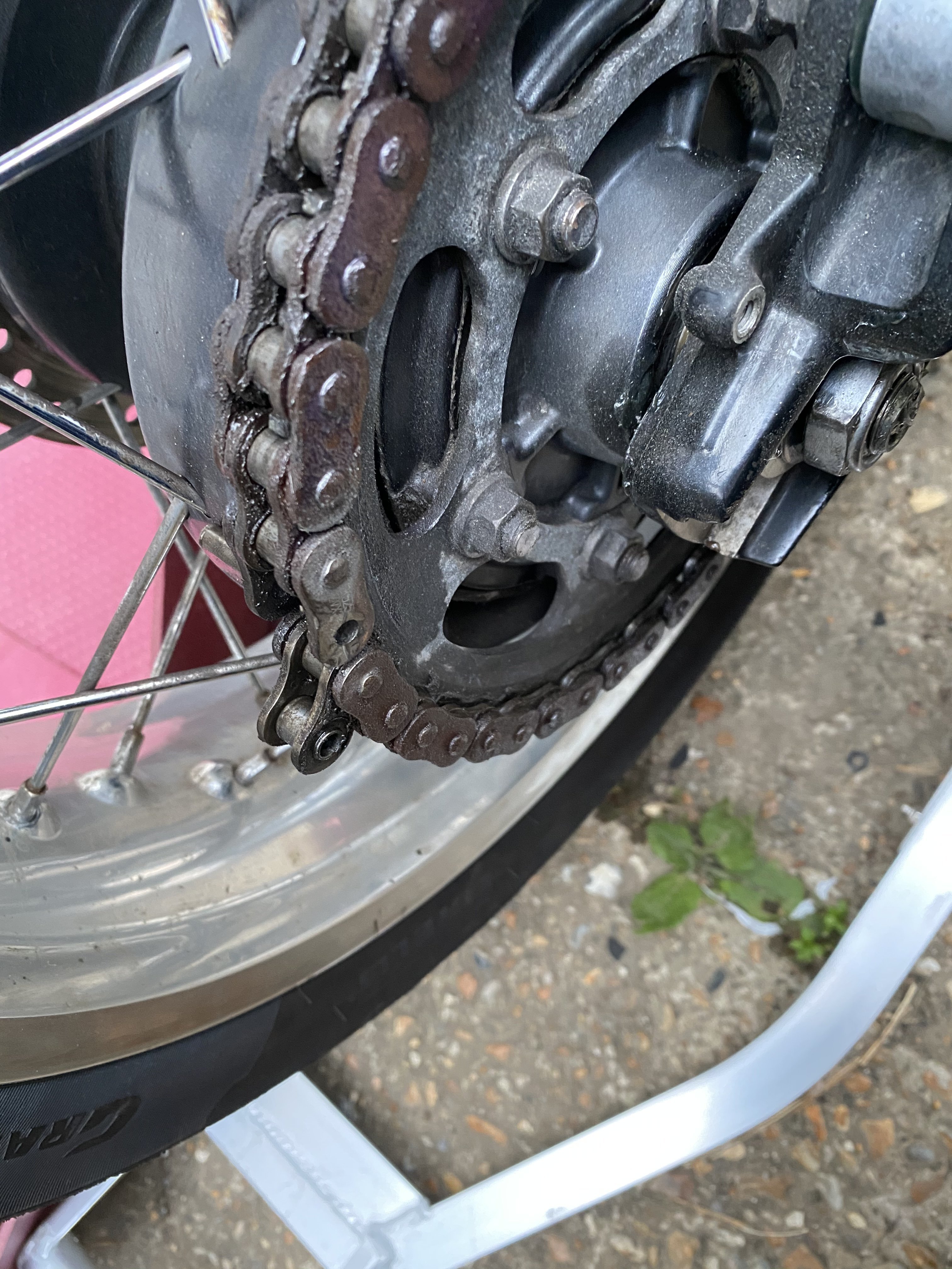

    I need to replace my chain because it’s totally fecked:confused:
    How do you break the chain link to split the chain? Dremel or angle grinder followed by link breaking tool?
    And if a Dremel which tool? What does it look like? The discs I have all look a bit flimsy...
    Any help gratefully received :)

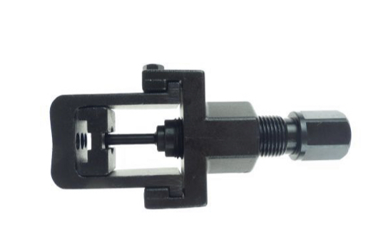

    ANGLE GRINDER??? Wtf?? Hell no, don’t want any sparks flying around and destroying my paint... use a chainbreaker. Such as:

    I’m getting the chain breaker set to
    A) get the old link out
    B) rivet the new link pillar closed
    Anything I’m missing???

    Yes get a good set and do both jobs easily. Check your chain and you usually find a link that looks different. I/e it will have two indents in the link and that's the one to remove. Dremel maybe angle grinder asking for disaster.

    Even a cheap chain breaker will do the job without any grinding , if you find the soft link as Shaun mentioned, I done it recently on my O'ring 530 chain , on a 98 sprint , bought chain and breaker for £40 odd , from China ! Temporary chain as I'm mucking about with drive ratio !!

    I just used a metal file to file the rivets down then the tool pictured above to push them out. Didn’t take long

    After a couple of false starts managed to grind off the pillar head with the dremmel looking tool, I found taking it very slowly and gently the black cutting disc did the job
    And the chain breaker was indispensable not pretty result but chain broken and ready for replacement

    Many thanks for everyone’s input, new chain now fitted, to finish I found flaring the pillars out after fitting the closing plate took a huge amount of force to get the shouldered domed pin on the breaker/ riveter tool thereby securing the plate. I ended up using a torque wrench to get enough force on the tool!!
