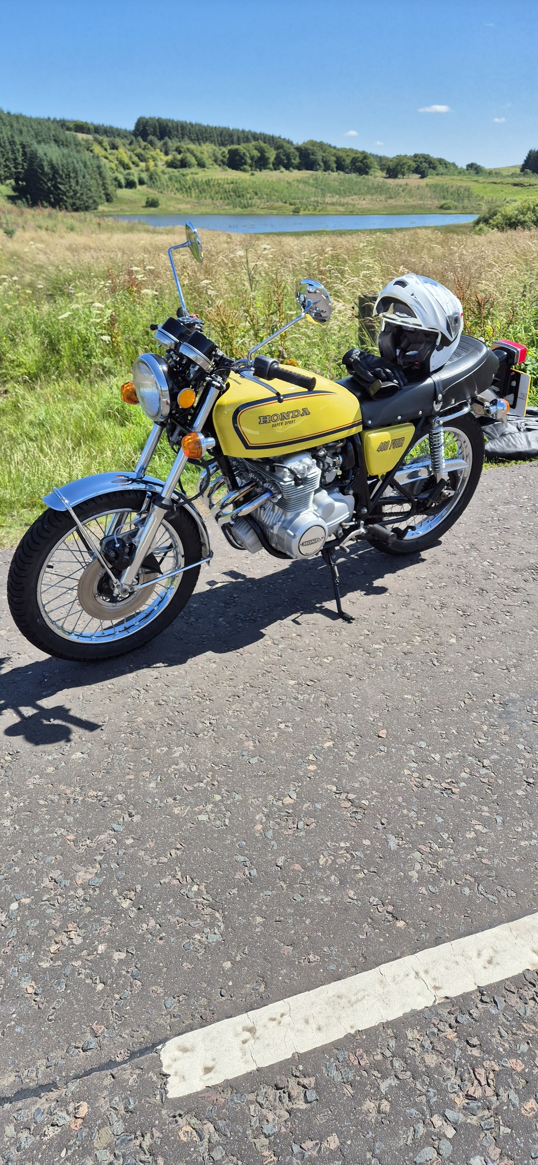

    I would love that on my 70s 400four..to hell with the its not standard crowd. They wouldn't be saying that if they stacked it into a wall due to non existent brakes. :) 20250710_140750.jpg

    @Pedro1340
    That looks really beautiful,
    In the 70s I had a 250N, not only needed more pots but the original pads were useless in the wet. 70mph in the pouring rain, 30+ yds before anything happened. Permanently clearing the water off the disc on a very wet trip.

    Lol thankfully I haven't tried braking in the wet with the 400four, personally I would have it in the living room as a display piece. :).
  17. Bikerman
    3,697
    That's without a shadow of doubt a stunning bike.
    This is for the bike :heart::heart:.
    Sadly not for you :joy::joy::joy:

    Has that bike ever seen a damp sponge never mind rain it's a credit to you is it electric start as well as the kick start what's the mileage I can't get over the condition it's like brand new it wasn't one of these bikes padgetts keep finding in their stores new old stock :blush:
