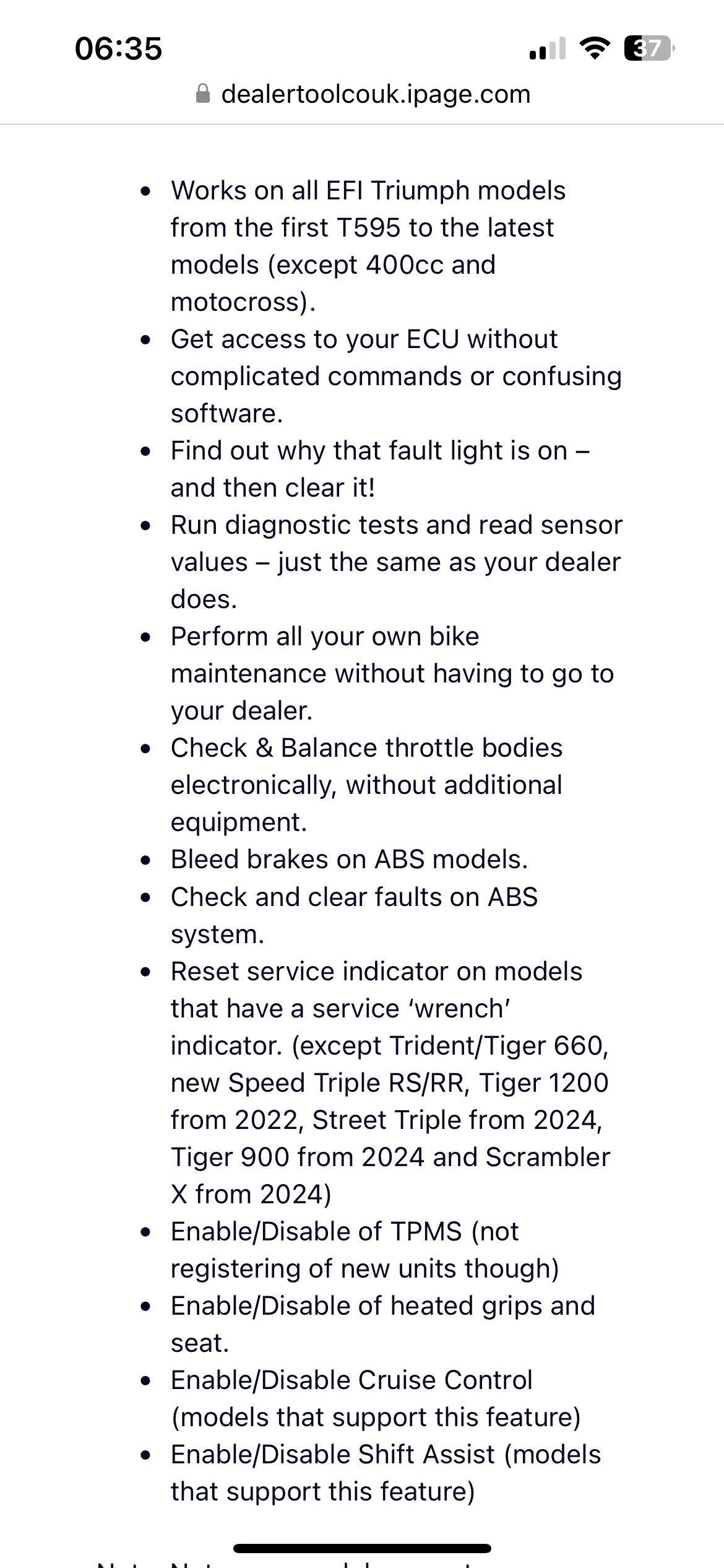

  8. Boothman

  13. Boothman
    Boothman Elite Member
    Jul 26, 2023
    1,119
    Wigan
    It plugs in to the diagnostic socket and if you click the link I showed it lists what you can also do with it…..

  15. Boothman
    Jul 26, 2023
    1,119
    Wigan
    Pass - as I said, I have nothing to do with Dealertool. I bought it to do the ABS bleed which it performed perfectly for.
