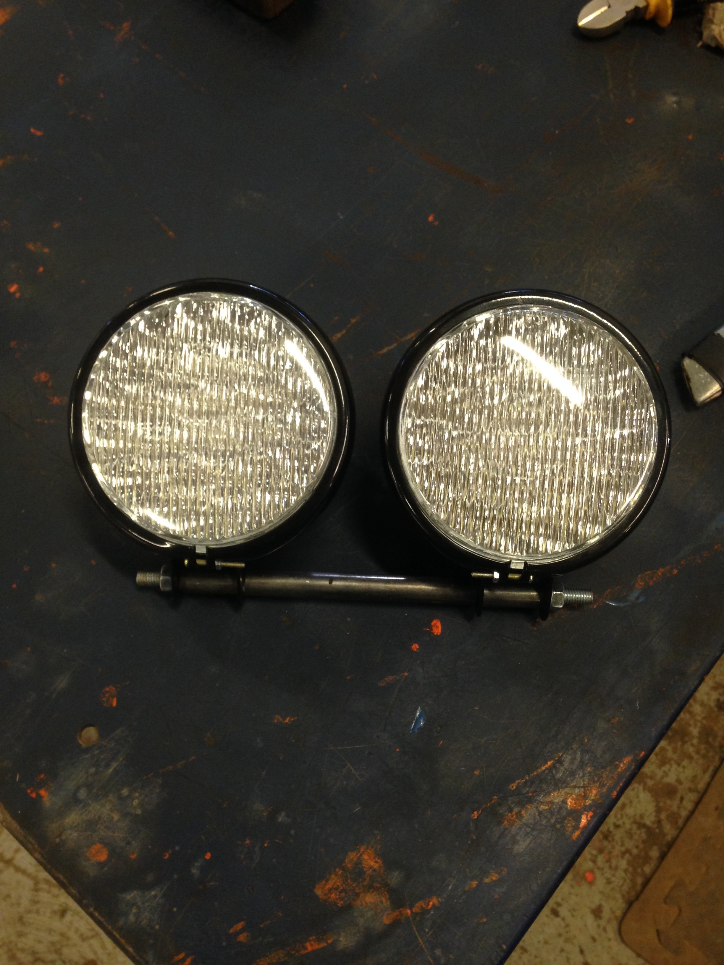

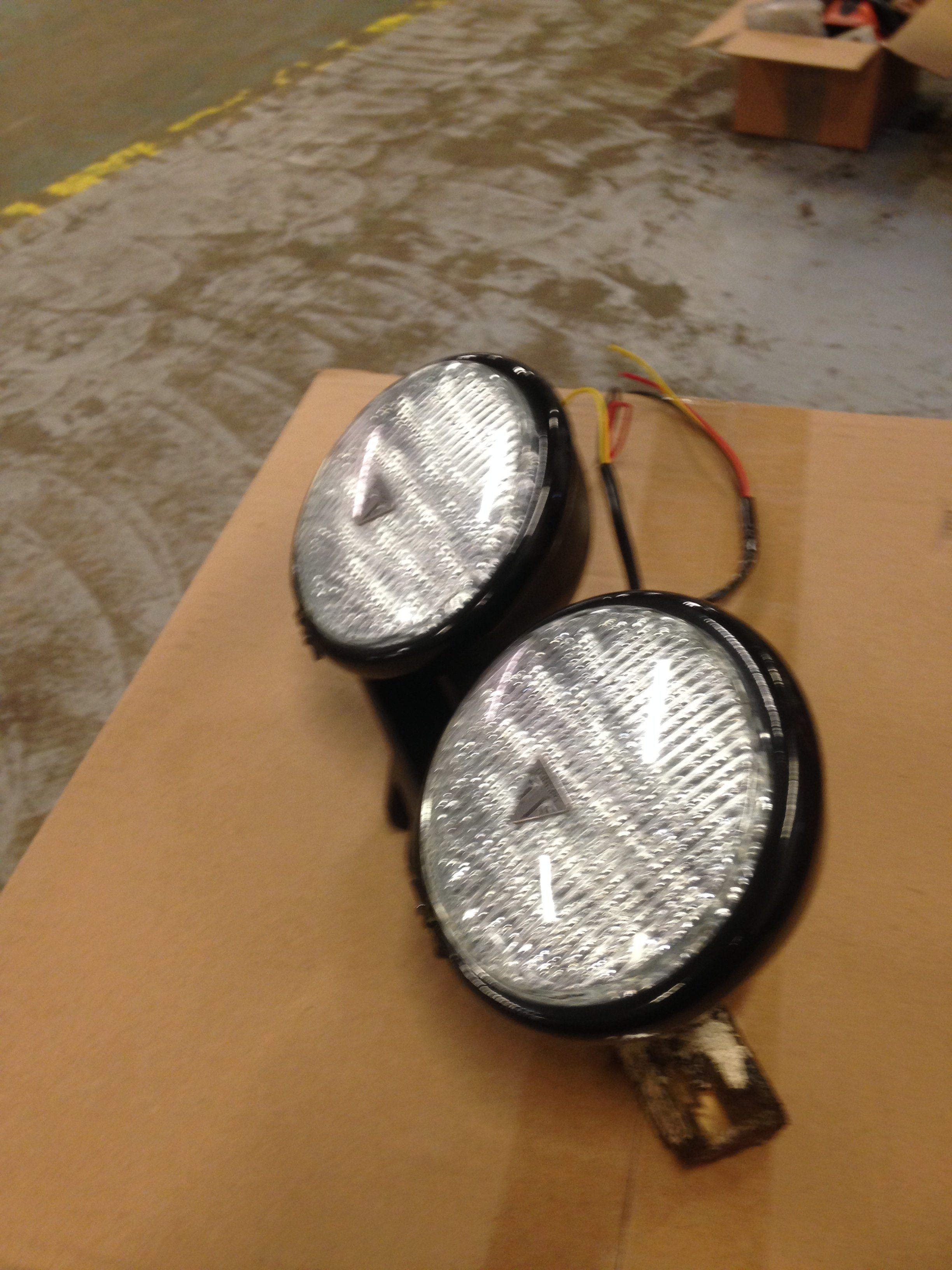

    As some of you maybe aware I got these two headlights from fleabay for £16.99 each :)

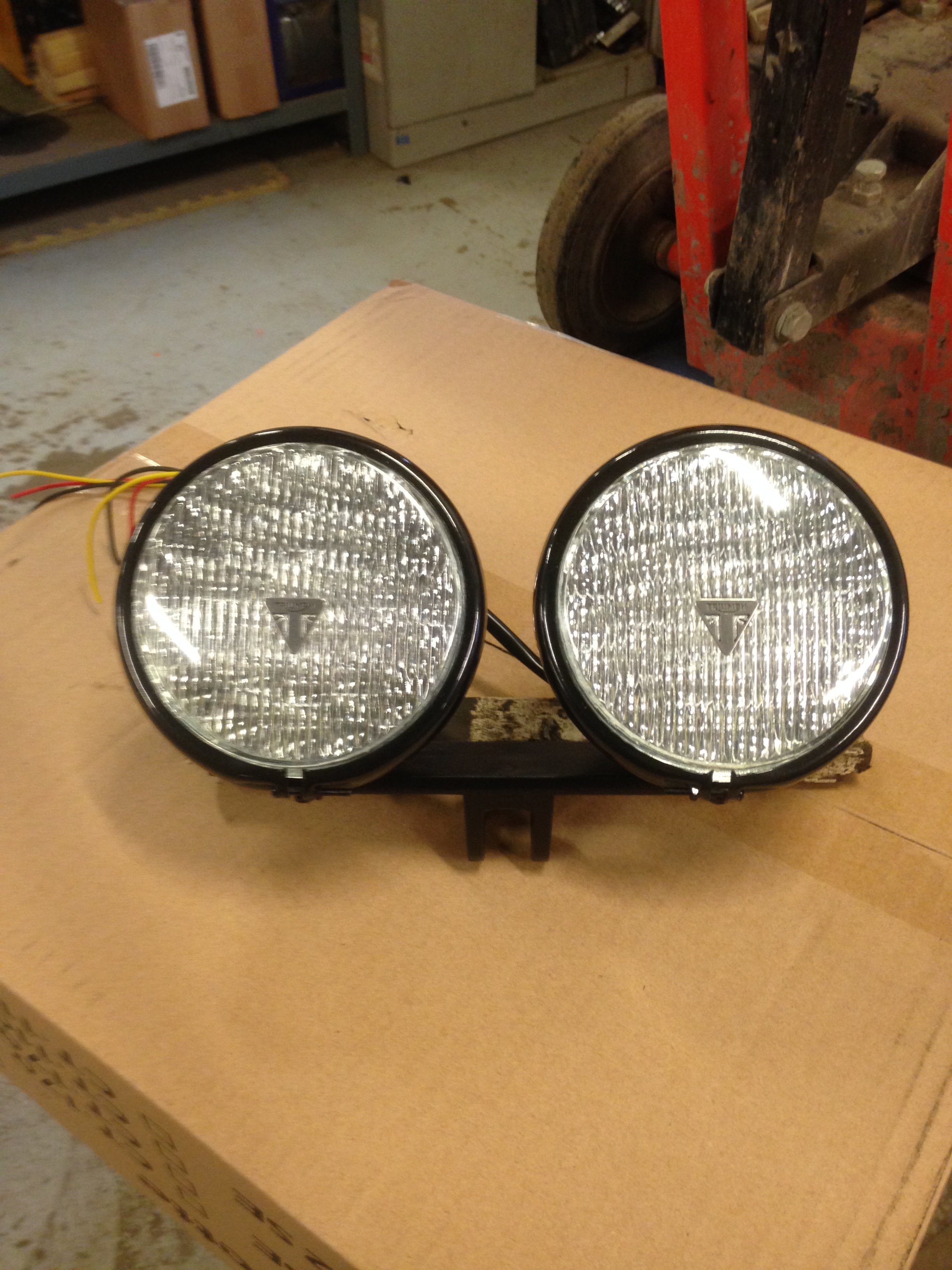

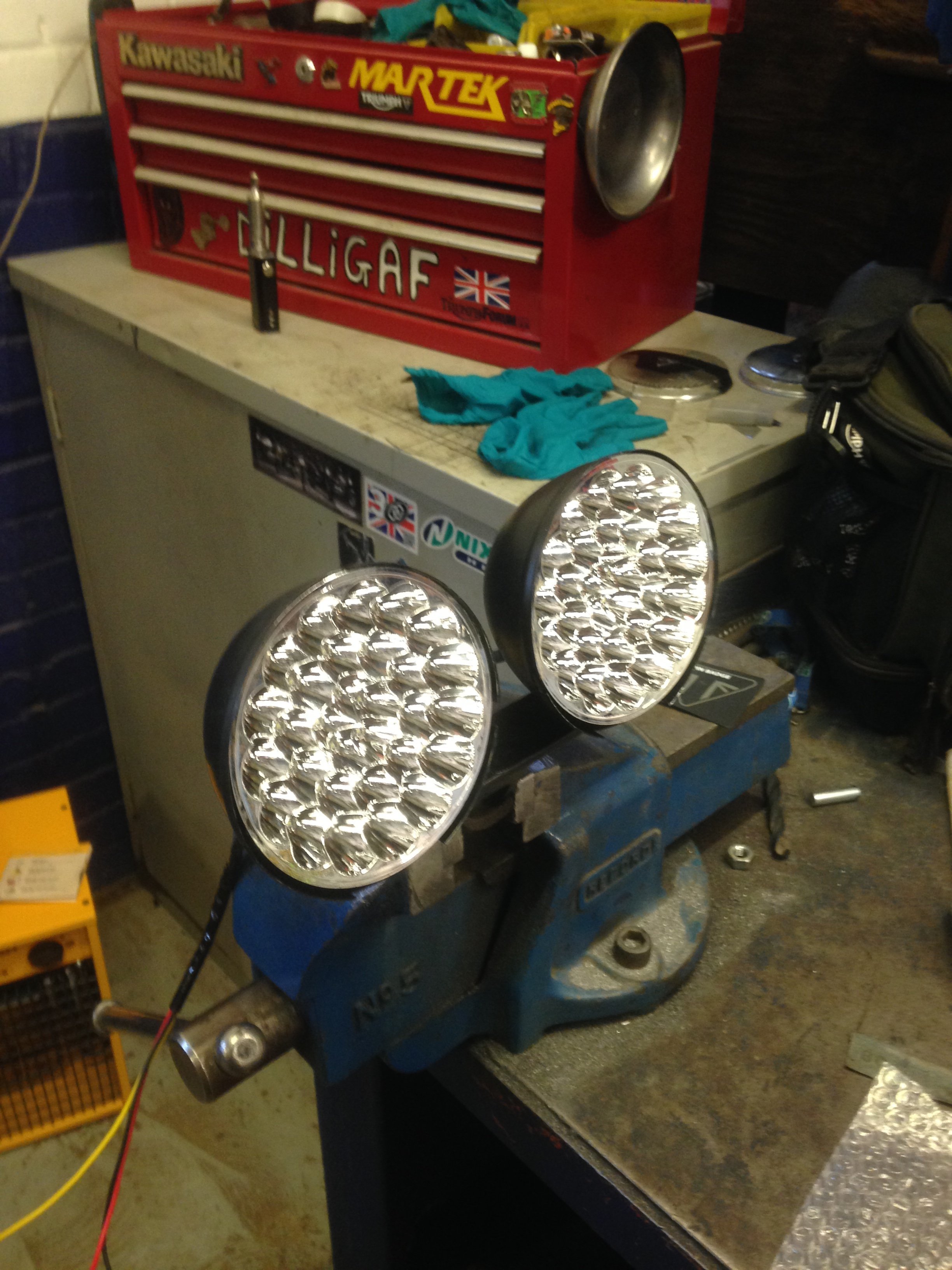

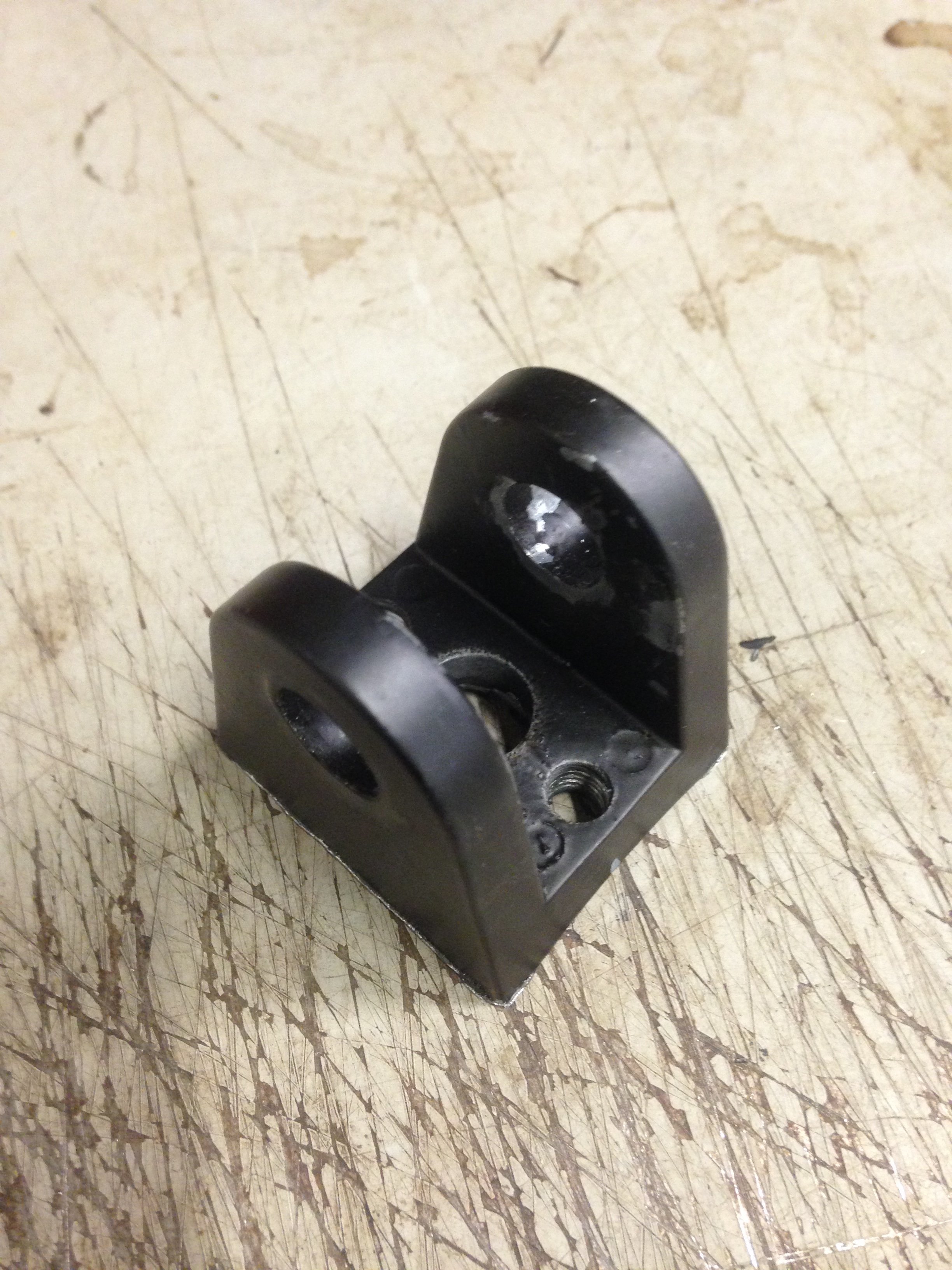

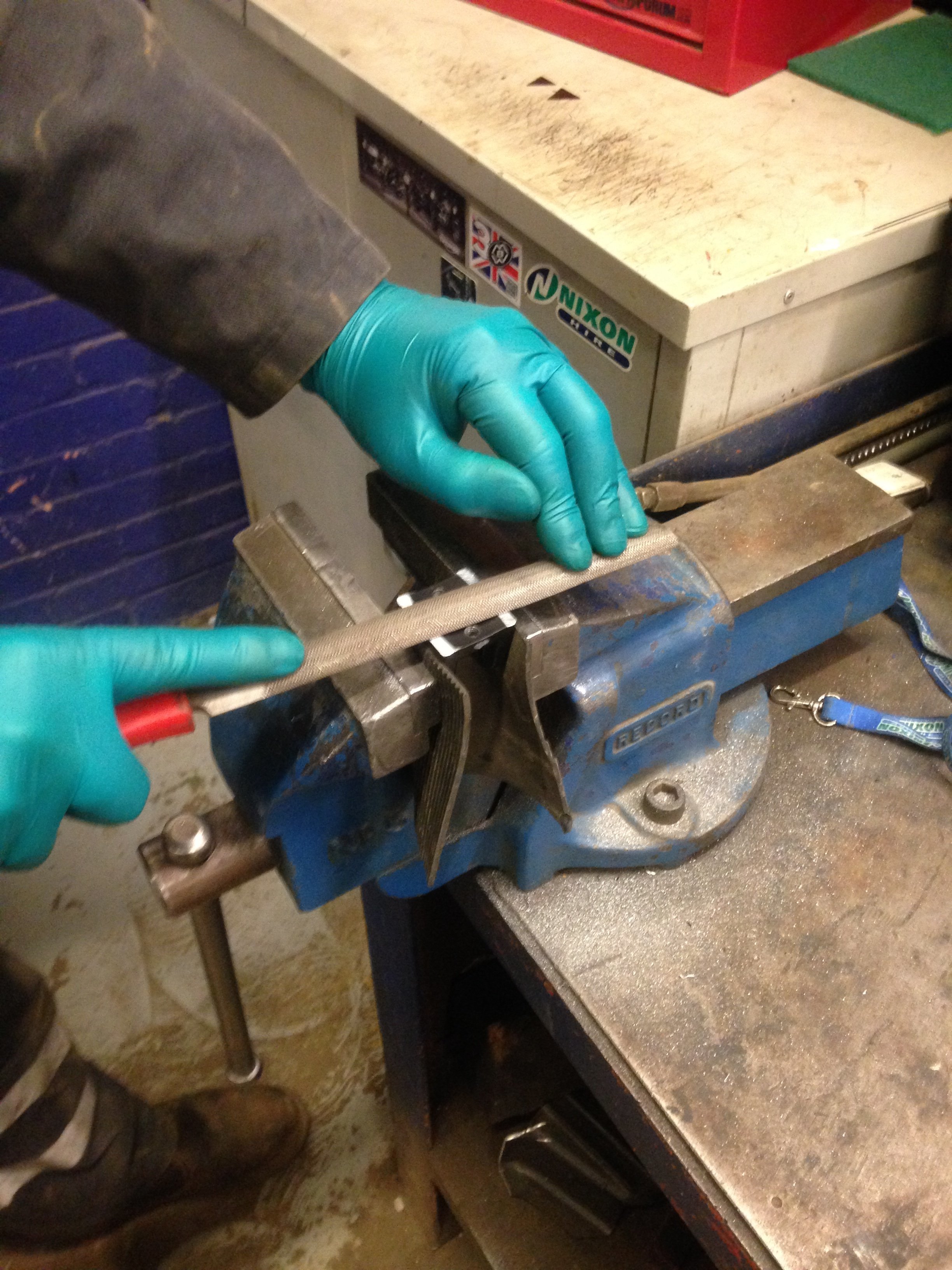

    The idea is to make a set of twin headlights for my BPOS to give it a Storm kinda look :cool: IMG_0426.JPG made this crossbar but can't get the lights to line up properly so I've had a rethink and....., IMG_0427.JPG ....pinched this off the prison bar headlight currently fitted to the BPOS :) IMG_0429.JPG needs filing flat because it's curved to take the headlight:confused: IMG_0430.JPG started to make a new design crossbar :)

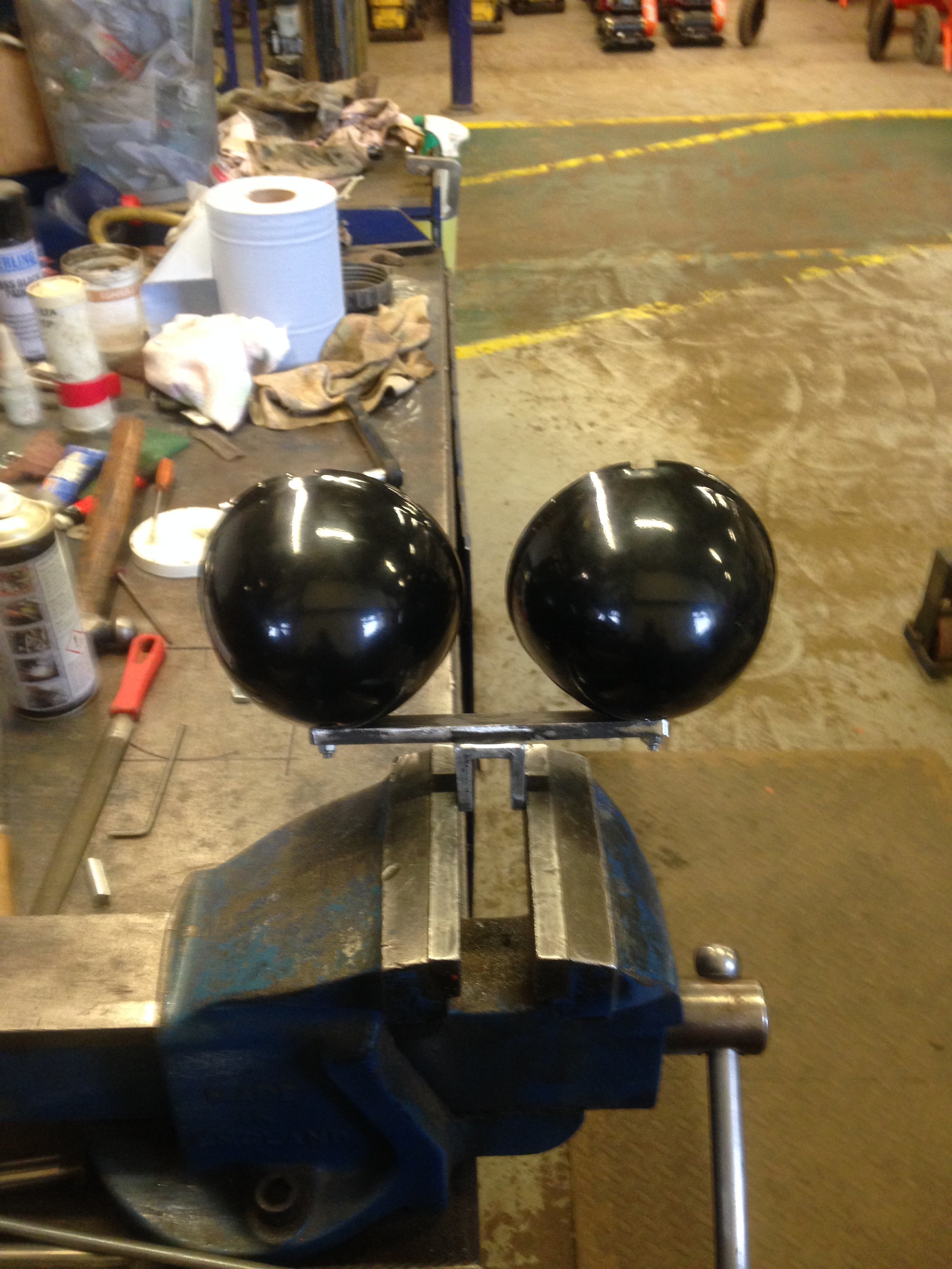

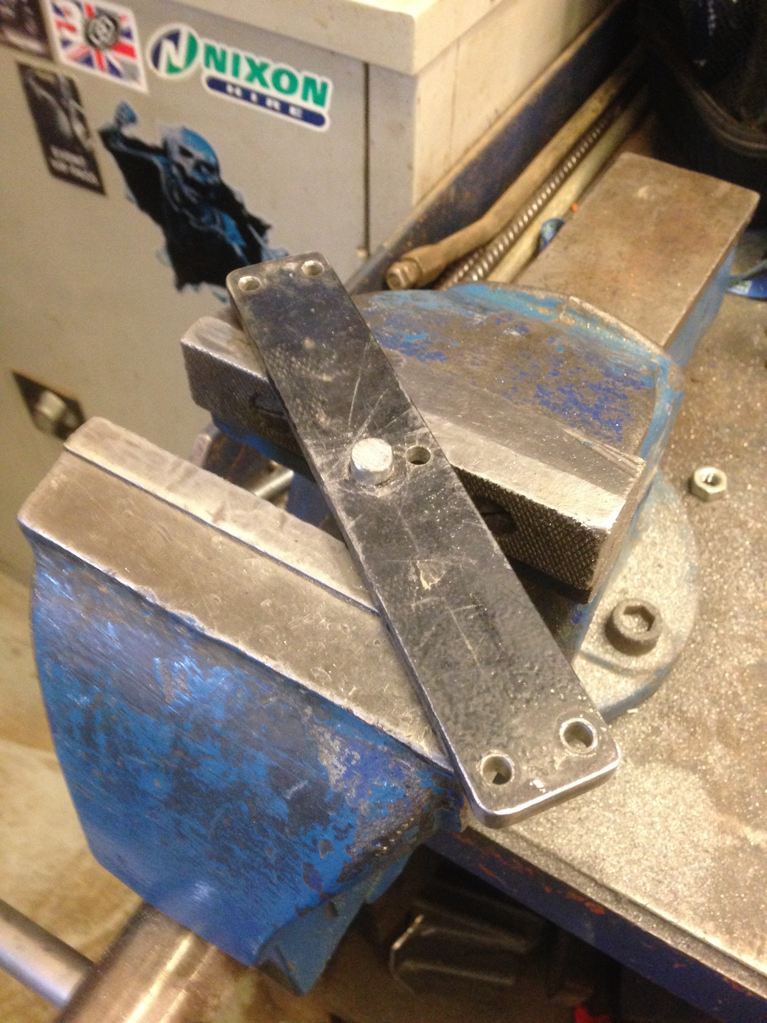

    Ok....as I've already said the first crossbar I made would throw the headlights all too cock:( so after a trial run this is what I'm going with :)

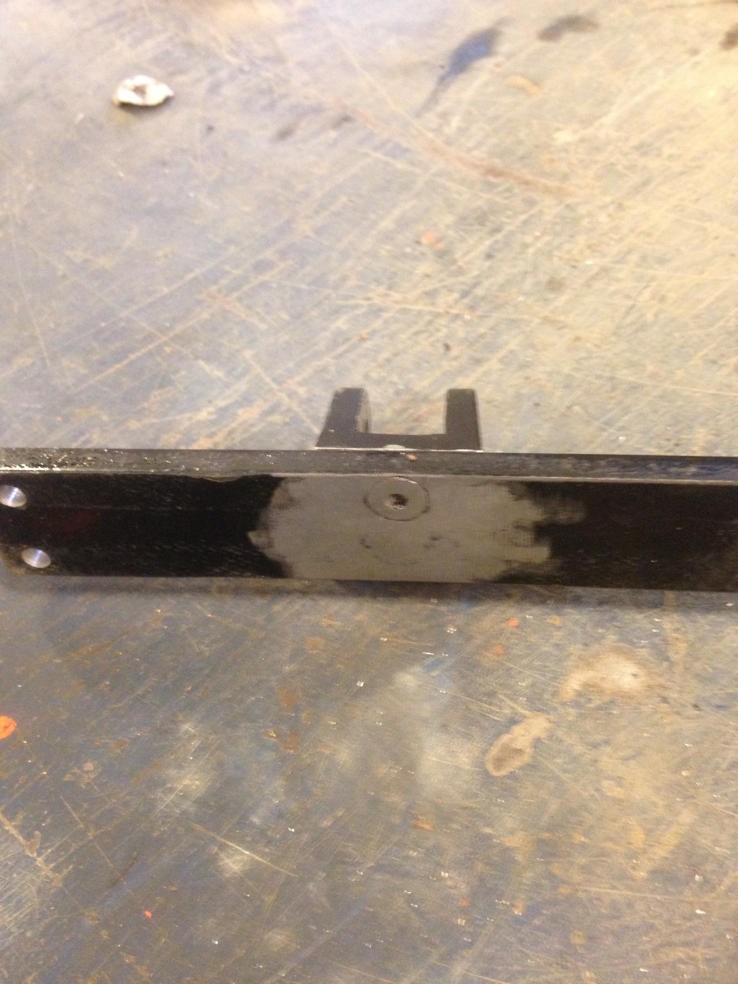

    A sturdy bit of flat metal bar
    Made a location dowel out of a bolt and welded it in place IMG_0432.JPG drilled the necessary holes and used epoxy resin and a countersink bolt to hold it altogether :) IMG_0433.JPG couldn't weld it because one parts aluminium and one parts steel:( IMG_0434.JPG started dressing it up and hopefully get it painted later today :)
    The bottom two pictures should have been the other way around but you get the idea :p

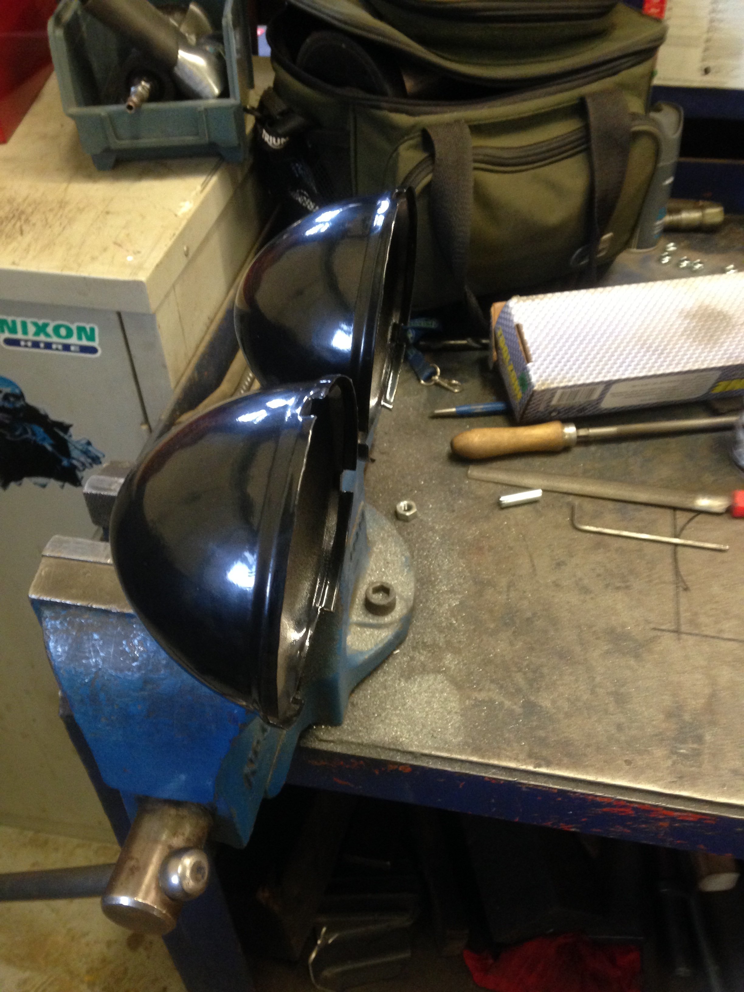

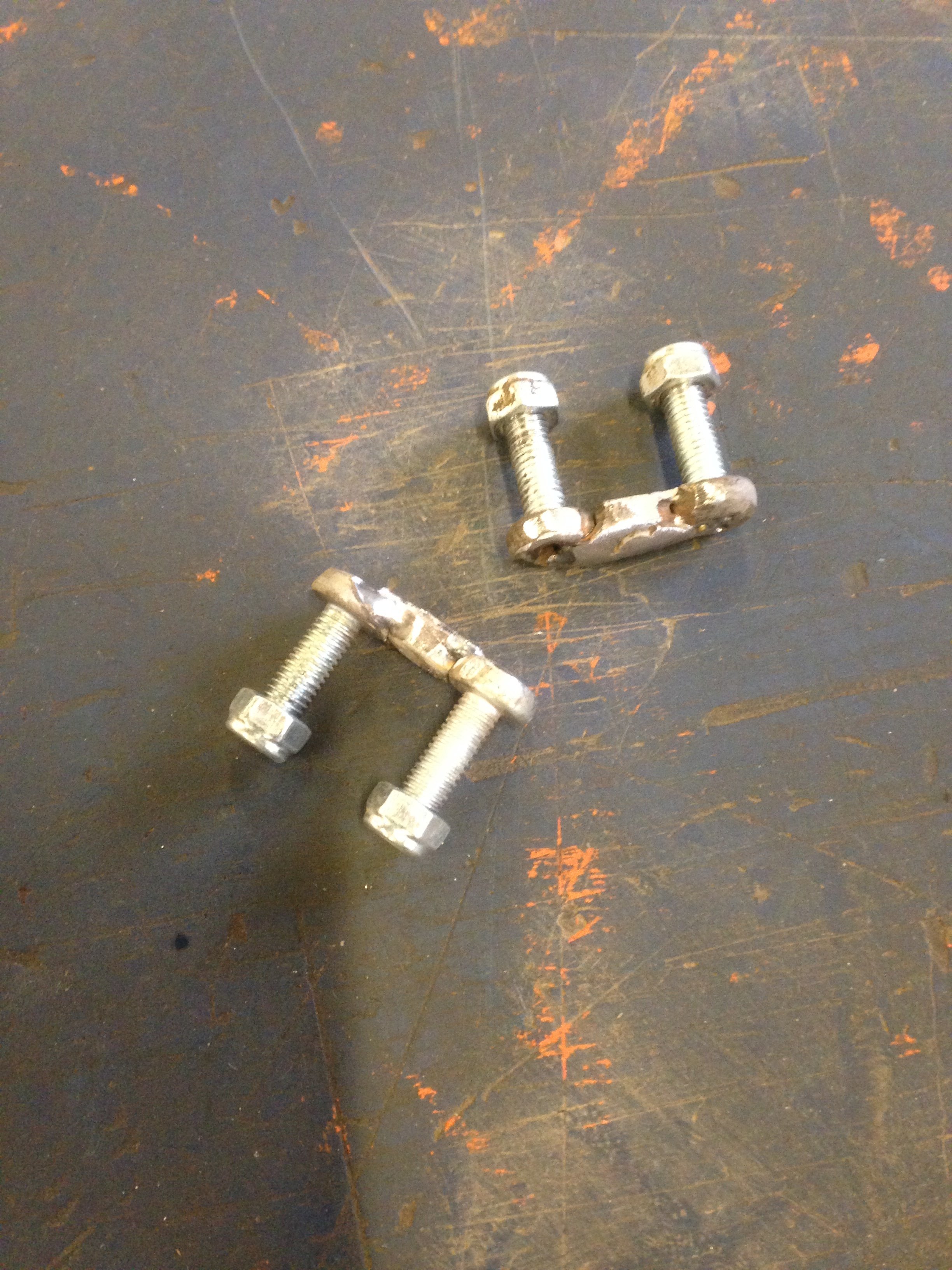

    Just made these :)
    They go inside the lights so I can tighten them up without being inside the light bowls :)
    Means I can hold the lights in position and tighten them to the crossbar without them twisting out of alignment :p IMG_0435.JPG

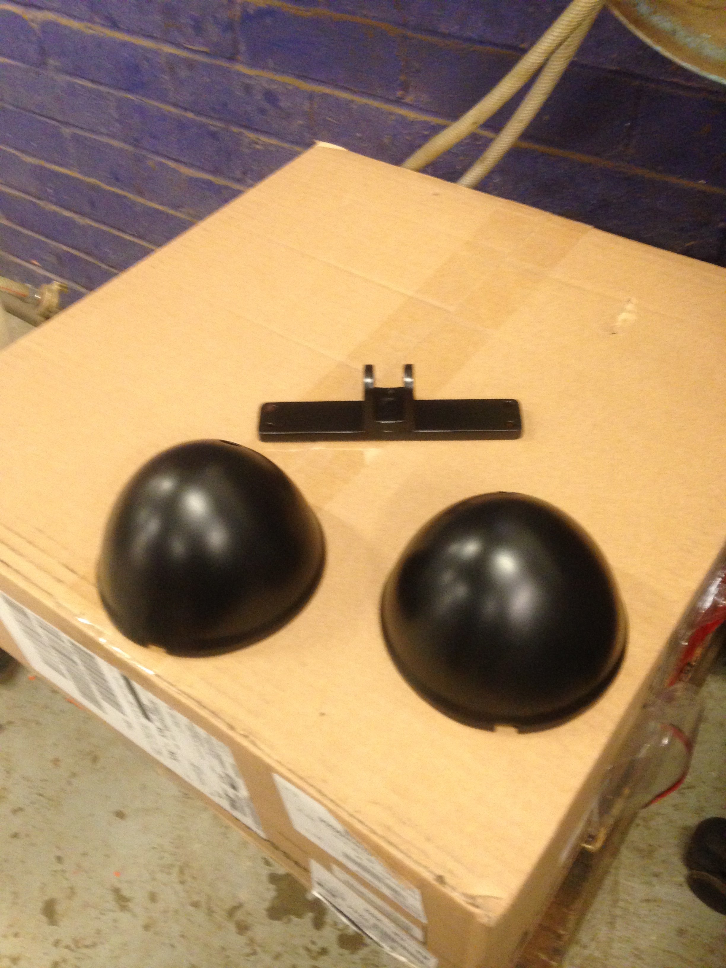

    Bit of red oxide primer should do the trick :p
    Will paint it tomorrow...Hmmmm...but what colour????:confused:....I know :eek:....SATIN BLACK :cool: IMG_0438.JPG

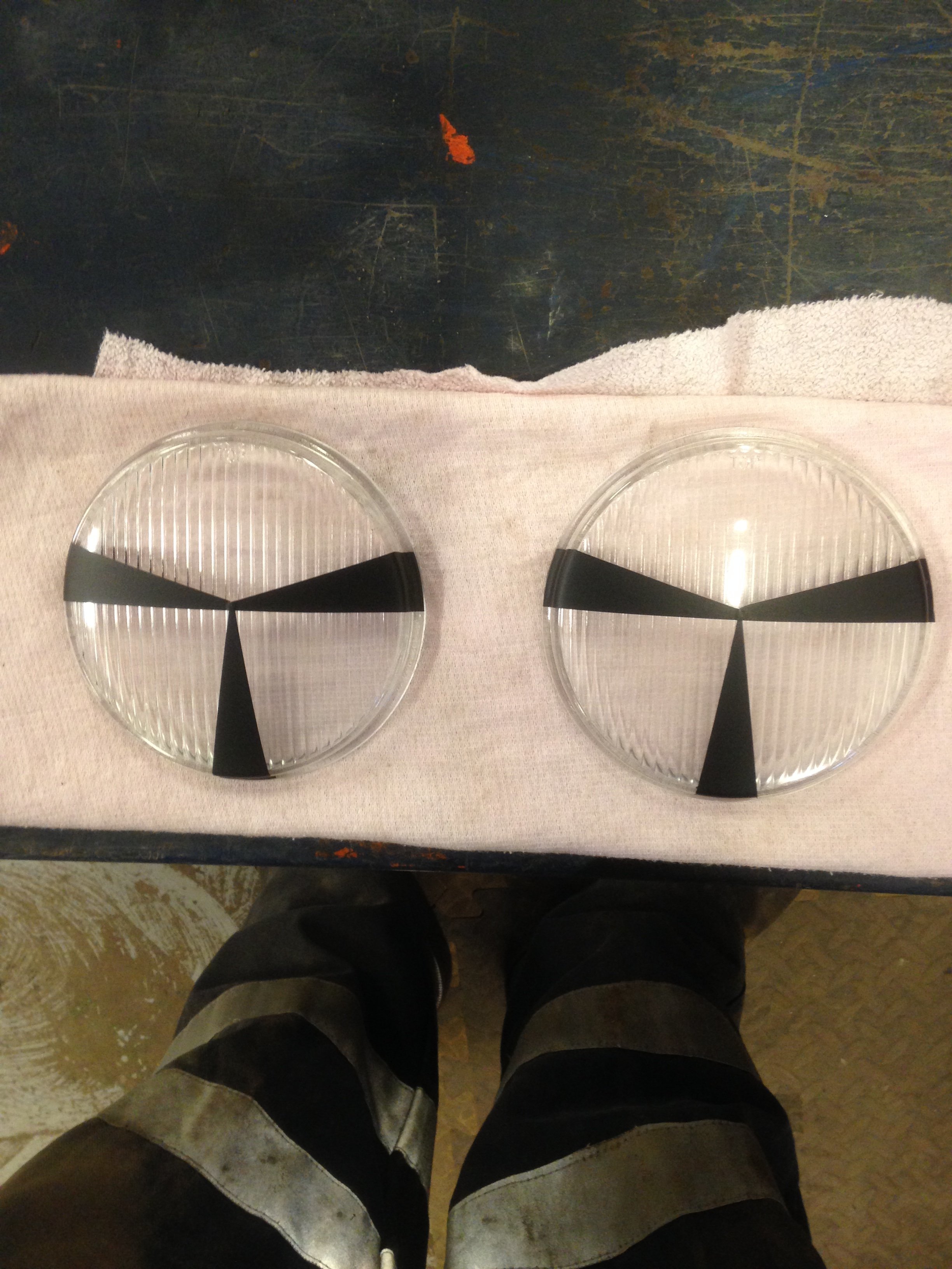

    Have left the lens clamps gloss BLACK :cool: hoping for a nice contrast between the lens/clamp/bowl :) IMG_0440.JPG waiting for some metal badges to arrive from fleabay which I intend to affix to the lenses :)
    So started messing with designs on the front of the lenses and have decided to go with this design but won't know what or if I like them until the badges are here :confused: IMG_0441.JPG

    Decided to get rid of the BLACK :cool: T shape on the lenses and put the badges on by themselves....I've mounted them slightly lower than centre :) IMG_0443.JPG paint dried nicely overnight :) so being careful not to scratch anything I started the assembly :confused:
