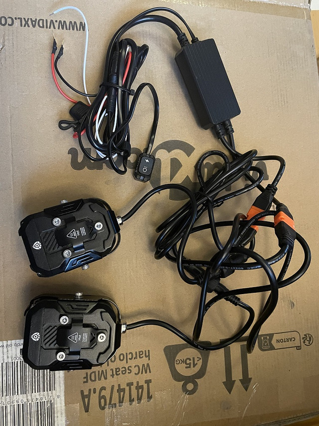

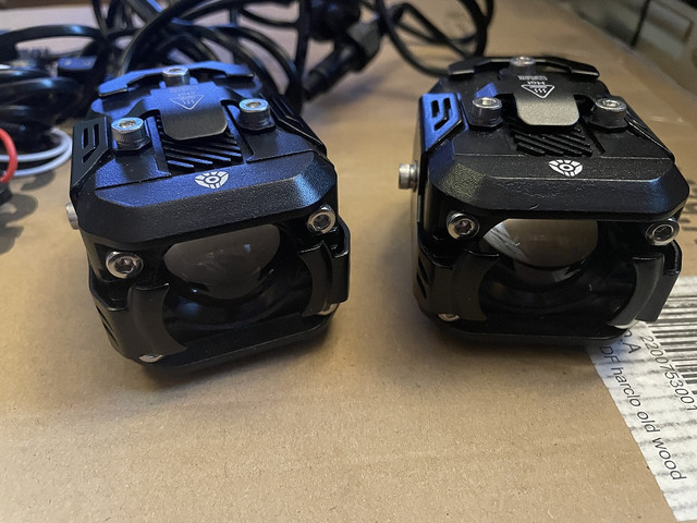

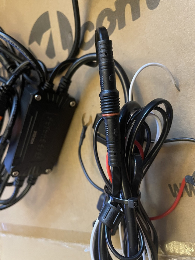

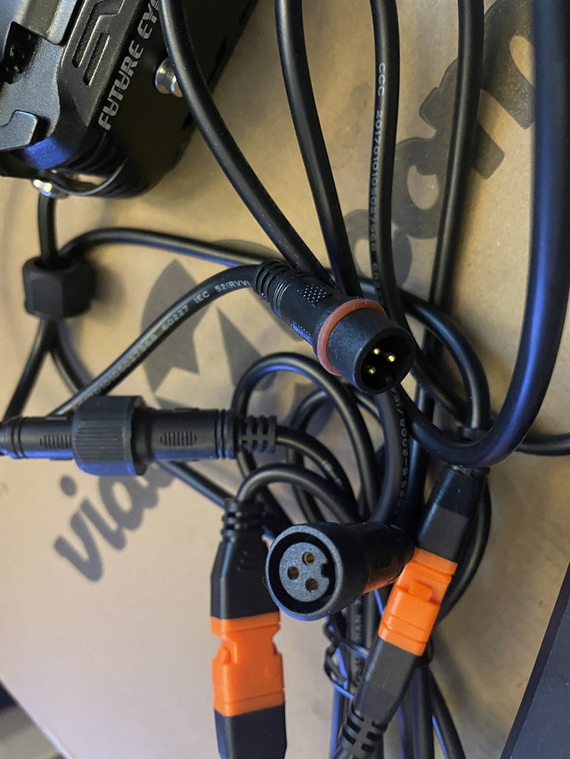

    I got the lights. Here are few photos.
