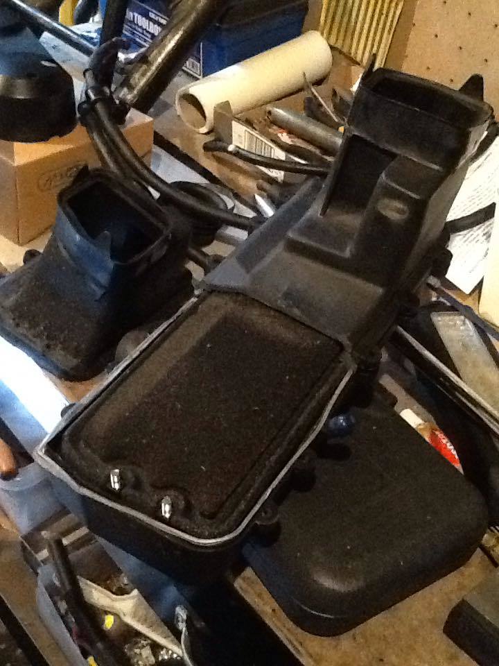

    With a bike that age I would firstly,
    Change the carb to head rubbers ( air leaks will cause idle issues )
    Clean the carbs paying extra attention to the idle jets, readjust the pilot screws to 2 turns out from closed
    Check the float heights & float valves.
    Drain the fuel tank into a clean bucket and check the bucket ( t300's have a habit of collecting water in the bottom of the tank )
    Remove the rocker cover and check the valve clearances ( unless you have written proof they were done in the last 3-4000 miles )
    Next time you remove the airbox remove the screws and cut the back in half to make it easier to remove & refit the carbs and filter in future. 22780514_1761925917434980_6270045923387701969_n.jpg 22780579_1761927187434853_7255386756993120568_n.jpg
