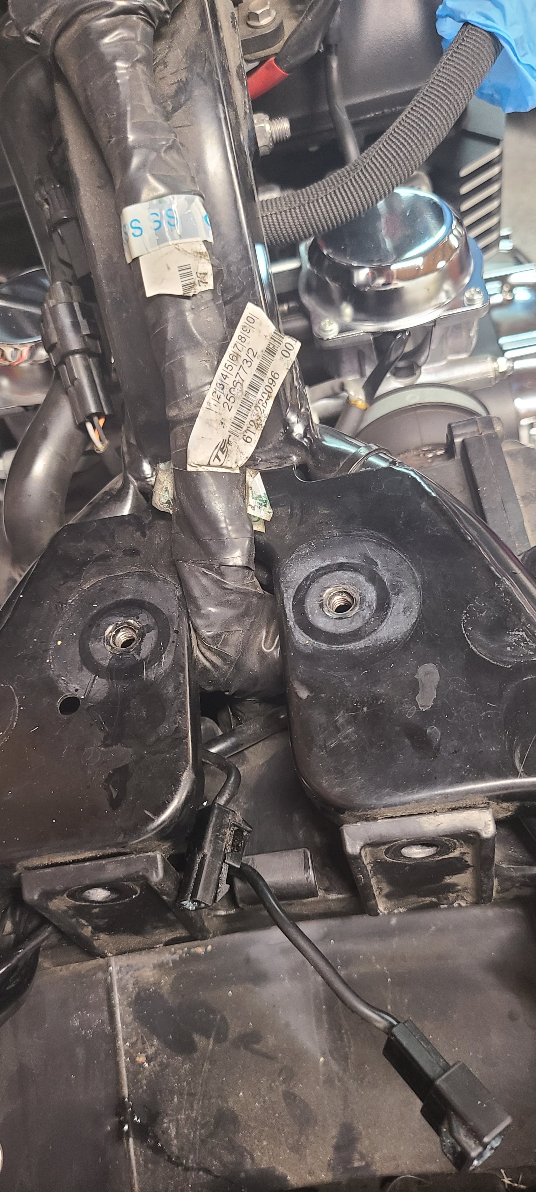

    The crank position sensor (cps) is an electrical coil that sits under the triangular right hand engine cover. It feeds a signal to the ECU via a thin black wire that runs up behind the right hand side cover to a connector adjacent to the battery.

    ......self evidently check the connector near the battery first and, if you have a multimeter, check the resistance between the two wires. You are looking for about 570 ohms although that is not 100% guarantee it is not faulty.

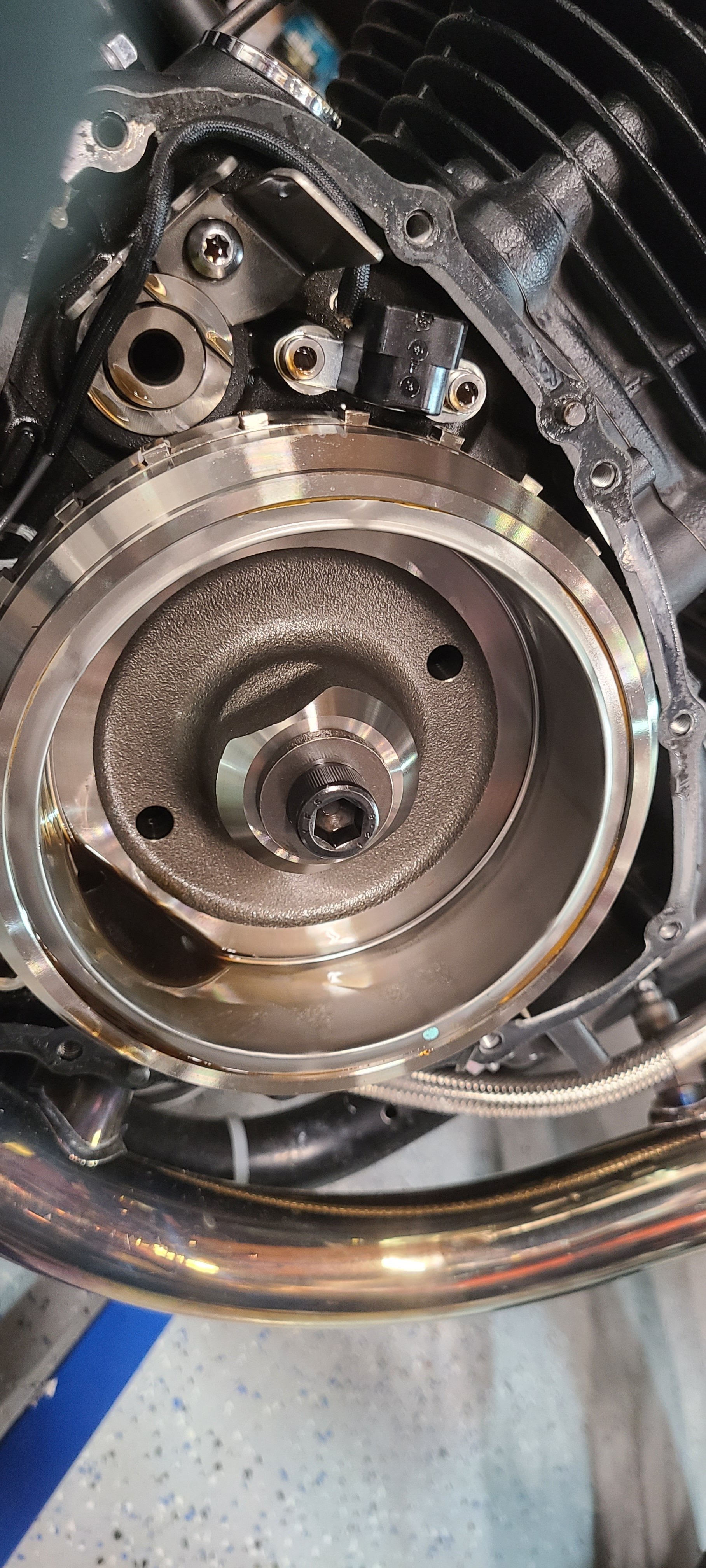

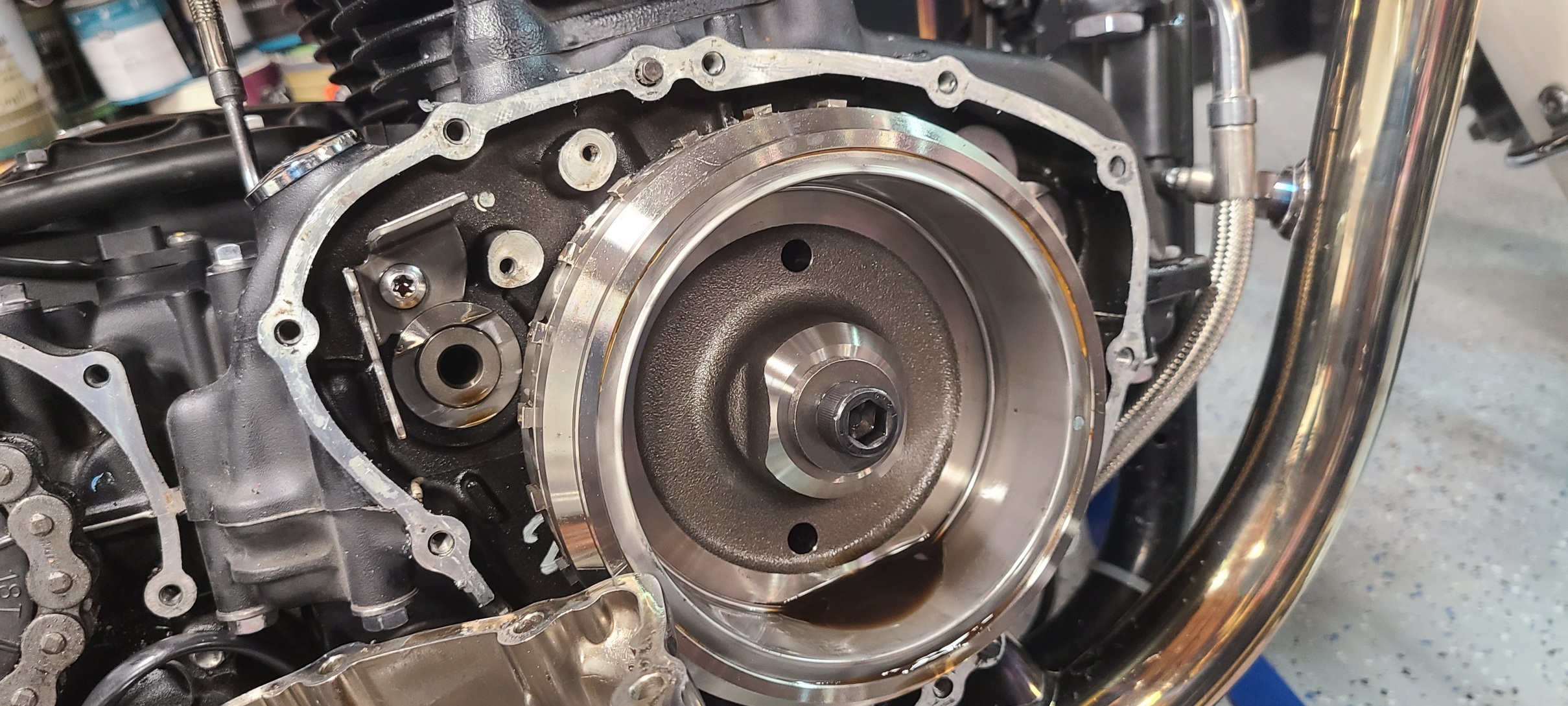

    I had to get a little violent and then one step closer.
  17. Guillermo salinas
    Guillermo salinas Well-Known Member
    Aug 17, 2019
    161
    Azusa

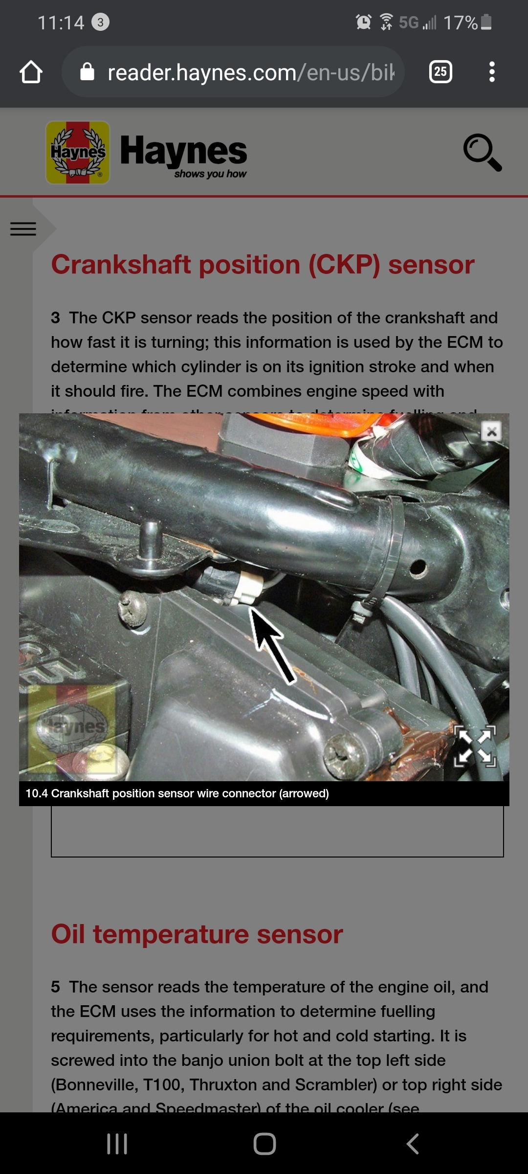

    Is that orange stuff rust? Do I need to address it and if so with what? Is this the cable? It's bent a little where the joint but doesn't look abnormal to me. I mean clear as how to test with the multimeter.
  18. Guillermo salinas
    Aug 17, 2019
    161
    Azusa
    Disregard I found this on the manual.

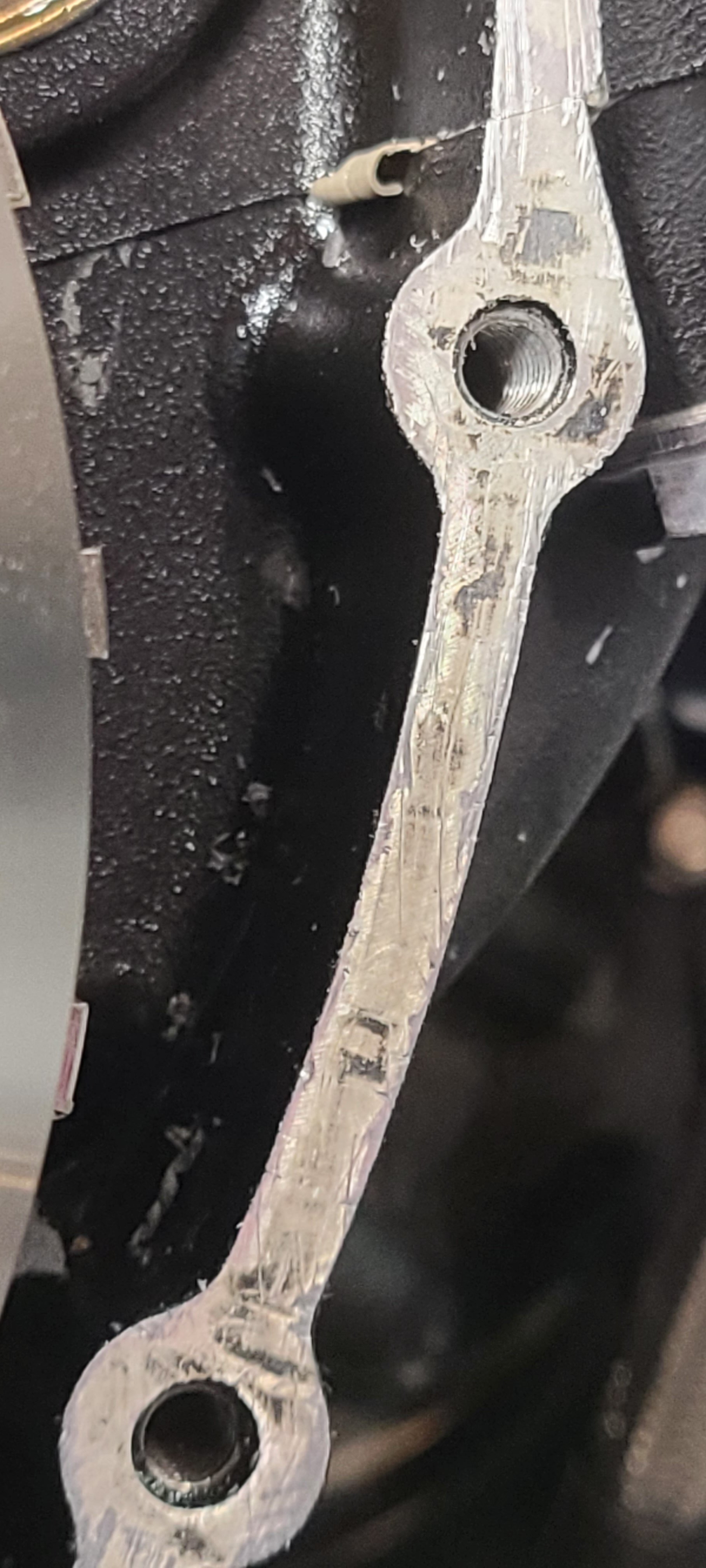

    I see no rust only a light film of oil.....
    Start with the sensor at the bottom and replace it. Leave the old one where it is (but disconnected) The gap between the sensor head and engine is .8mm.
    Then feed the new wire up parallel with the old until you plug it in and remove the old sensor completely.
    Visually check everything then bolt up. I assume you will have carefully cleaned the mating faces between the engine and the cover before applying a very thin smear of gasket sealant to the job. You can use it to hold the gasket in place on the small locating studs before fitting the cover itself.
    It’s all in the book!
