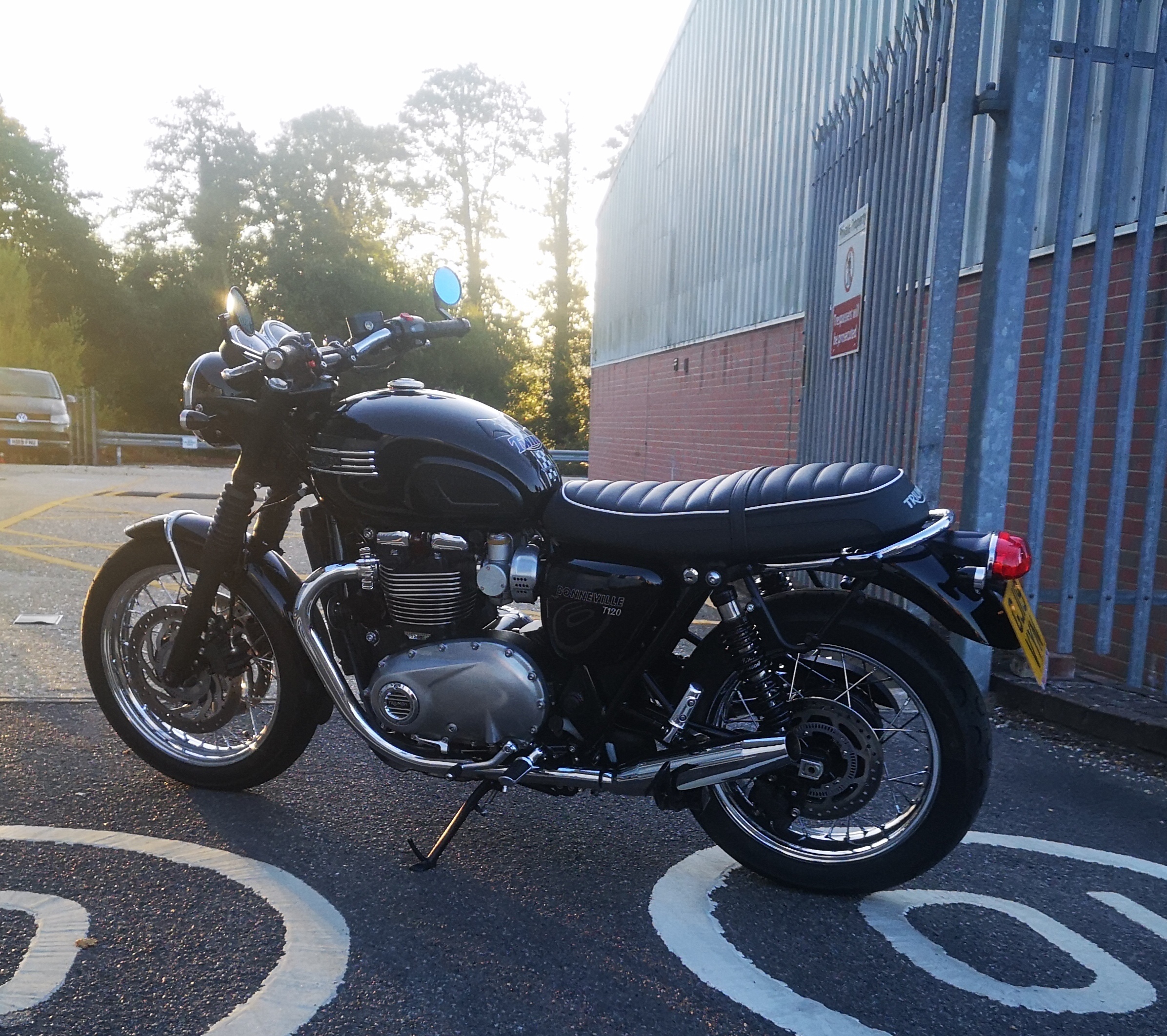

    Norman Hyde's do some decent parts for these. The Toga's look very much the original Bonneville pipes. A de-cat really takes the cork out of the bottle for sound, thoroughly recommend that mod. This is my T100 with NH Toga's, de-cat and Power Commander, it's a kit they sell.
    I think the OE silencers look like over-stuffed sausages.

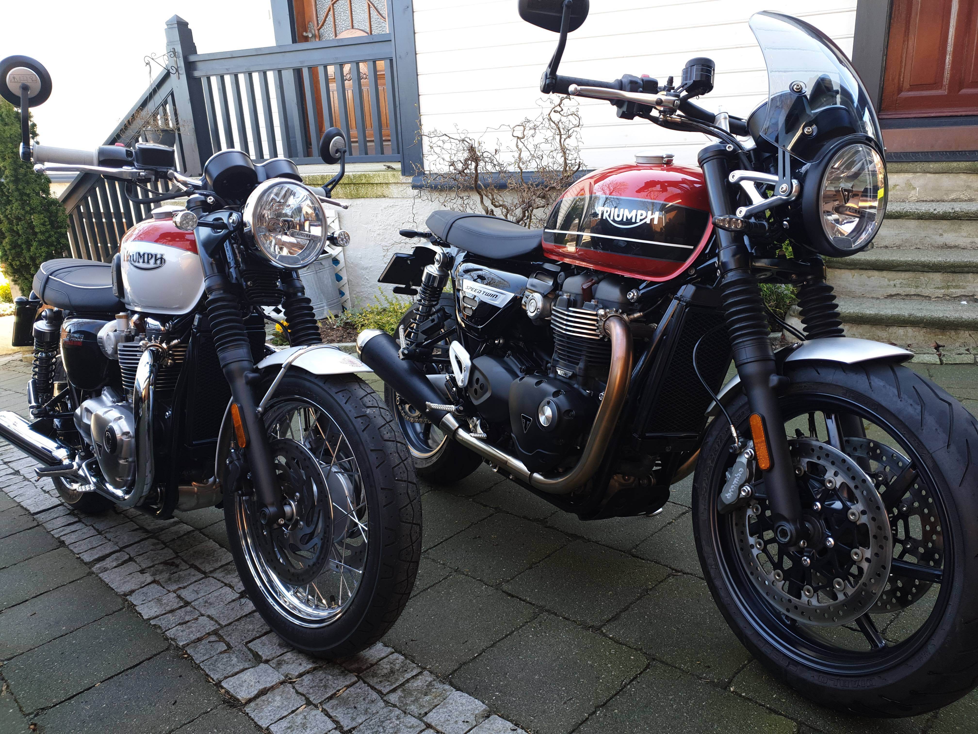

    What a lovely pair :heart_eyes:
