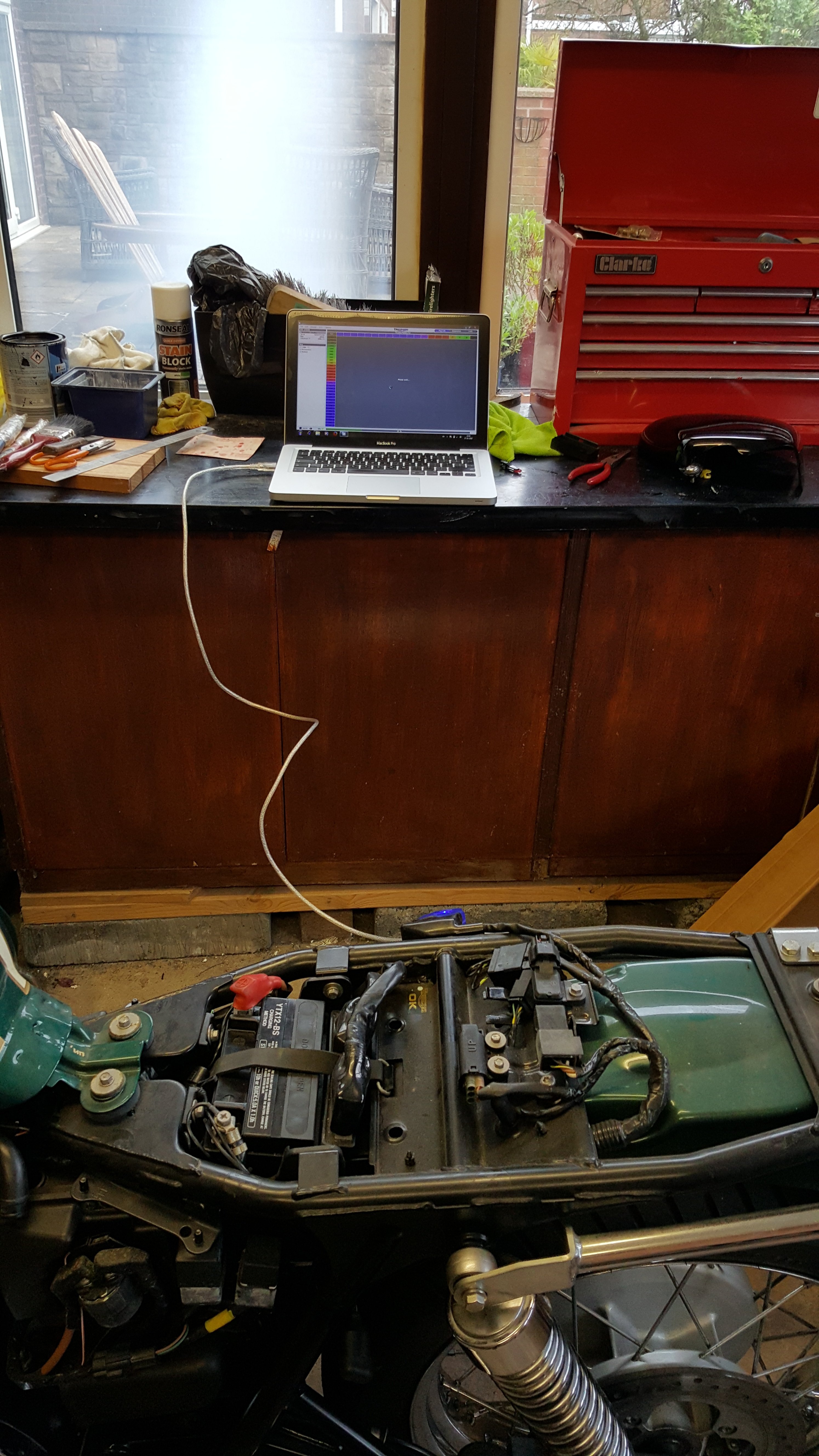

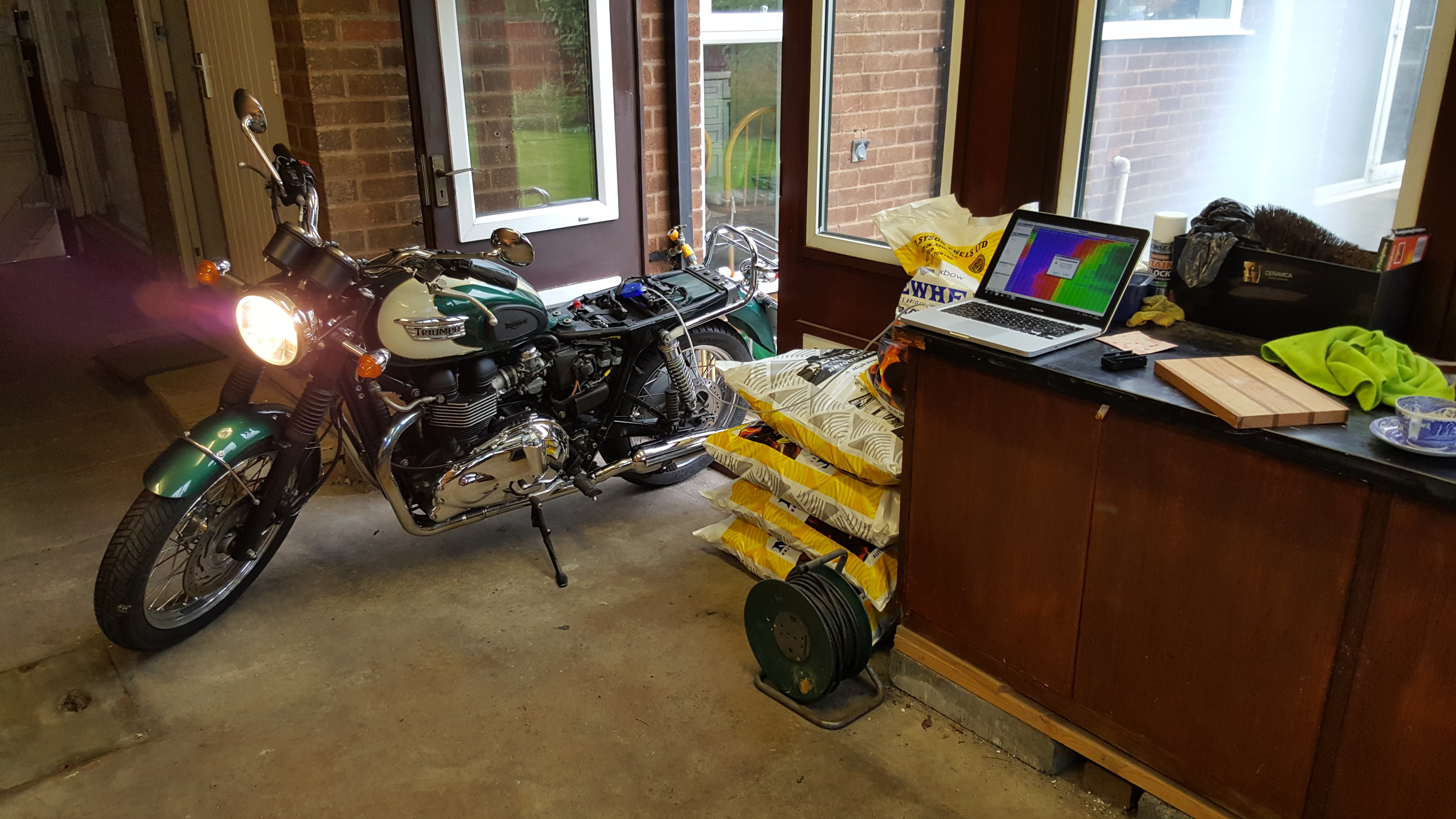

    Right, an update.
    My new silencers arrived on Tuesday and it only took 15 minutes a side to put them on :) Also the cable from fleabay to remap the ECU turned up as well.
    Having fitted the new bits I fired it up and my God are they better!!! It now sounds like a Triumph should do.
    Took it for a ride and it sounds glorious, however, as expected it pops and bangs when you roll off the throttle, scaring the horses and small children and making anyone who has served in our wonderful armed forces dive for cover shouting 'Incoming!!' :rolleyes:
    I couldn't do the re-map yesterday, I had a date, but first thing this morning I was out in the garage with the seat off.
    TuneECU worked as advertised with absolutely no drama. I read the existing map which was 20191 and saved it to the laptop. I then installed the new map 20334 and that was that.
    I put the fuses for the lights back in and did the TPS reset. She started from cold at the first press of the starter and ran the bike on idle for the recommended 20 minutes without touching the throttle.
    She runs like a dream, smooth and responsive and the power delivery is superb. With the 20334 map loaded there wasn't a single pop or bang on over-run or at any other throttle setting. In fact it's so smooth and pleasant to ride I'm not sure I'm going to bother with any other engine mods.
