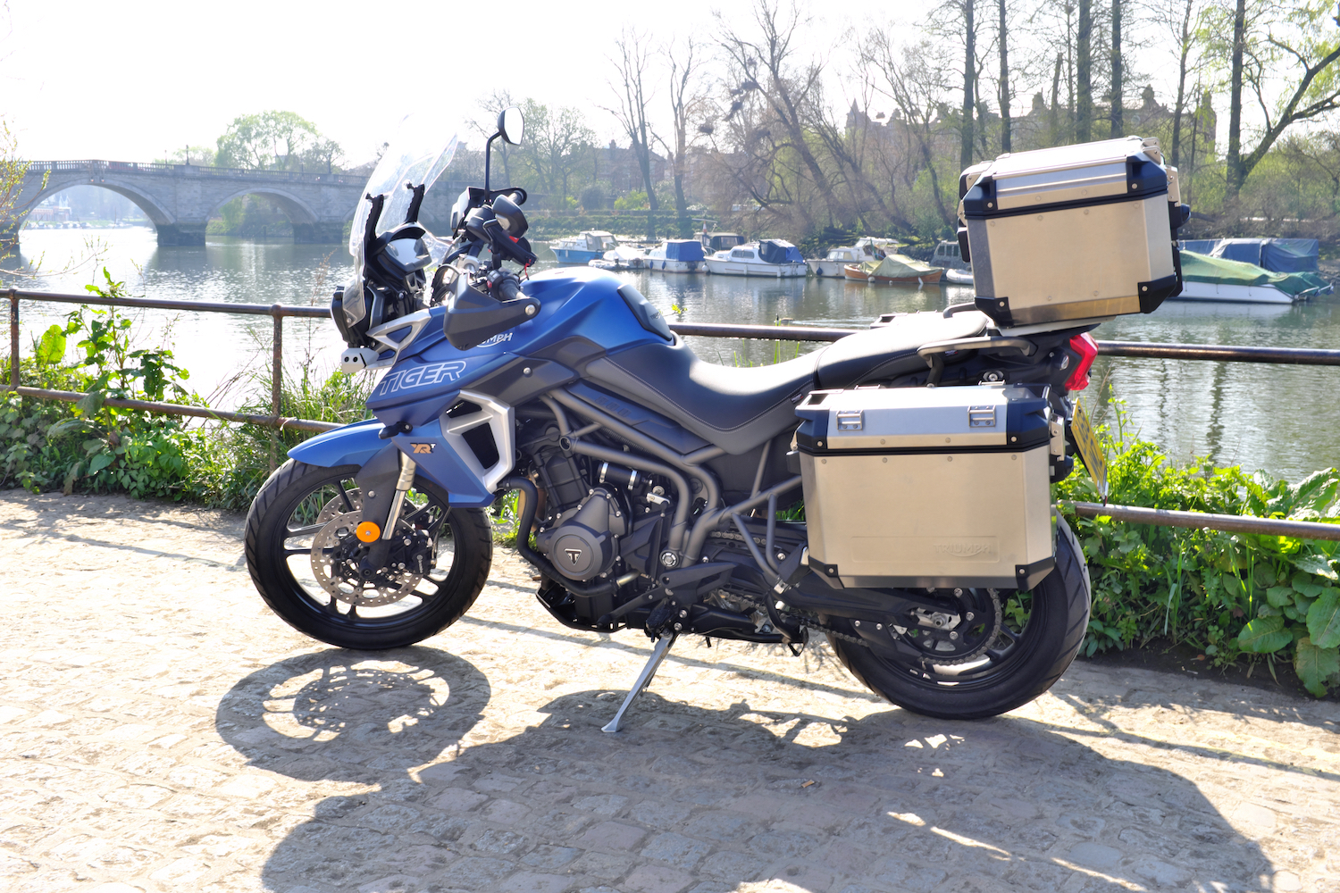

  12. kips39
    kips39 New Member
    Apr 30, 2018
    23
    London
    I use it mainly for commuting, West London to Central London, perfect for nipping in and out of traffic, also used it for long motorway trips and days out on country roads, it really is an all rounder, perfect for me, my partner loves it too, said it is far more comfortable than the Bonnie, plus it has heated seats which a godsend in winter!

  14. RussDC
    RussDC New Member
    Mar 31, 2019
    Long Island, NY
    Great looking bike!!!! How’s the wind buffering on longer highway commutes?
