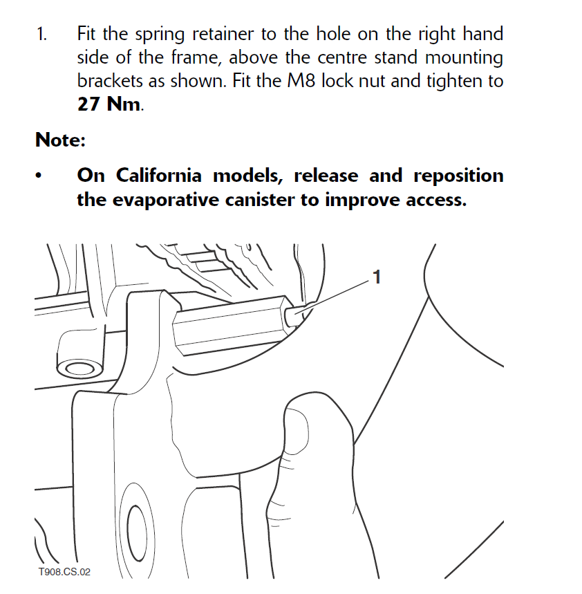

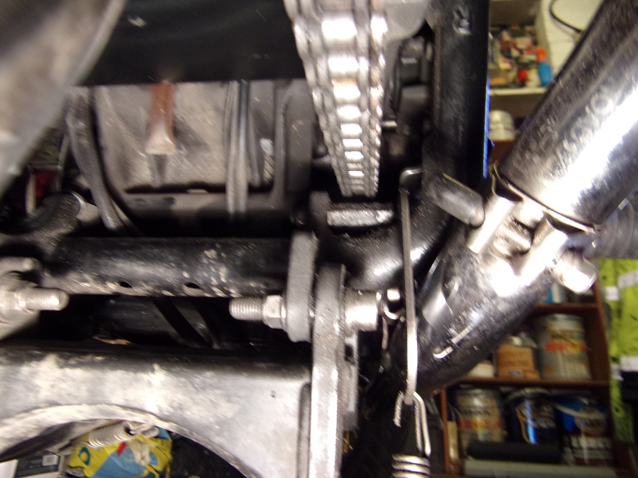

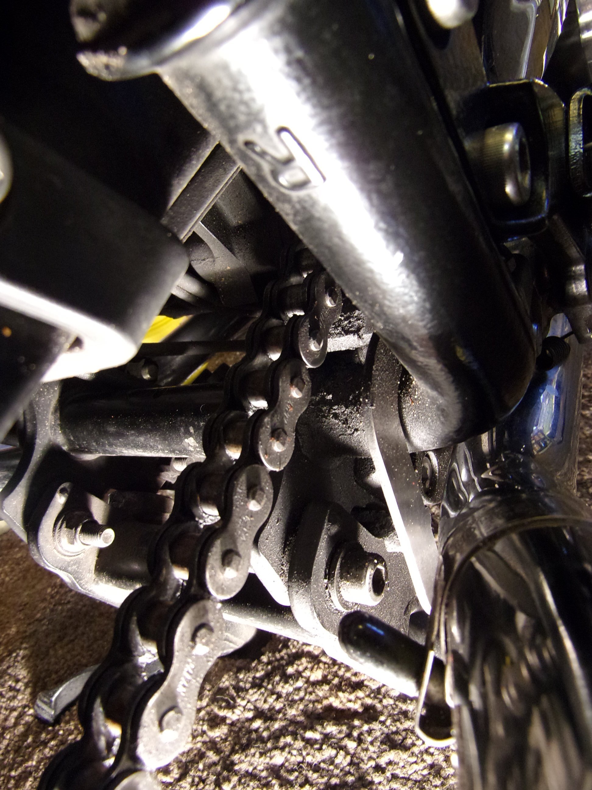

    You should have something like part 7 in the diagram below:
    The spring retainer goes into an existing mounting point in the frame, which is located appoximately behind the pivot point of the rear brake lever:
    I hope this helps.
