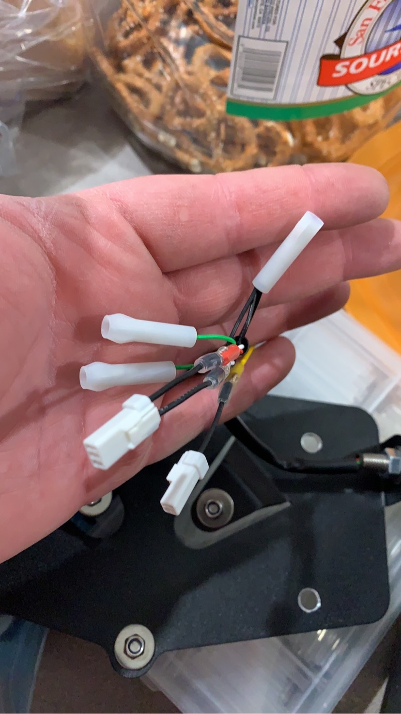

    So I wanted to clean up the rear fender area with a tail tidy. Not a ton of options but I ordered one. Went with Rizoma multi function lights, etc. However, there are no plug and play harnesses. I am not wanting to cut anything so we are building our own harness. We’ll see how it goes.
    If it works well, I will attach a parts list for anyone wanting to do the same.

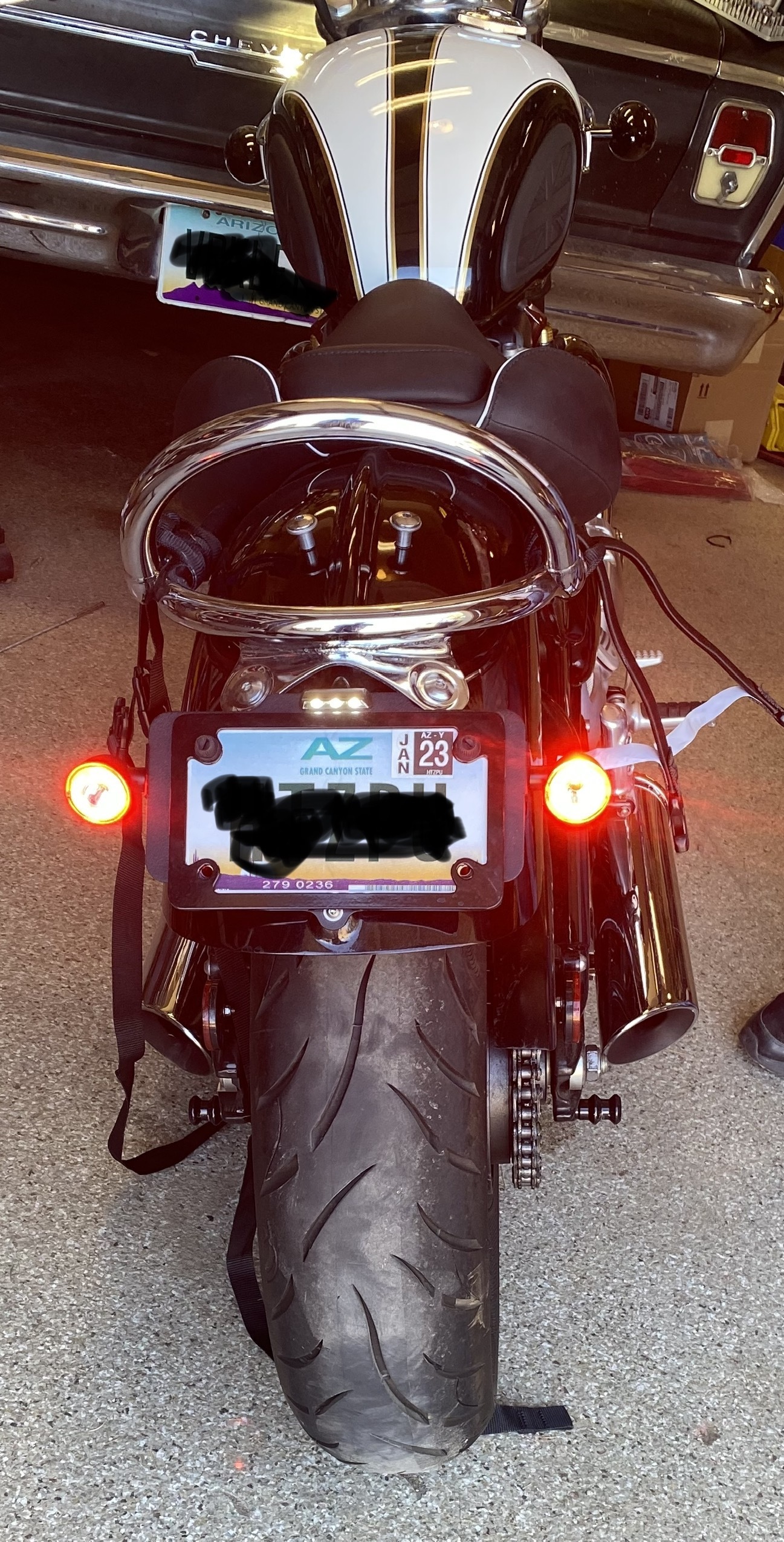

    Finally got around to finishing this....
    turned out nice. No cutting and looks very oem.

    Looking to do the exact same setup for my 2018 Triumph Speedmaster. I've already got the new rage license plate holder and the Kellerman Multifunction lights. But wondering how you covered up the hole left from the original tail assembly to make the area watertight? Also could you share a parts list or link for the connectors so I don't have splice the wires? Many thanks!
