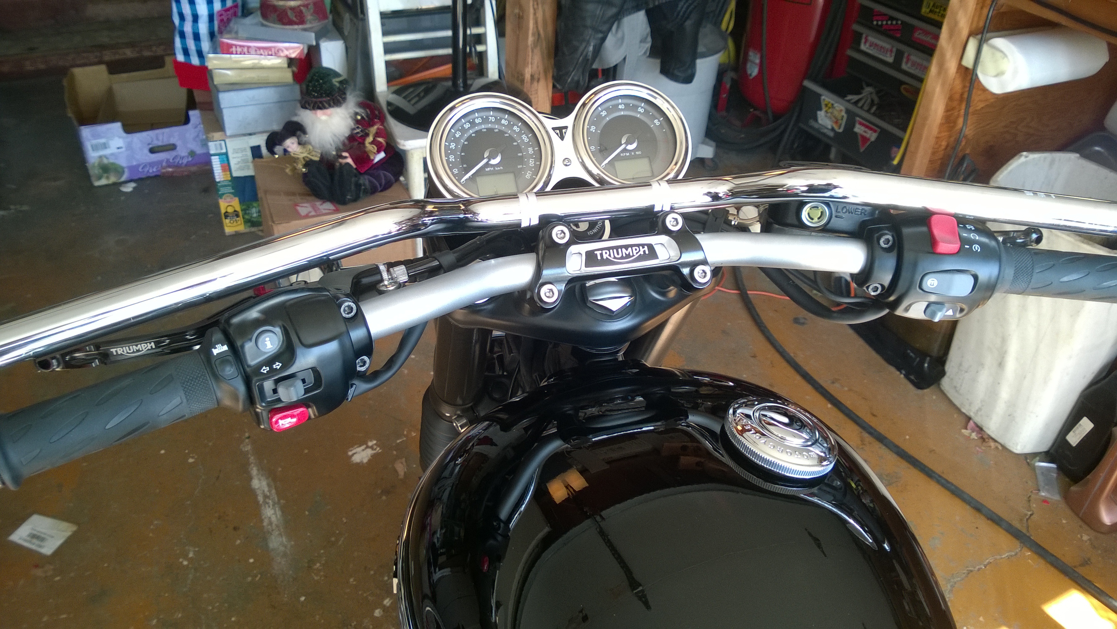

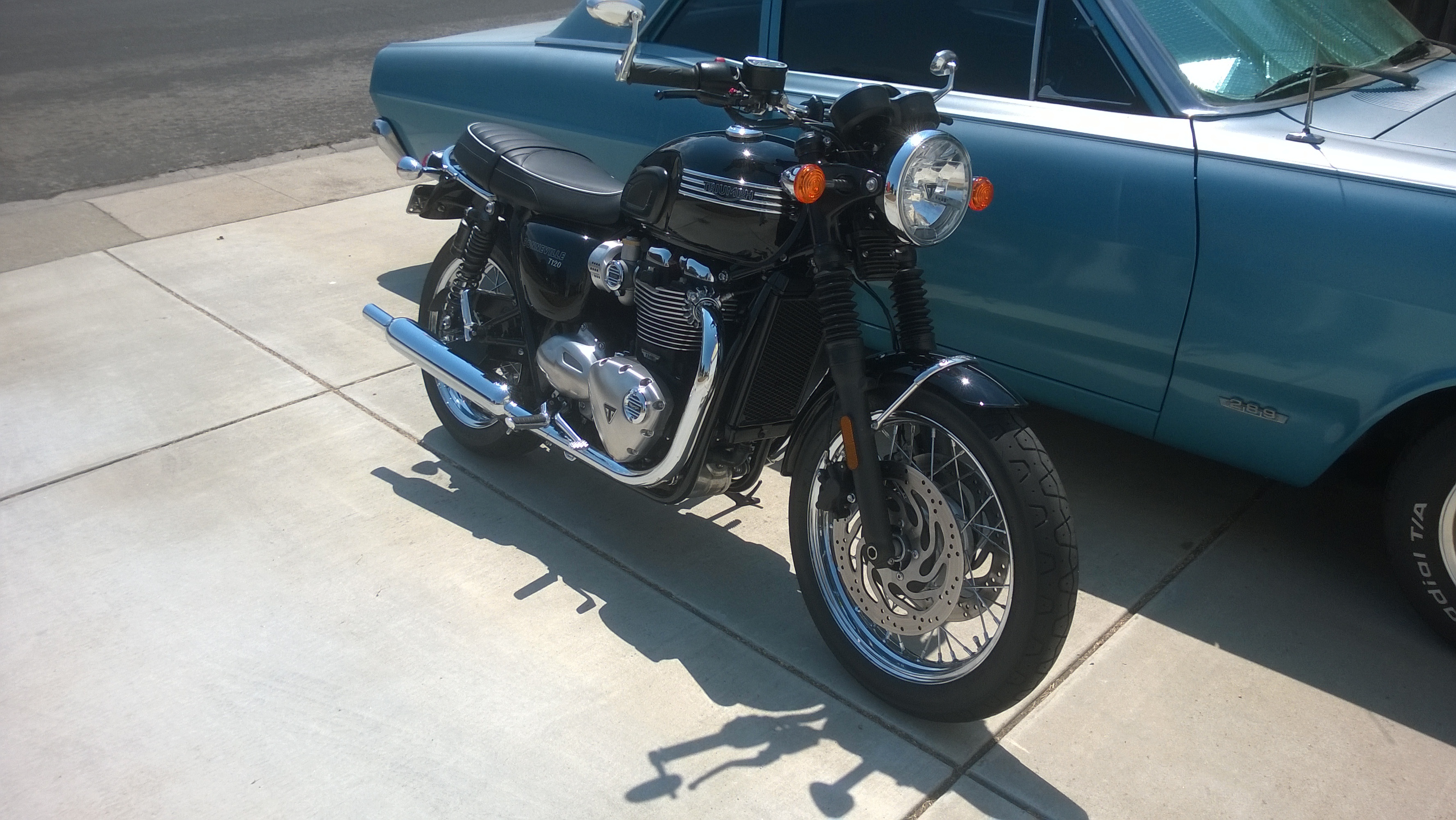

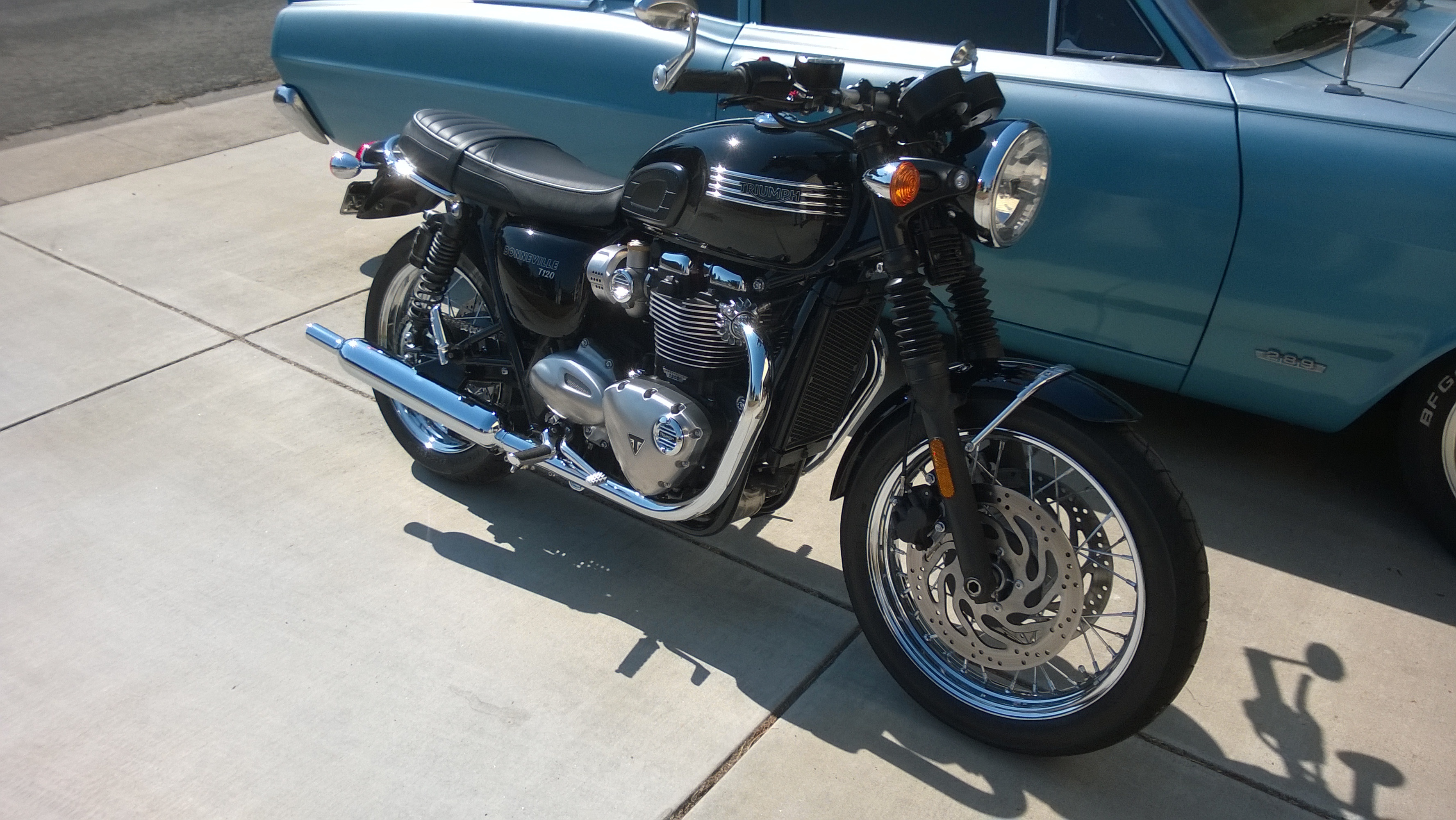

    Greetings!
    When I introduced myself a while back (the Mad Modifier) one of the replies expressed interest in seeing how the Bobber bars worked/fit on a Bonneville. I have attached some pics. All in all, a nice modification: it puts the bars about an inch lower and a little more forward. As far as I can tell the stock and Bobber bars have the exact same profile, with the Bobber again being lower with less pull back for a slightly more aggressive seating position. It has not decreased the all-day comfort (well, within limitations of my bony ass). I have a pretty strong "core" for an old fart, so it's a good match.
    I have attached some pictures - hopefully I did it correctly!
    Thanks! Oh, and it was a nice thing that the Bobber and Bonnie bars have all the same cutouts and inserts - made it a breeze for retaining grip heaters, switch gear locations, etc.

    I like it! I just bought a Street Cup last month and am going to change out the clubman bars for more traditional bars. I was actually thinking a "straight" bar from the bobber or a tracker bar similar to your old bars or the Street Twin. The problem with the Street Twin bars are they are 7/8" (SAE) and I need a 1" diameter bar. Do you know the diameter of the Bobber bar?
  6. Howellerman
    Howellerman Well-Known Member
    Oct 7, 2017
    19
    53
    Santa Clara, CA, USA
    Just measured the Bobber bars - 1".
