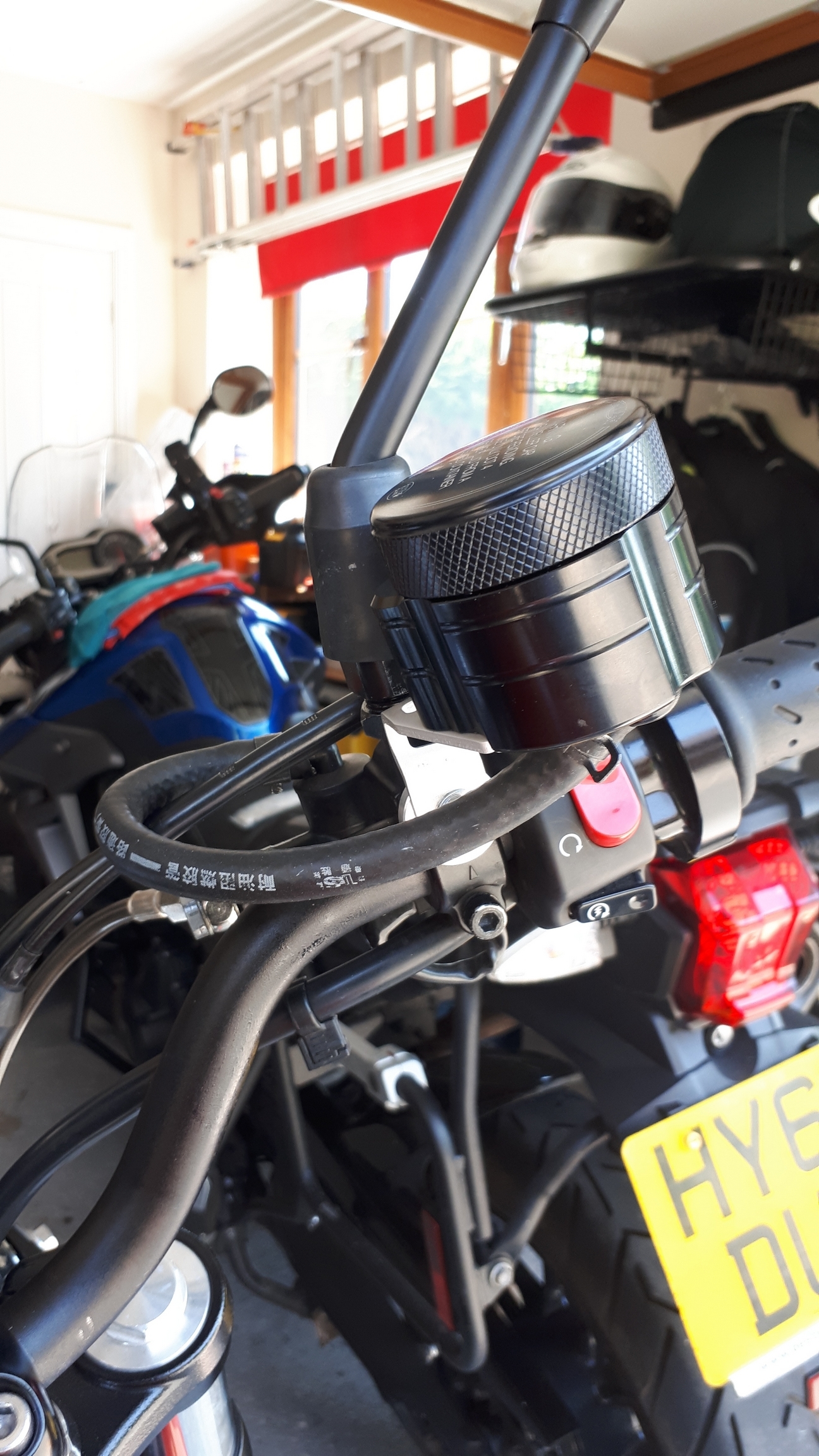

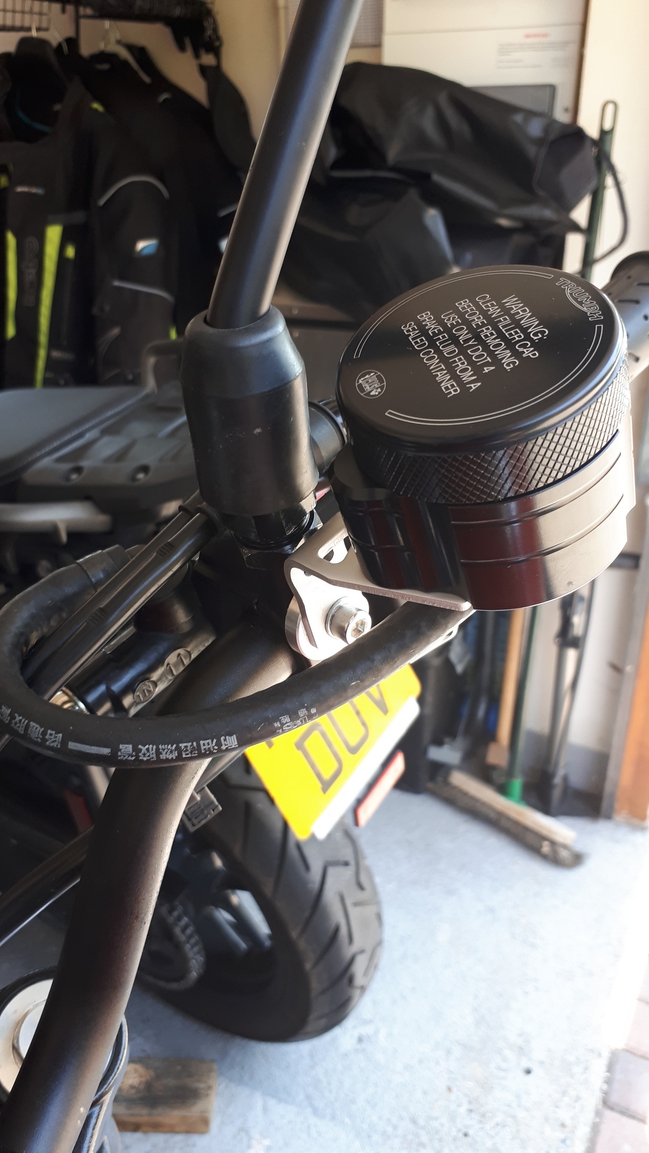

    Fitted mine today.

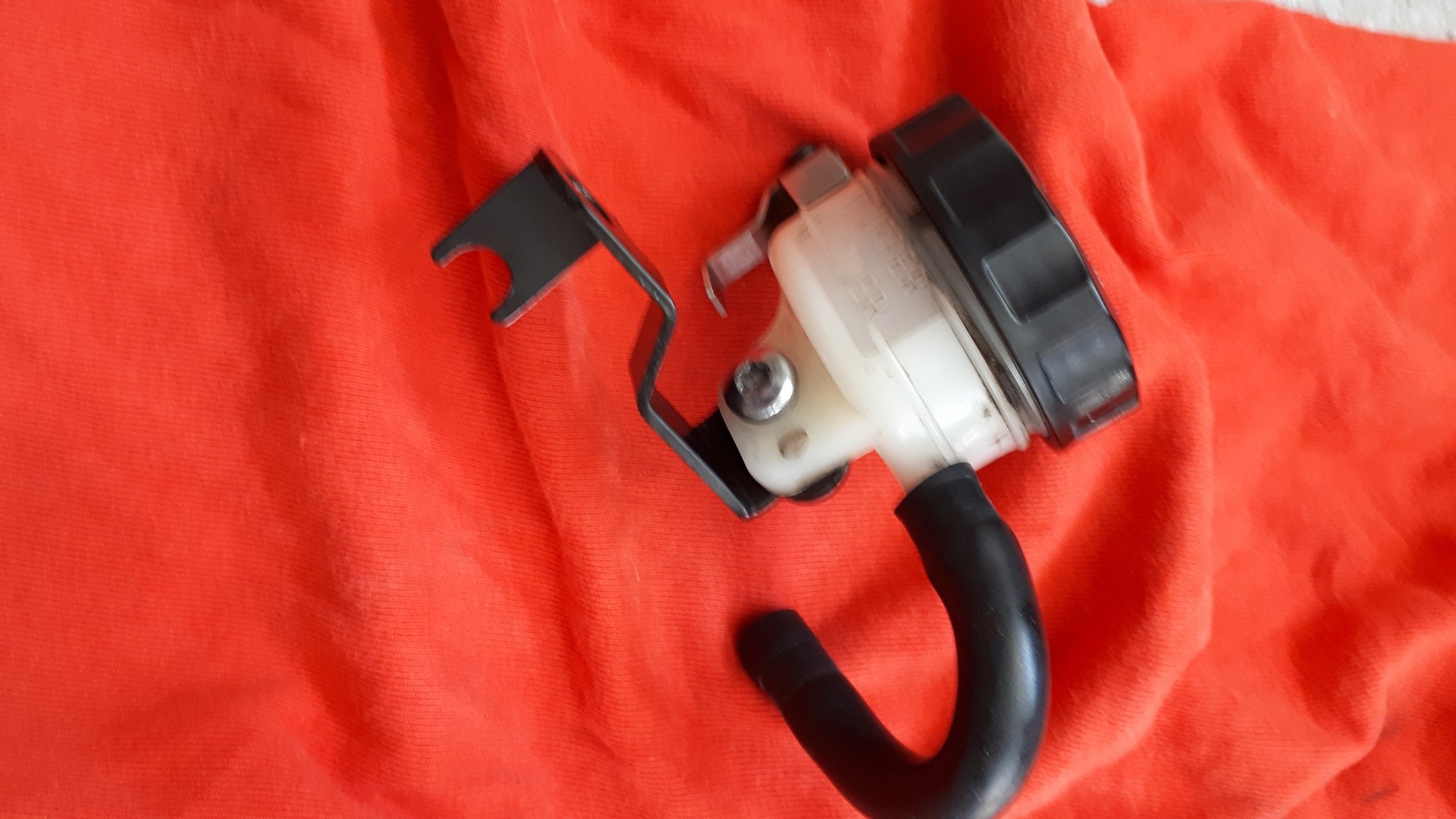

    Had to bend the bracket slightly but fitted it in the same position as the old one with one of the hex-head bolts holding the RH switch gear on. If you have stock mirrors like me, you will need a spacer to avoid fouling the nut for the mirror and a longer hex bolt. This is my temporary one for now but it works just fine. The existing rubber hose from the old reservoir is too short so you will also need a longer one. :cool:
    The old "Pot of p*ss" style reservoir!
