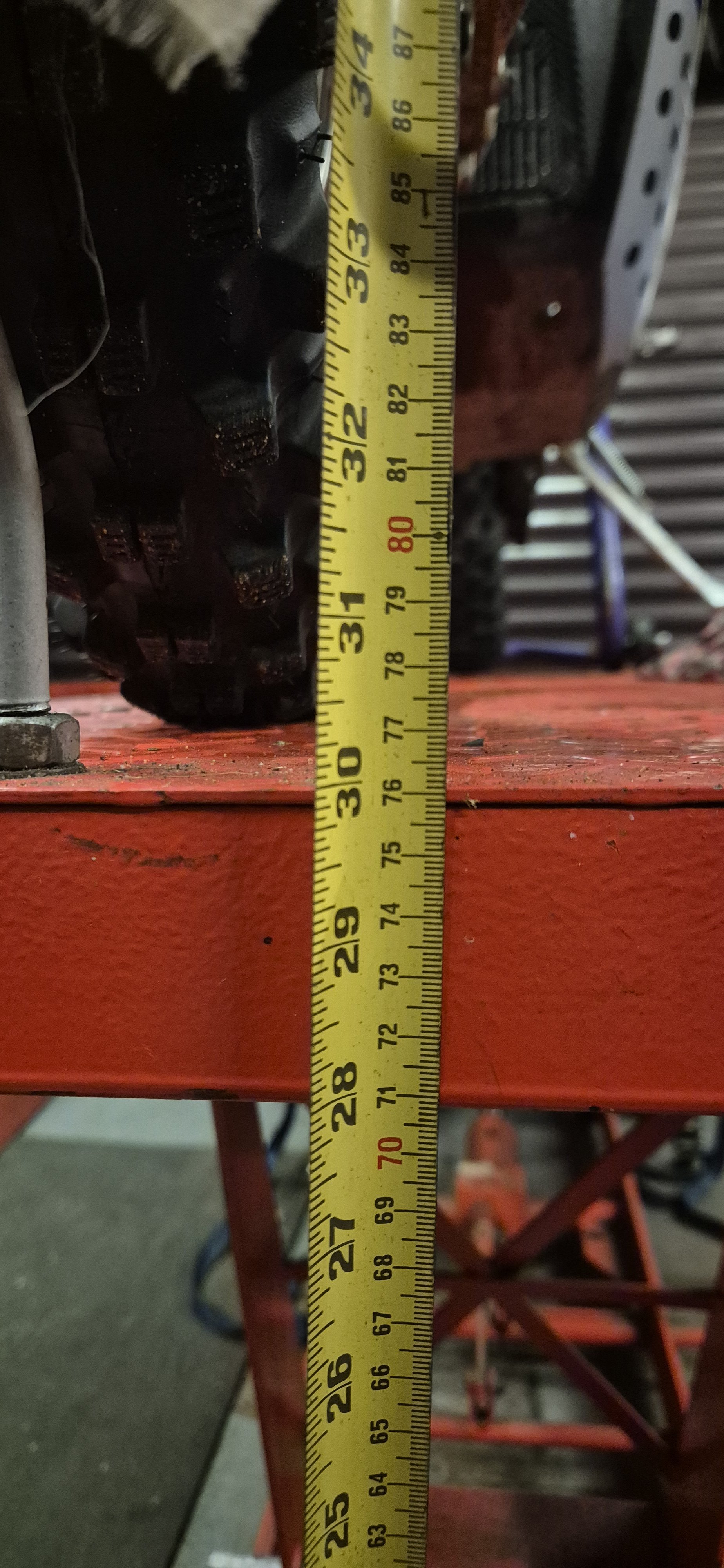

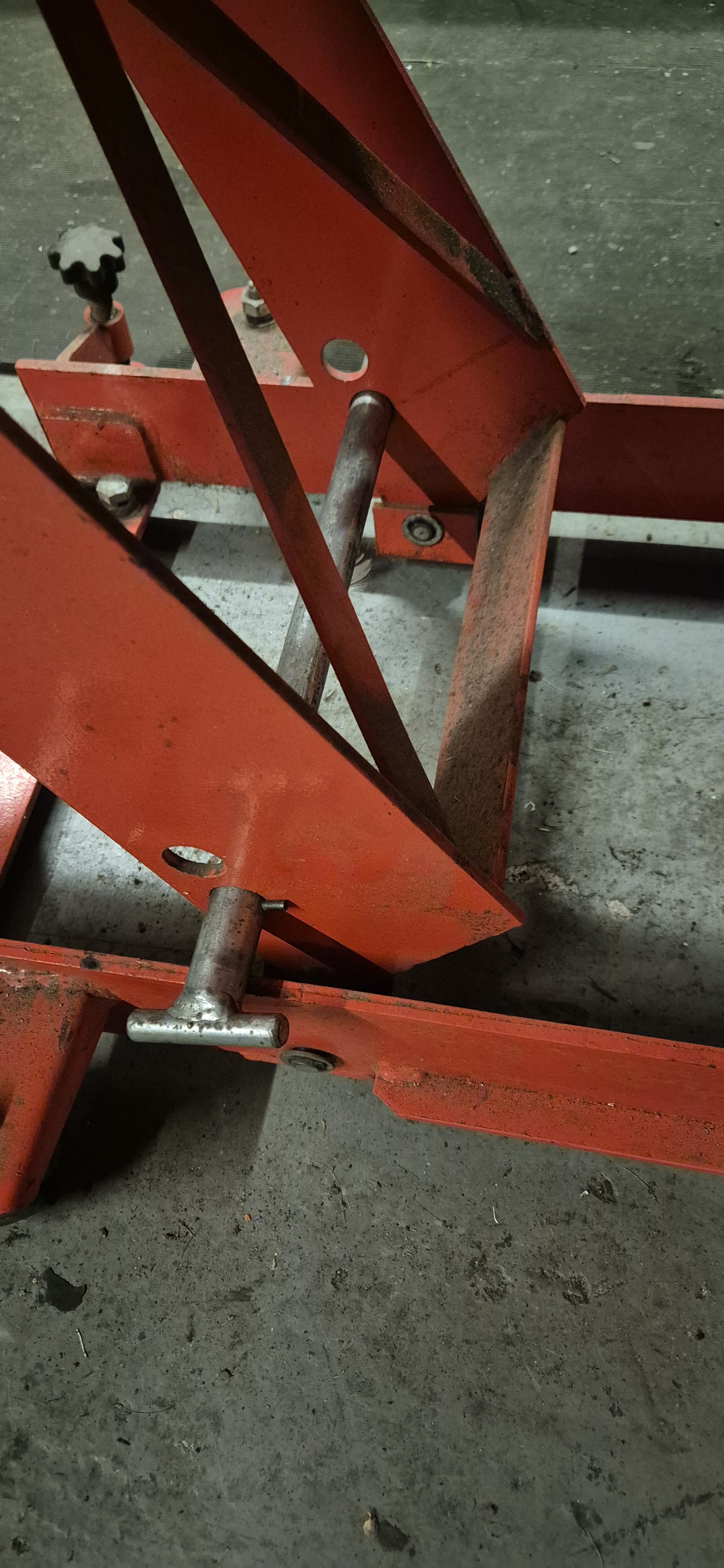

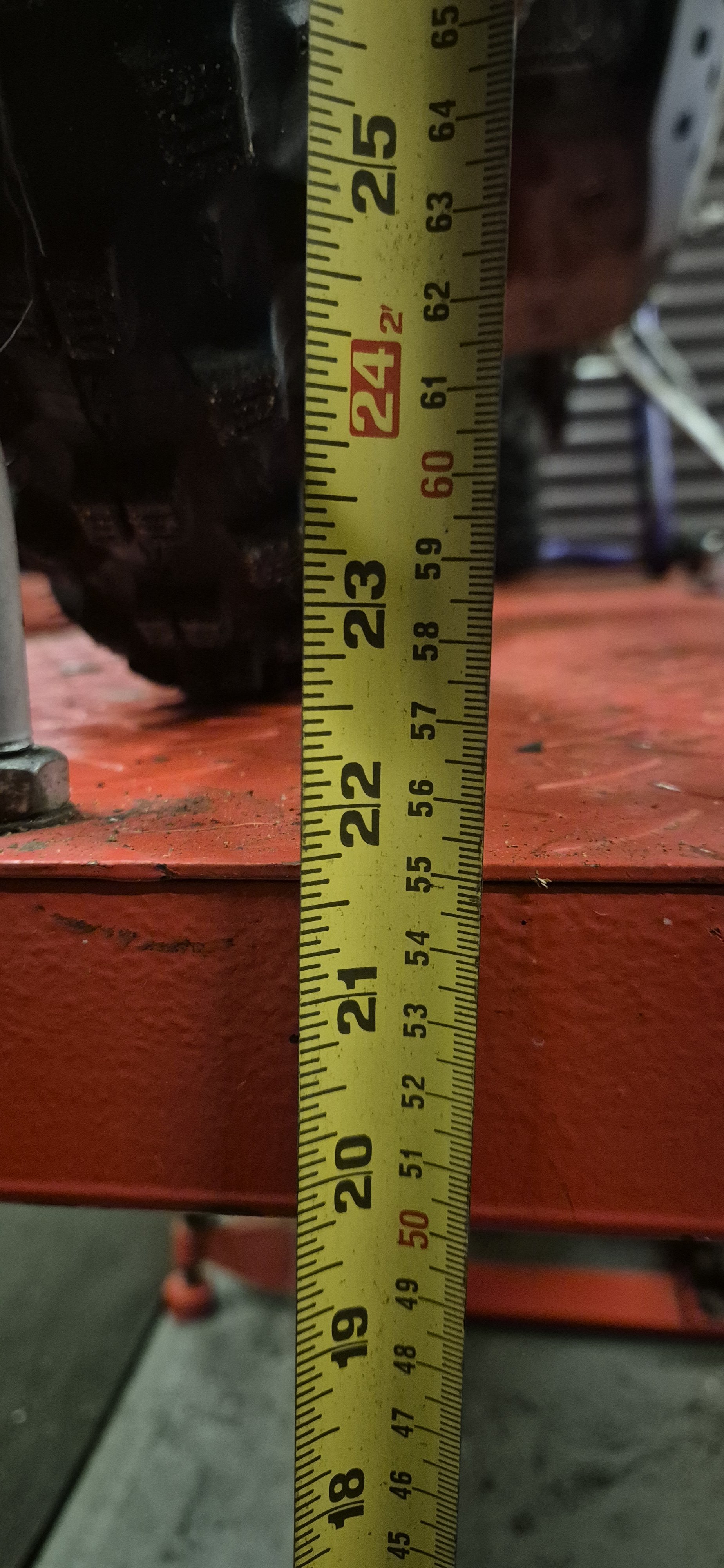

    Here you go Joe and all.
    Minimum height, there is a generous ramp to get it on.
    Mid height, 1st pin hole so not hydraulic dependent.
    2nd pin height i.e. highest setting.

    Table length and width dimensions, let me know if you need anything further?
    Although currently in the picture on a paddock stand, you can see, hopefully, how generous the width is so that you can use it in conjunction with the side stand if desired i.e. handy for doing right hand clutches on a left hand sidestand.

    So in effect @joe mc donald and referring to the pictures above, on it's side it would occupy a footprint of 2200mm long x 165mm wide.
    I don't think that's too bad is it, even if space is limited?
    If I was tilting it up 90⁰, I would come up with a simple strapping idea to lock the table down first BEFORE moving it to avoid a finger trapper situation. Gravity holds the table down, lifting it by hand only lifts the table top platform, something very much to be aware of!
