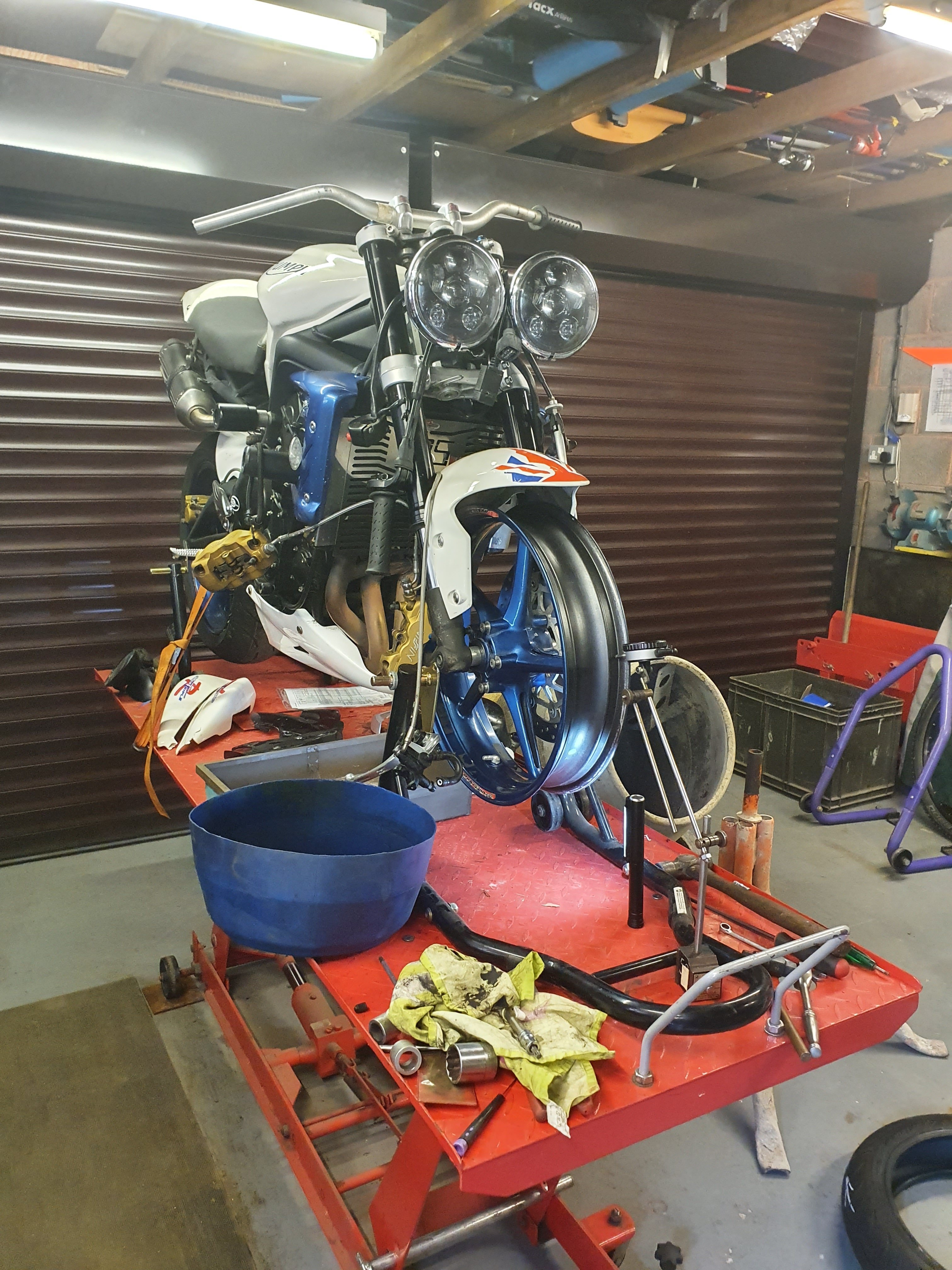

    I have a bench lift, they do make life easier.,
    Especially if you are removing wheels as you can remove a plate to drop the wheel without removing the mud guards so to speak. Oil changes are a sinch ,
    Down side, they do take up space. But if you have space they are well handy. For me , the Triumph is easy. But the 1400 GTR is a lump of a bike and getting it on the bench backwards is a two man job you have to have your wits about you. I stand on a box next to the bench to put her on the centre stand. Smaller bikes are far easier. I wouldn't want to go back to doing jobs at low level again .

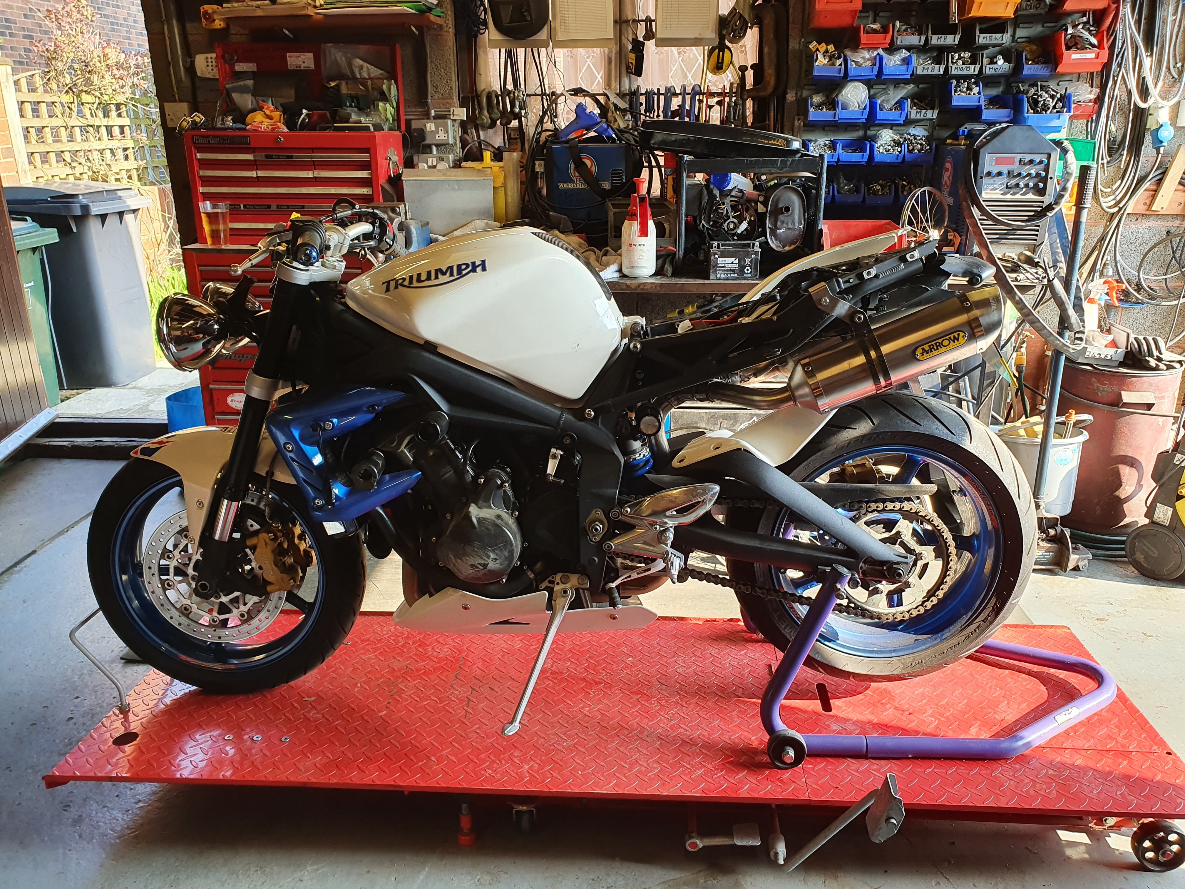

    The table could be parked on its side when not in use if space really is an issue.
    They do make life so much easier and offer somewhere for disassembled parts and tools close at hand.

  15. Eldon
    Eldon Crème de la Crème
    9,528
    They are heavy and quite a serious x2 man lift to carry, but to just turn it 90⁰ vertical and latch it to the wall with a chain or rope, it is quite doable on your own.
    A bike can sit on the table on the lowest setting on it's sidestand if need be.
    Don't buy the smaller platform one as that then may not be possible.
