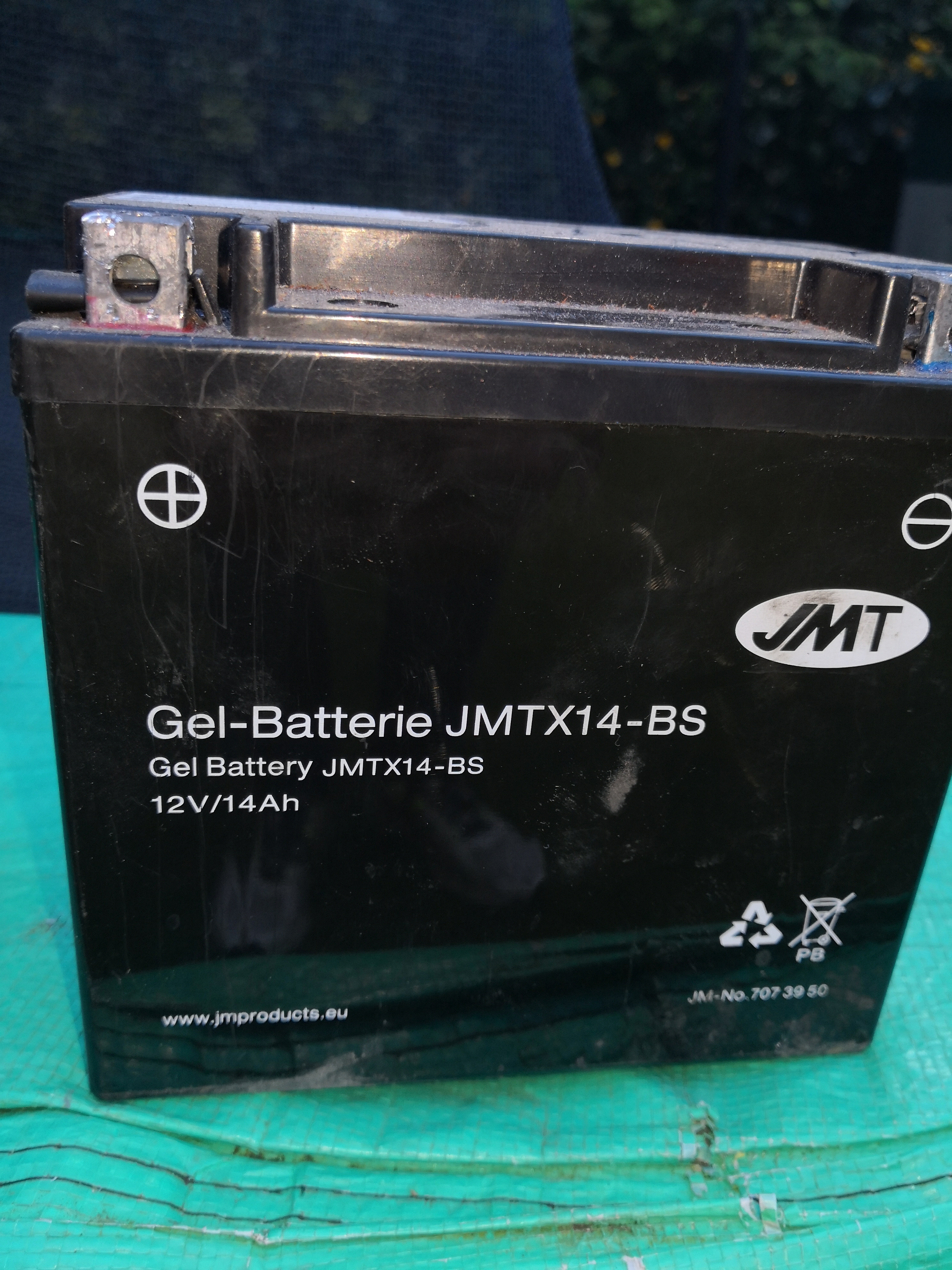

  14. DanielB
    DanielB Noble Member
    Jan 13, 2019
    887
    393
    Abingdon, Oxfordshire
    Photo attached.
    I'm assuming this isn't original.
    I do t mind NOT replacing like for like...just want to replace with a correct one.
    I am a little wary of blowing CPUs or anything sensitive...

  16. freck
    freck Elite Member
    May 4, 2017
    1,721
    Preston, Lancs, UK
    That is a 14Ah, an upgrade from the original 12Ah so you can go ahead and get one the same spec.
    Don’t worry about blowing anything, as long as it’s a 12V battery you’ll be fine. As previously mentioned, the ‘12’ or ‘14’ denotes its capacity, as in how long it’ll last for a given load; 14 being more than 12 means it’s got more capacity.
    The battery will only give out what it’s being asked for by the bikes systems, so won’t fry anything.
