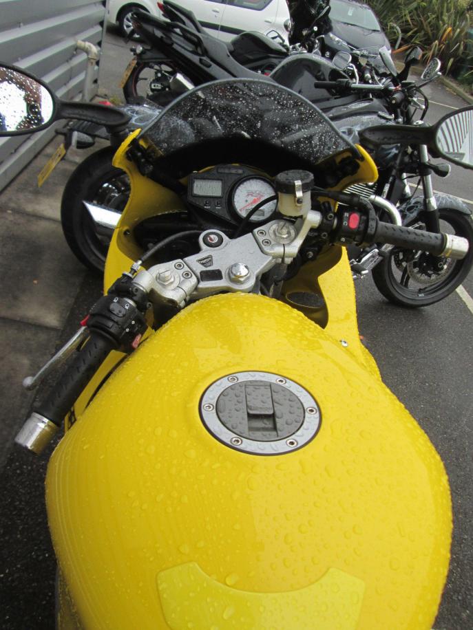

    I am looking at either getting a 2002 Daytona which has 35.000 Miles in a nice colour, or a 2003 Sprint RS with only 23.000 Miles same price (but in yellow!)
    So firstly which One would you choose, secondly I have a bad neck/back, and the Triumph dealer in Plymouth has told me I can just get 2 risers which will bolt into place between the yolk and the clip on's already on the bike? I am not a tech head when it comes to this, so is it that easy? 4 bolts, lift them up, drop in the 2 risers blocks, and bolt back together?

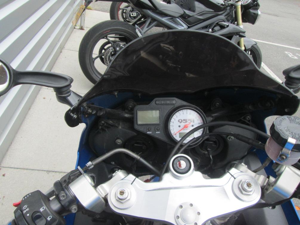

    looking at the bike pics again, I think its going to be more of a job then I first thought! as if I left the bars up, there wont be enough room to fit the bars back on with the block risers? (Pic attached)

    How much they want for the bikes?
    Depends on how much you you need to lift the bars. another way around this would be to use a T509 Speed Triple top yoke and bars as long as you can clear the faring.

    the riser blocks are only about an inch or so. I am in another forum where most of the guys with sprints have fitted them to increase the comfort level. Some have had to undo the fork clamps and drop the yokes down 5 mm or so but not all so I guess it depends on how yours are set up originally. I had a set of these on my 998 Sprint and they do work, but I did not like the angle of the bars so bought a converter for standard tubular bars.
    I would say as you have a bad neck and back, the daytona probably is not for you tbh

    The picture here is the Daytona I went to see today, but not the One I have purchased (waiting for delivery) it has had a lift of the bars, and suited me really well, so can you tell what was done? and where can I get what ever was done here for mine? is it an easy job to fit, or a garage job? (I have little tools, and even less knowledge) $_57.jpg
