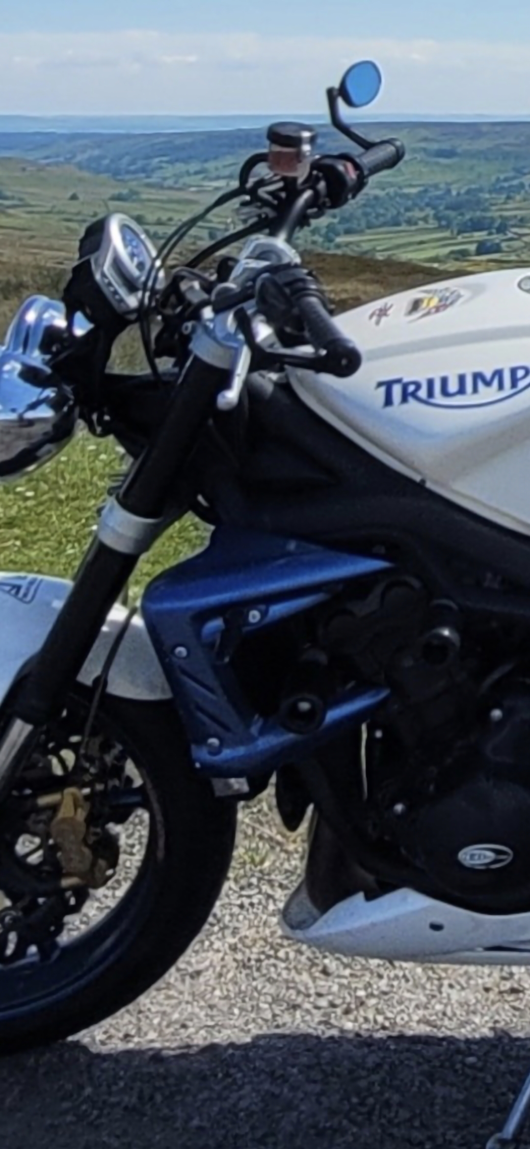

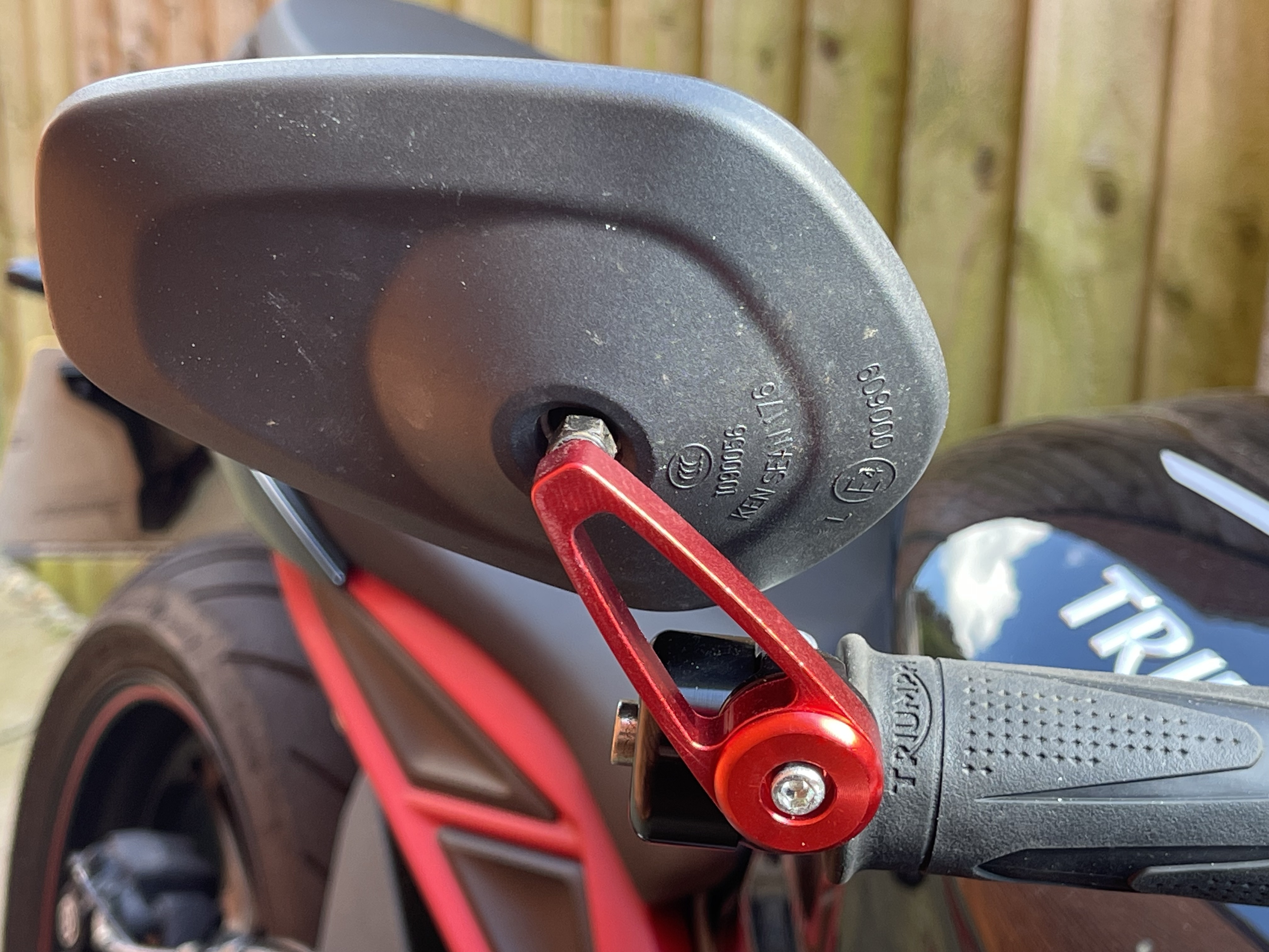

    On my Striple I have these.
    I didn’t like the mirrors that came with them so used the OE mirrors that were on the bar stalks, both M6 thread.
    They were under a tenner when I bought them but today they are still under £15.

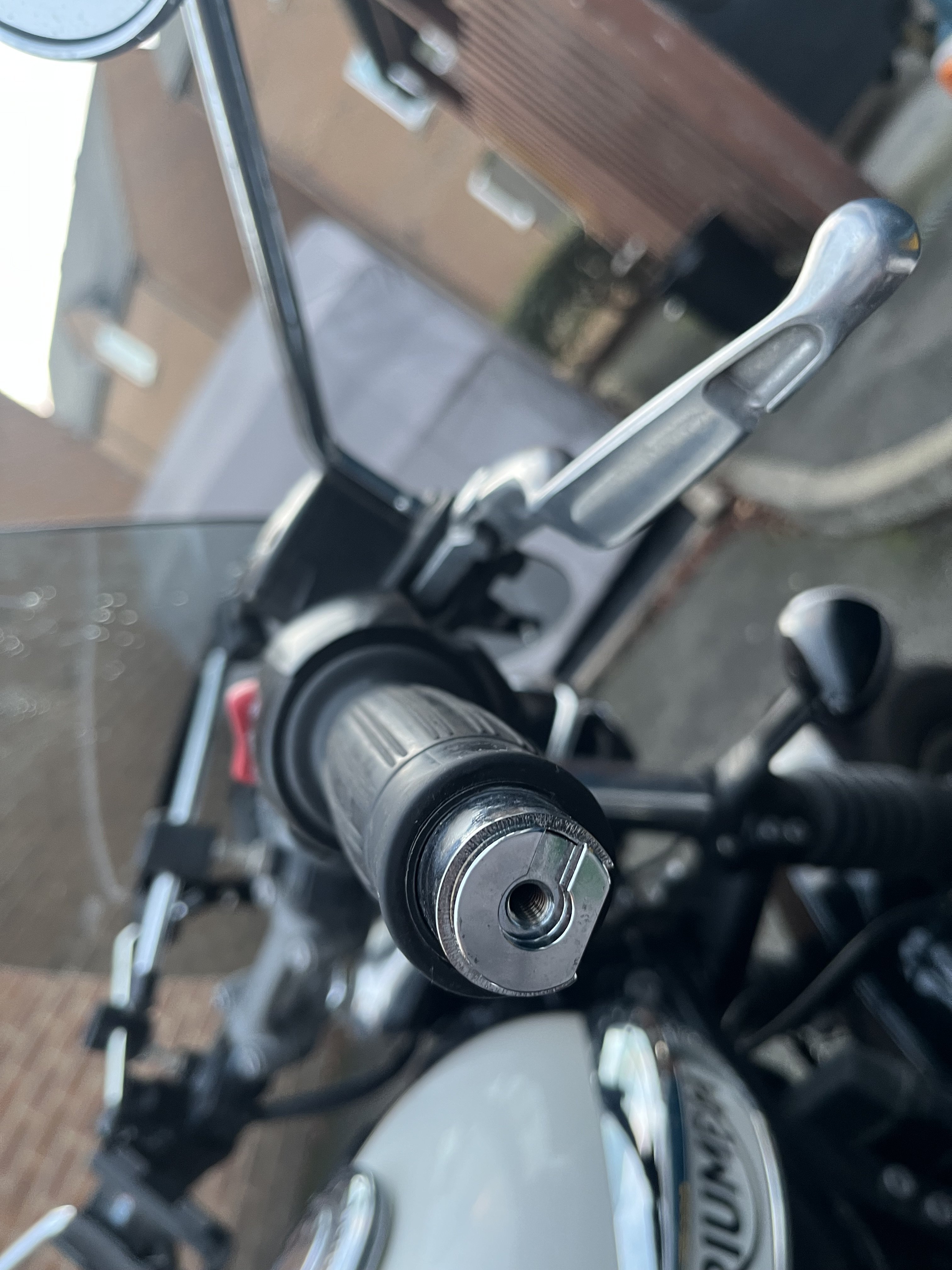

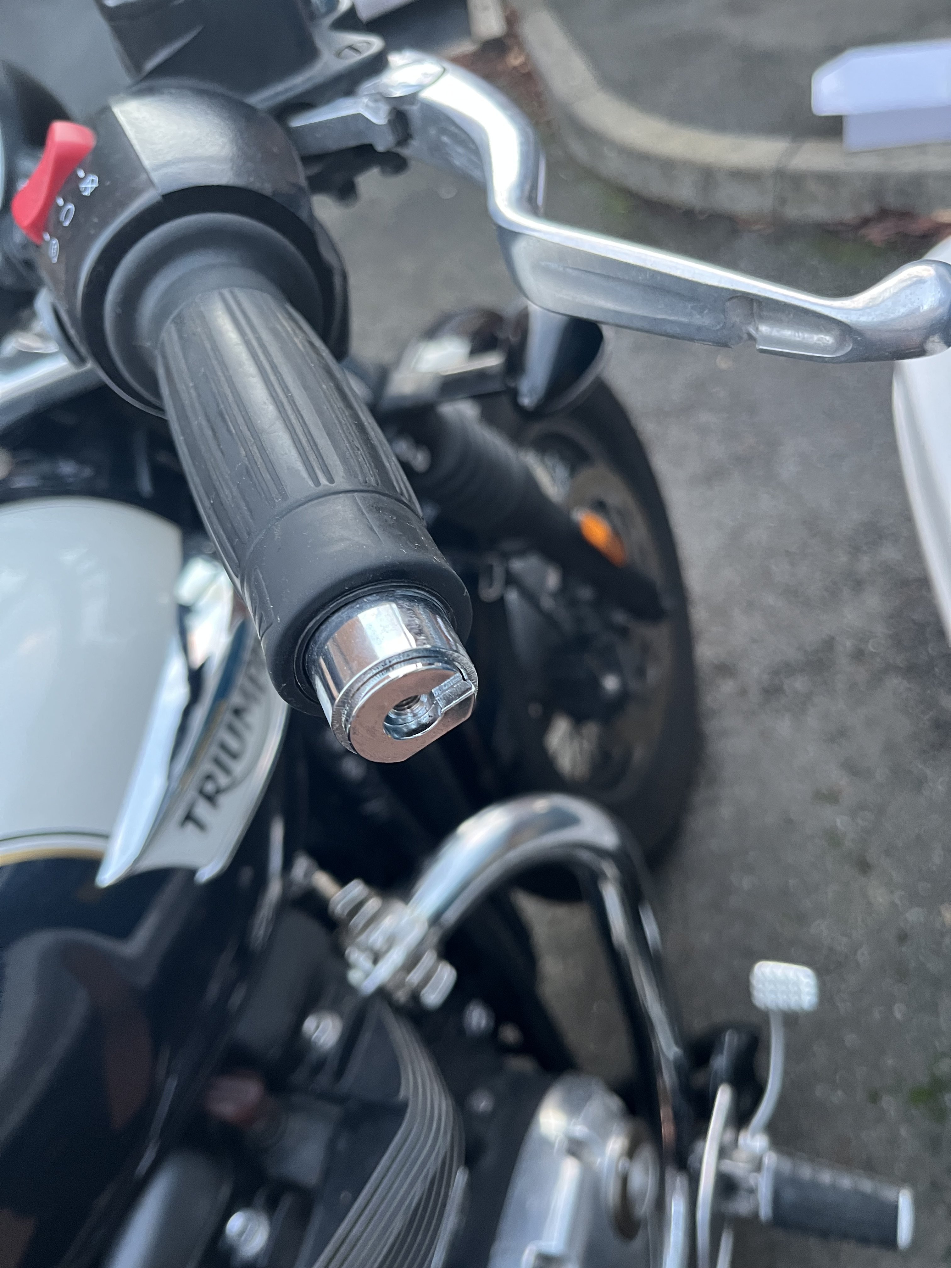

    They would still look alright on mine, maybe black instead of red. I am. wondering whether it was designed to be able to have them. The angle of the handlebars. I took the end of with the Alan key but then what do you do? how do you get the inserts out the end of the handlebar? I thought it would be a quick swap but its not proving to be so

    You don’t. If your bars are like mine you will have just unscrewed an 8mm Allen bolt to remove the end cap which should reveal a short length of handlebar protruding from the end of the grip. It is on this expose end of the handlebar that the mirrors are clamped. Having done so you can refit the bar end. You may need a longer Allen screw. The bar end inserts that come with the mirrors are not used.

    what if my handlebars are not like yours? Would you know how to get the inserts out?

    You have taken the cap of by unscrewing an Allen screw. Now please post a photo of the bar end, including the insert.

    hope this helps? I need to find a pair of mirrors that are adjustable as I offered the ones I bought up to see what they look like and couldn’t adjust them

    In each of the photos you can clearly see the end of the bars about 20mm wide. The mirrors I have clamp onto that so the insert is only used to screw the bar end caps on. Take care that the right hand mirror clamp doesn’t interfere with the action of the twist grip. Check after fitting the clamp and check again after fitting the bar end caps.
    When tightening the bar clamp screw take care to tighten it only enough to prevent the clamp rotating around the bar otherwise you may damage the clamp. Don’t ask how I know but I now have four mirrors (because I chose to use the Triumph ones) looking for a good home. o_O
