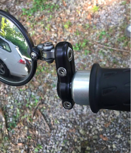

    I have a set of the CRG's on my T120. And I can not recommend them enough, they are tremendous. Fit and finish are great. The image is crystal clear. And they look great. No trouble fitting them. The bars have a threaded block in them, unscrew the cap. Make sure you buy the bushing kit with a longer screw. Mount the bushing - I fit the cover back over the exposed end but I have seen guys do other things. Screw it down I used a little locktite.
    It took 10 minutes and I mounted one backwards and had to redo it, '

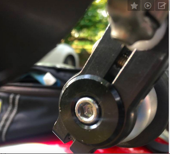

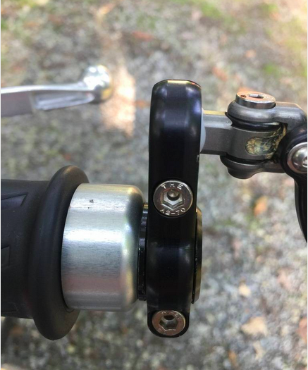

    I have a 2017 T120. Yes the bars are not quite solid there is an insert that the silver cap screws into. I took that cap off and got a kit with a longer screw and a set of adapters from CRG. Replaced the screw that was on the bike with a longer screw - put the silver cap on then the adapter. I believe it was a the CRG Billet internal adapter. I got it from Revzilla they are local to me and have everything in stock. I know you can find elsewhere. Here is the linkhttps://www.revzilla.com/motorcycle/crg-billet-internal-adapter-for-crg-bar-end-mirror
    I cut off the extension which goes into the handlebar and put it all together.
    I am very happy with the results. i know some guys were using all sorts of things and even breaking out the inserts that were in the handlebar. I don't like to destroy components on the bike if I can do it without. Turned out fantastic!
