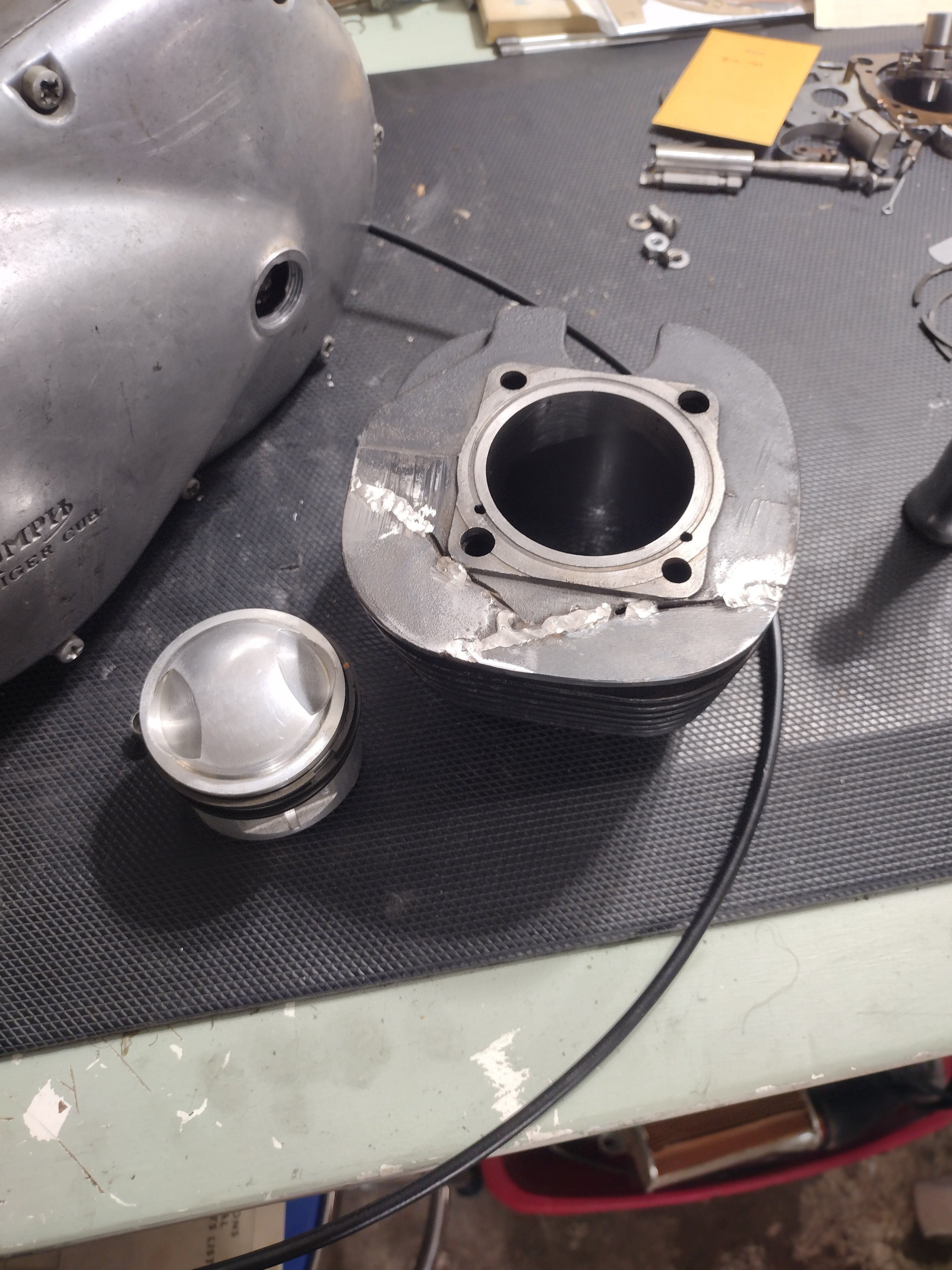

    I'm back. With everything needed to reassemble the motor, gasket kit, rings and I had my broken fins welded. I must say I wasn't super happy with the repair but considering this is a cast cyl and most of the repair will be hidden by the head, it's fine. At least all the fins are intact now. Done by an 85 year old master welder so it's as good as I can ask for.
    I have the rings installed on the piston, just need to research proper ring orientation. Ring gap is perfect. After a light skim of the skirt the jug fits perfectly. Recommended to install the piston on the rod first or put in cyl first then place cyl/piston on the rod?

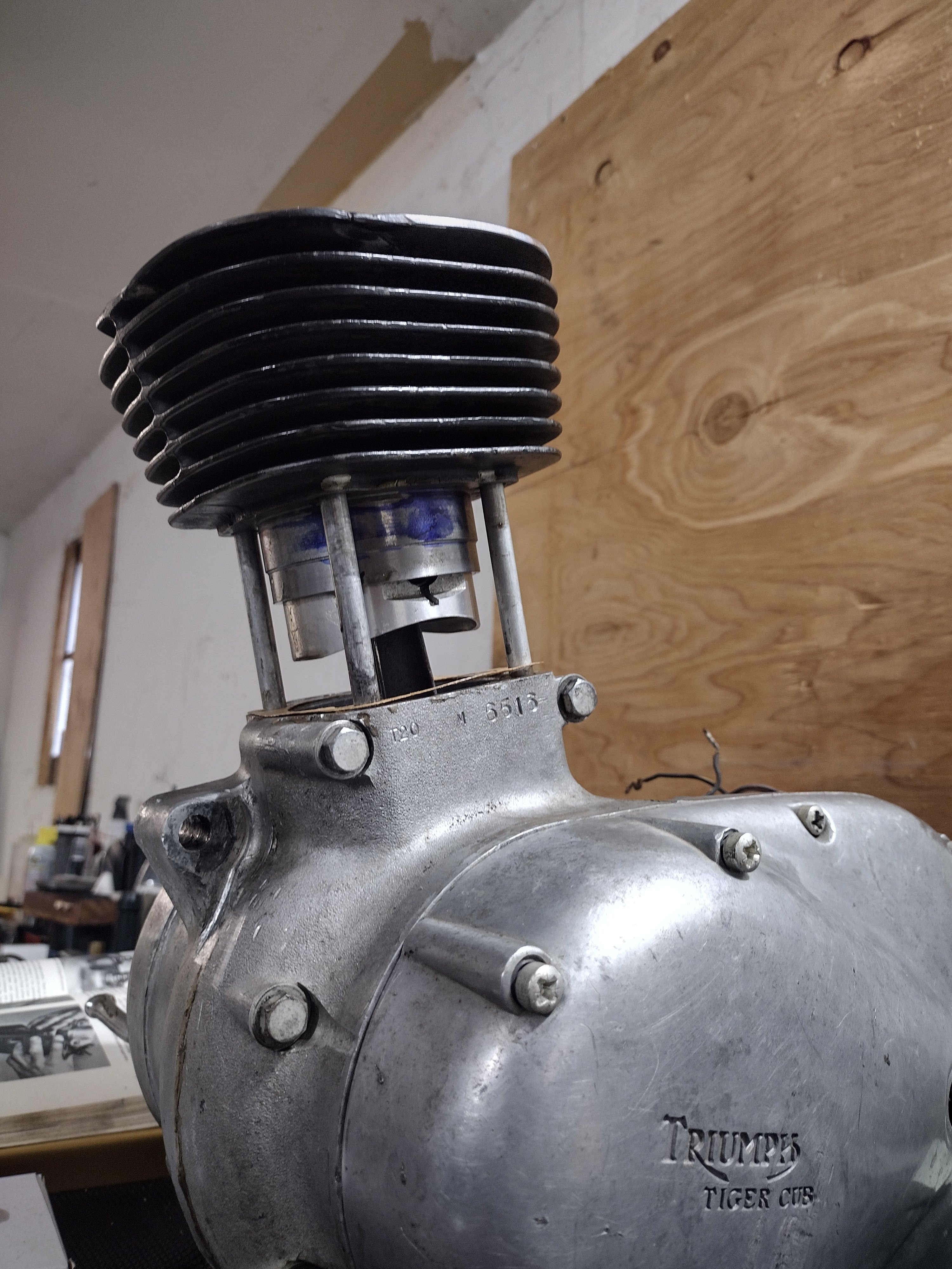

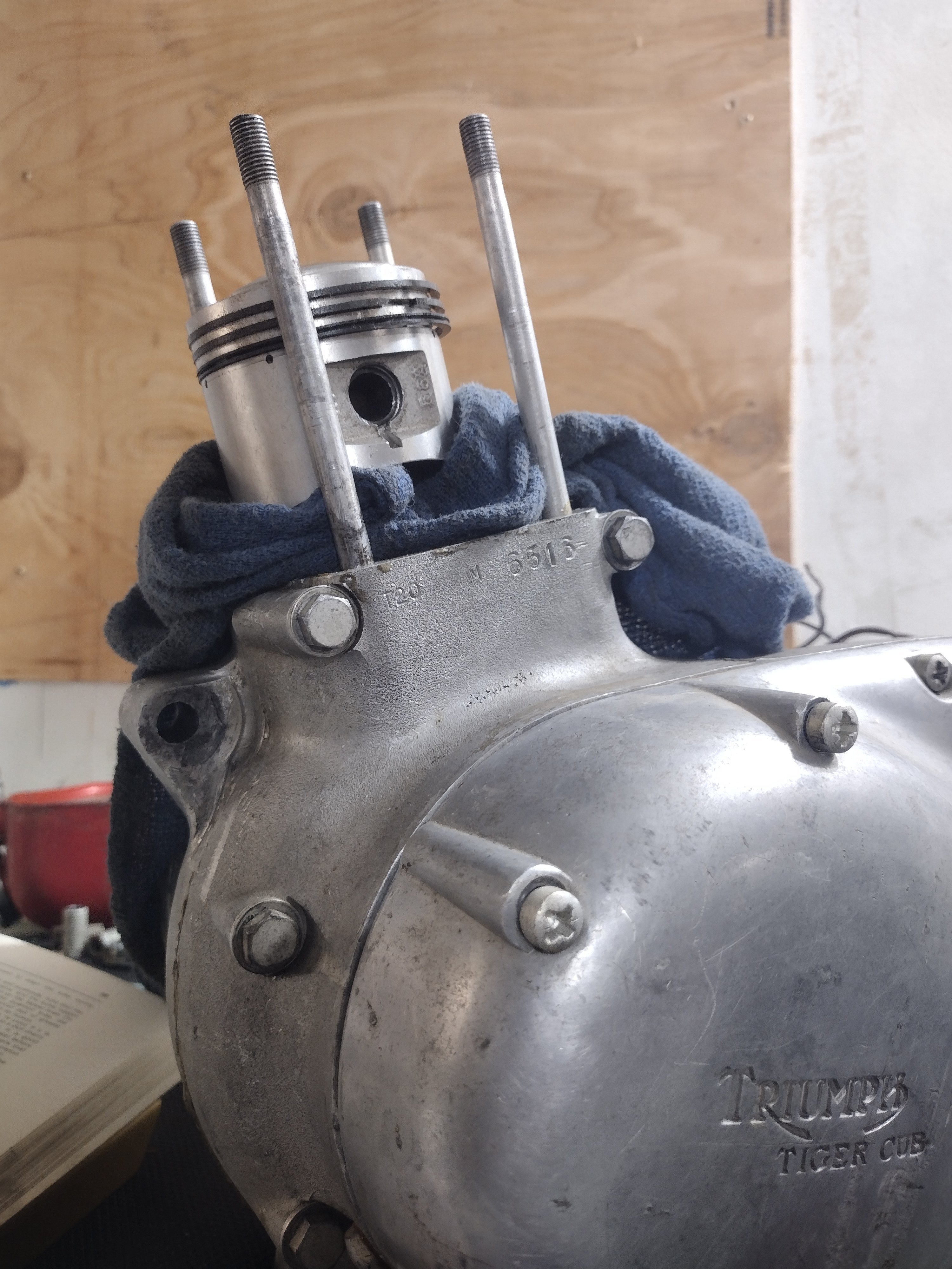

    Got the piston installed. Thought the clips would fight me but they went in fine. Fit base gasket and successfully got the cylinder installed without any broken rings. I was nervous as they are EXTREMELY hard to source. Jug slid down like butter. Here's some pics. You can see why I didn't like the fin repair but keep in mind it's cast and at least they're all there!
    Should I anneal the new copper head gasket?

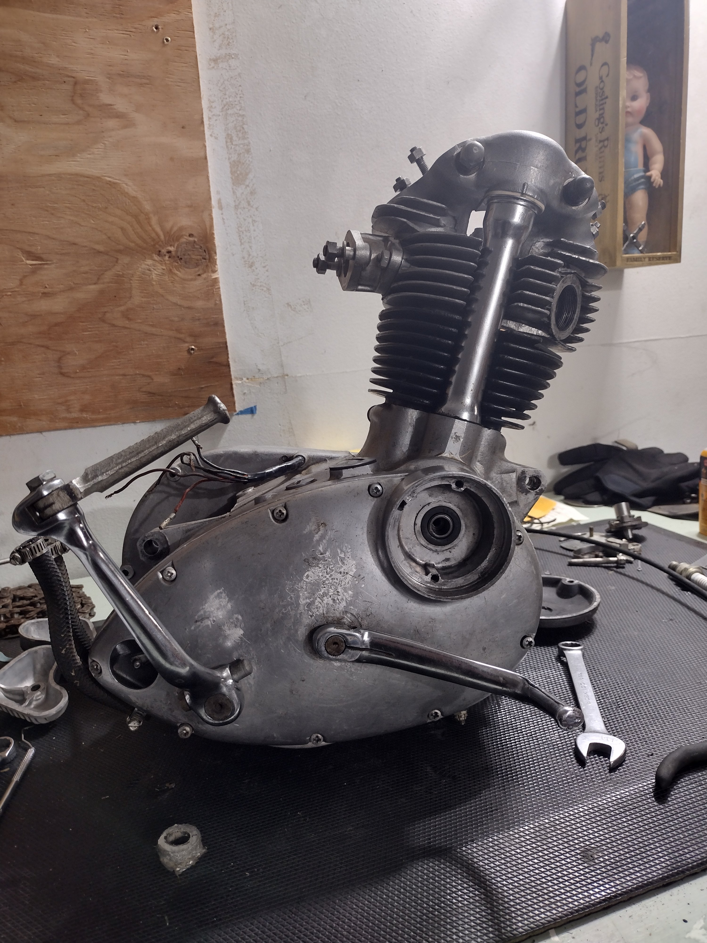

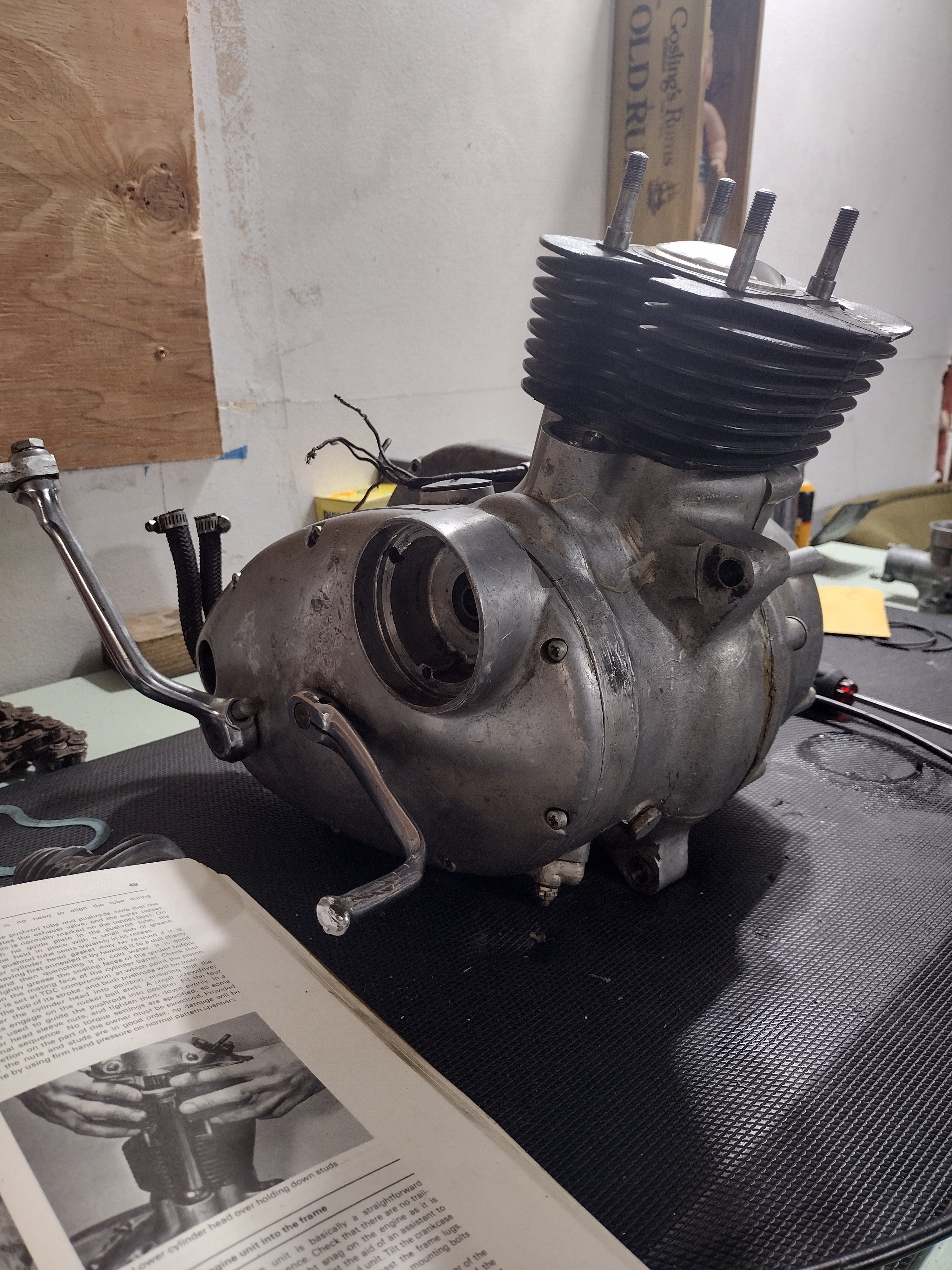

    Holy pushrods batman! That was one of the most frustrating things I've ever done. Since I beat anyone except Sandi to a post, the engine is back together. After SEVERAL attempts I got the pushrods and head installed. What a nightmare. Inlet & exhaust valves opening and closing, finally. If there's a trick to that, I'd love to know it.
    Going back to what started all this, no compression, as much as I hate to admit it I think the valves were just being held open due to improper clearance. I guess I learned that the hard way but am also on my way to knowing this engine very well. It's very possible that the pushrods were backwards but wouldn't that just open the inlet/exhaust valves wrong but still show compression?
