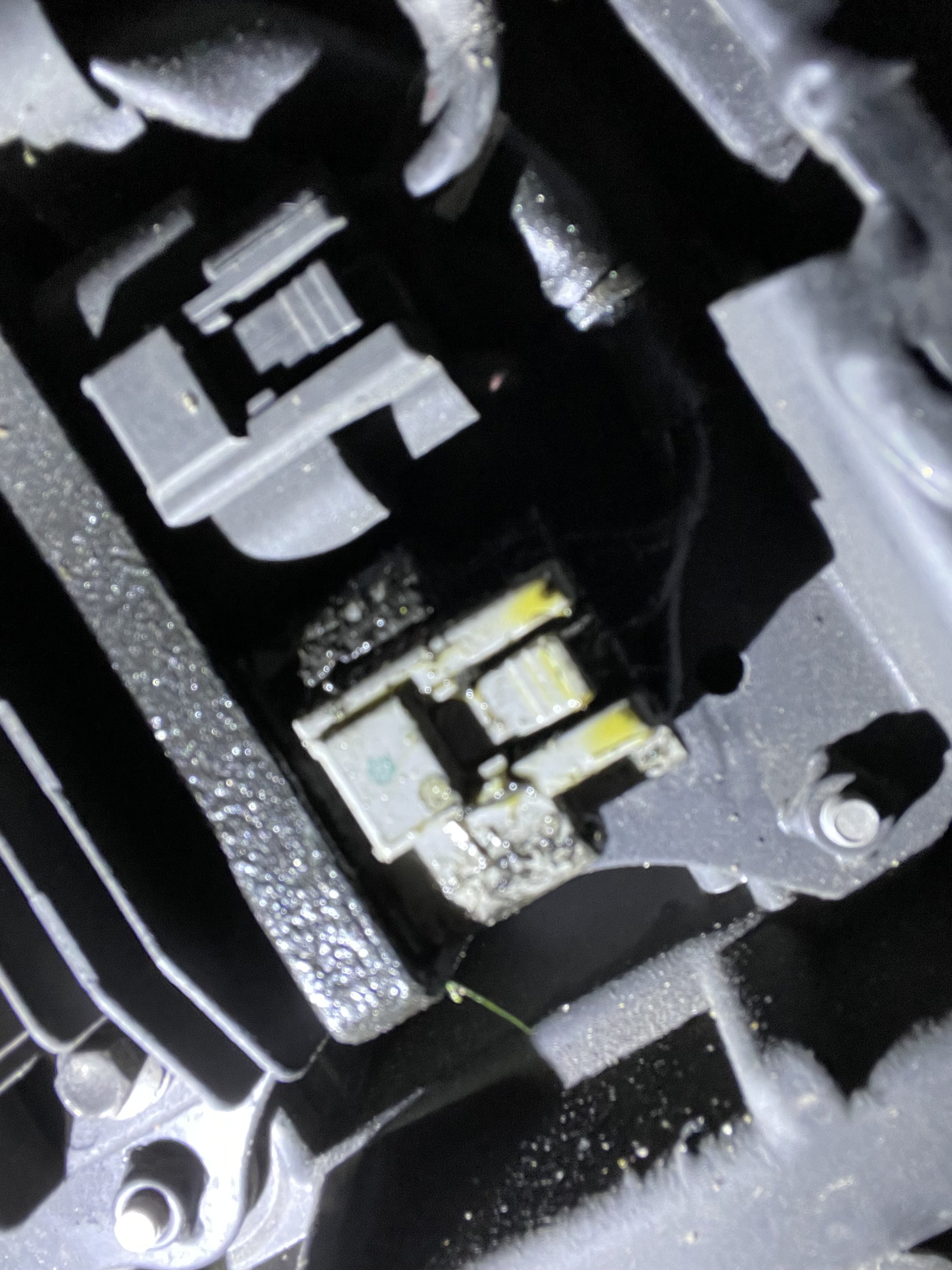

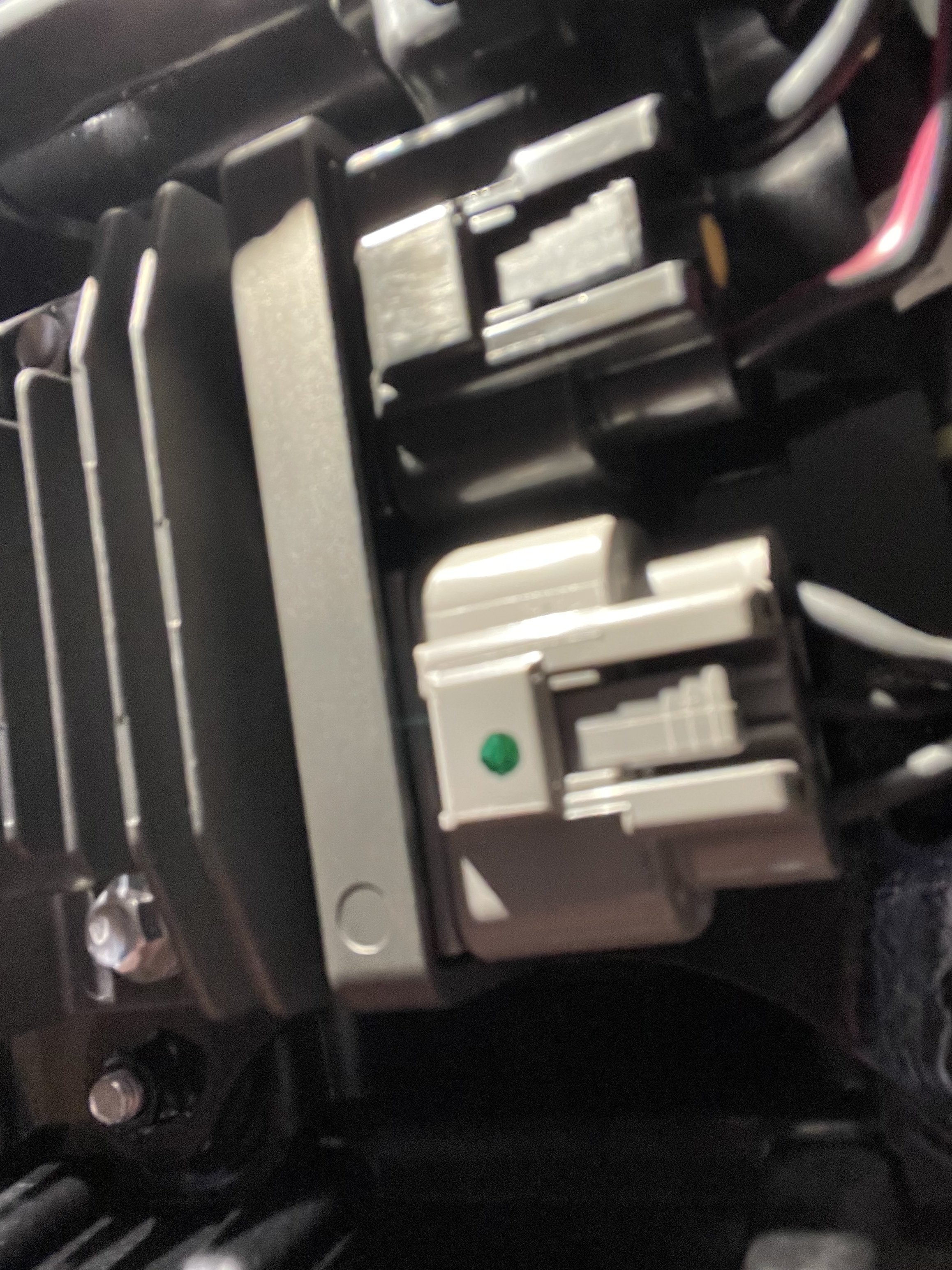

    yes. Unfortunately because I don't have the tech manual I can't give the proper terms.... I learned from a service manager in NC who had seen the issue on a couple of bikes that there is a cable which runs through part of the engine that wicks oil and it runs down it to an electrical stator ( I think that is the name) which is plugged in around the midline behind the kick stand. I'll try and show pics of a new one and what mind looked like compared to a new one.

    I think I saw on Youtube or maybe this forum that there was identification of the electrical cable responsible for this leak and a quick solution sealing the cable where it comes out of the stator. I'm really reaching here; but, I think the mechanic used silicone sealant at that exit point since the factory rubber seal was absent or failing.
    Update: found this by googling Triumph Bonneville oil leaks but still haven't found the one I originally saw but found this one instead - https://www.thetriumphforum.com/threads/oil-leak-problem.14839/ and it had this:
    'I had similar symptoms on mine after 600 miles. Dealer said leak was coming from where alternator cable exited the case through a grommet. They reckoned the cable sleeve (and/or grommet?) were split due to bad assembly and as there is an oil channel running by it, oil was leaking out. (Oil channel next to cable exit seems like a bad design to me.)'
    In the original article I found, tech used silicon sealant at the grommet; otherwise cracking the case to replace the grommit would have been costly.

    Thank you! When I pick up the bike I will find out what the mechanic did. (Fortunately it is still under warranty.) There is always the issue about trying to tell them their job but he is a decent guy and I think would be open to hearing this.
