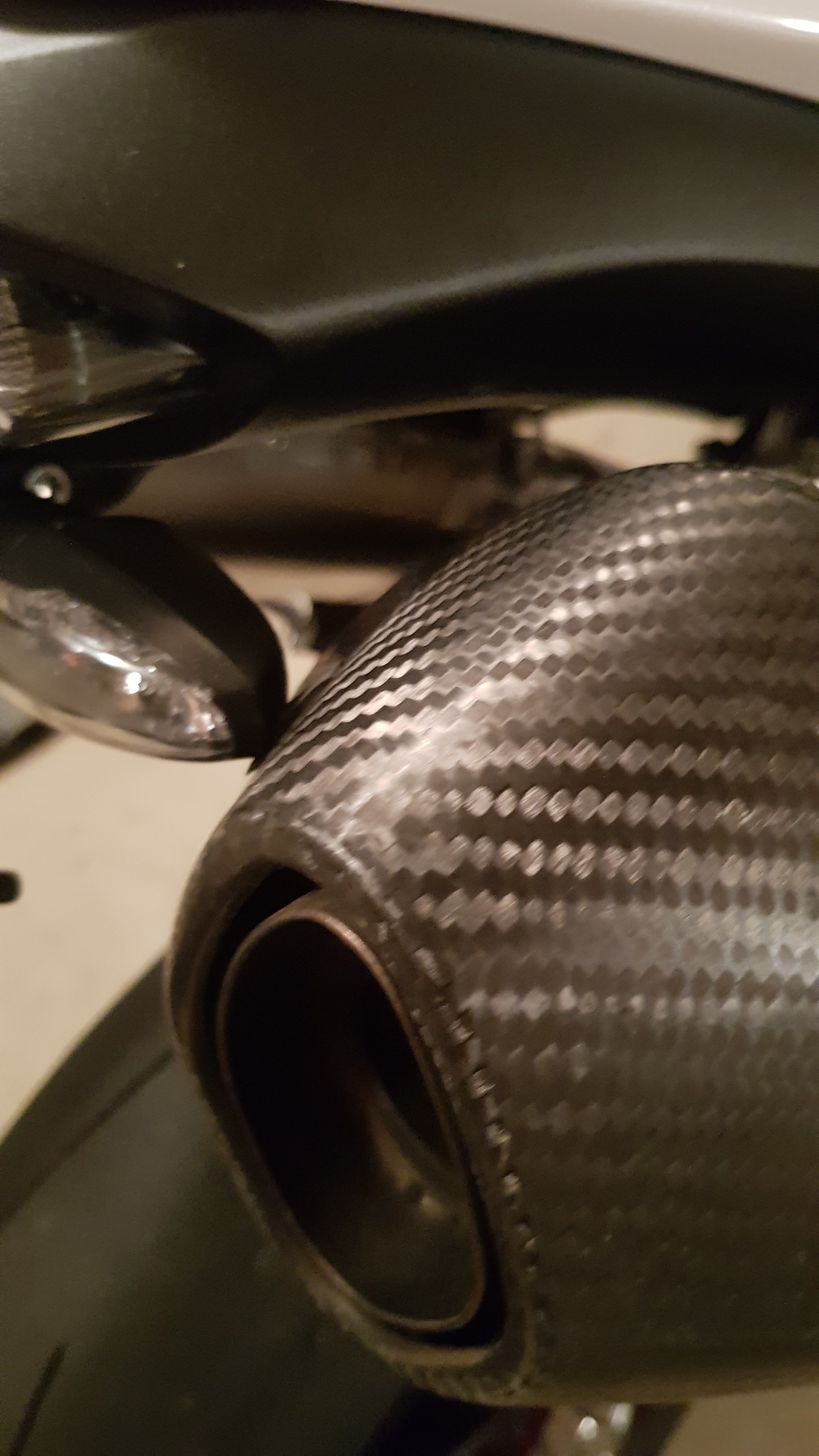

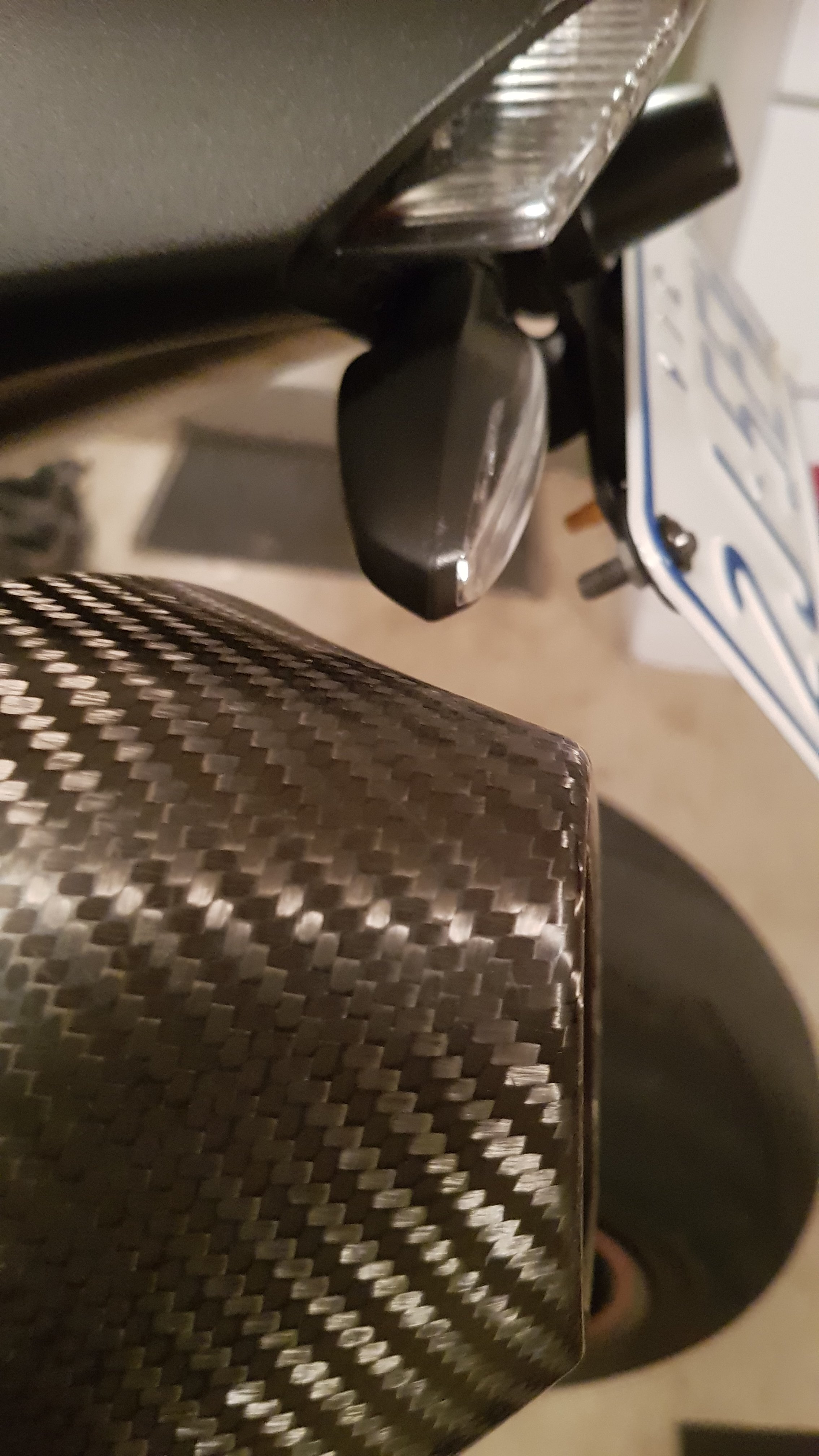

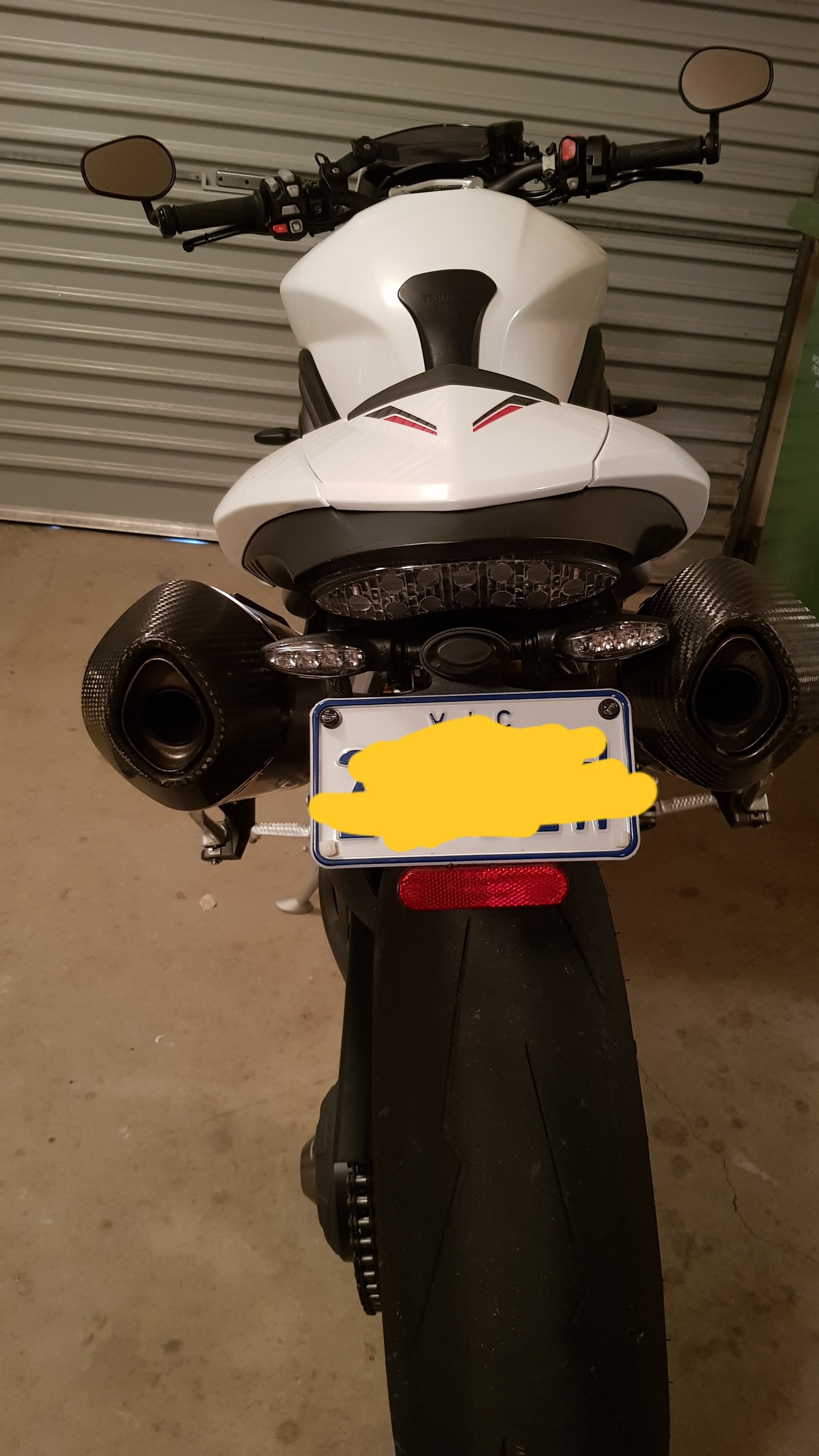

    I'm having a little bit of an issue with my Arrow twin cans as they are a bit uneven and one them is rubbing on the indicator while there is a fairly big gap on the other. Does anyone of you have a suggestion how to sort this niggling issue out. Hopefully it's a simple fix as I'm not super technically minded but can follow most step by step guides Cheers everyone and still think this is the best forum out there by a mile.

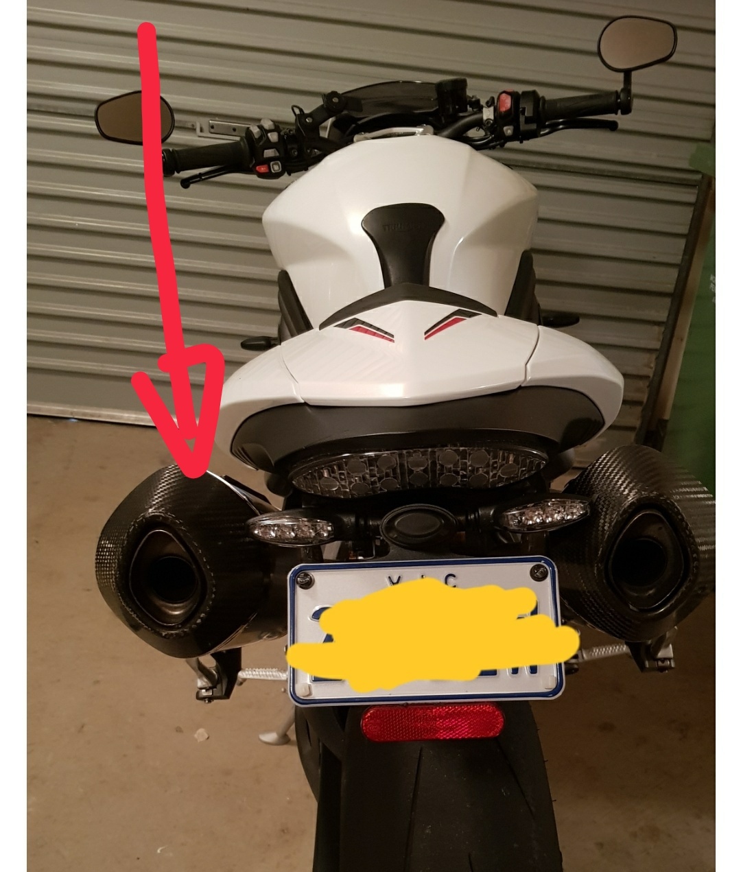

    Hi buddy
    It looks as if it's your exhausts are out of alignment to me.
    The left hand arrow is a mile away.

    Yeah I agree mate it's a good cm or two. Any suggestions?

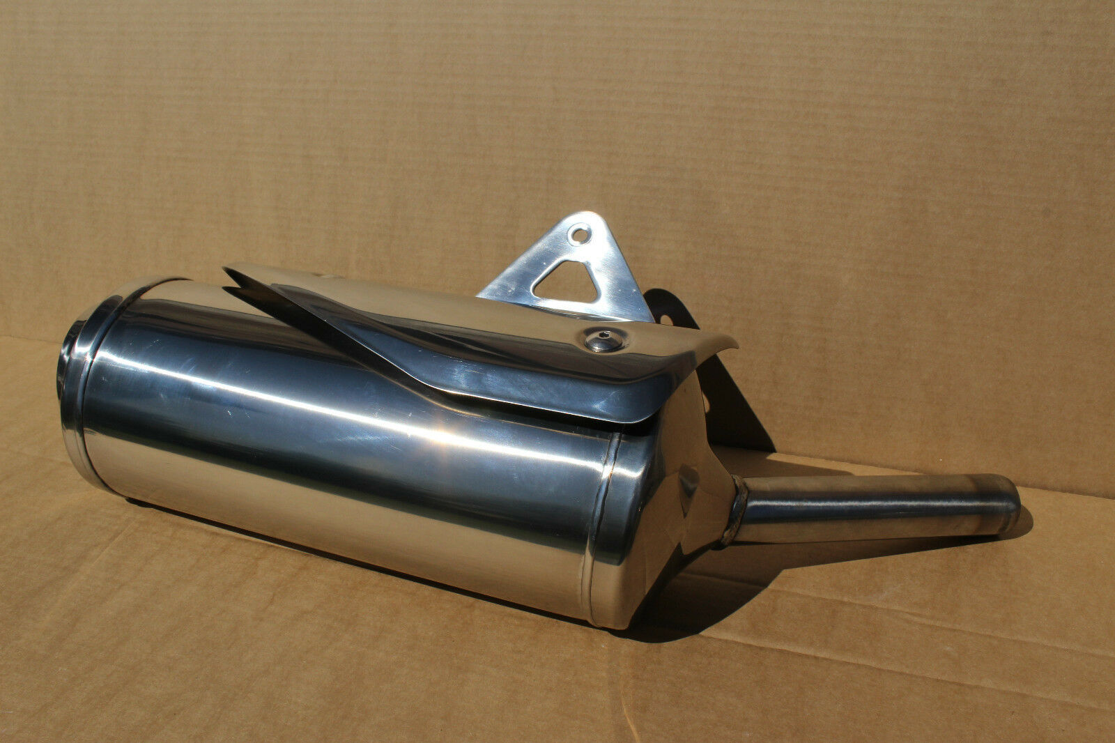

    I know, like this below. But it does work, I've done it on my Street Triple a couple of times. Same principle also works on my Bonneville as well.
    Once the clamp is loosened, it allows movement of the end of the silencer. Because the silencer pipe is not straight, you can kind of change the pivot point and the end of the silencer moves left and right.

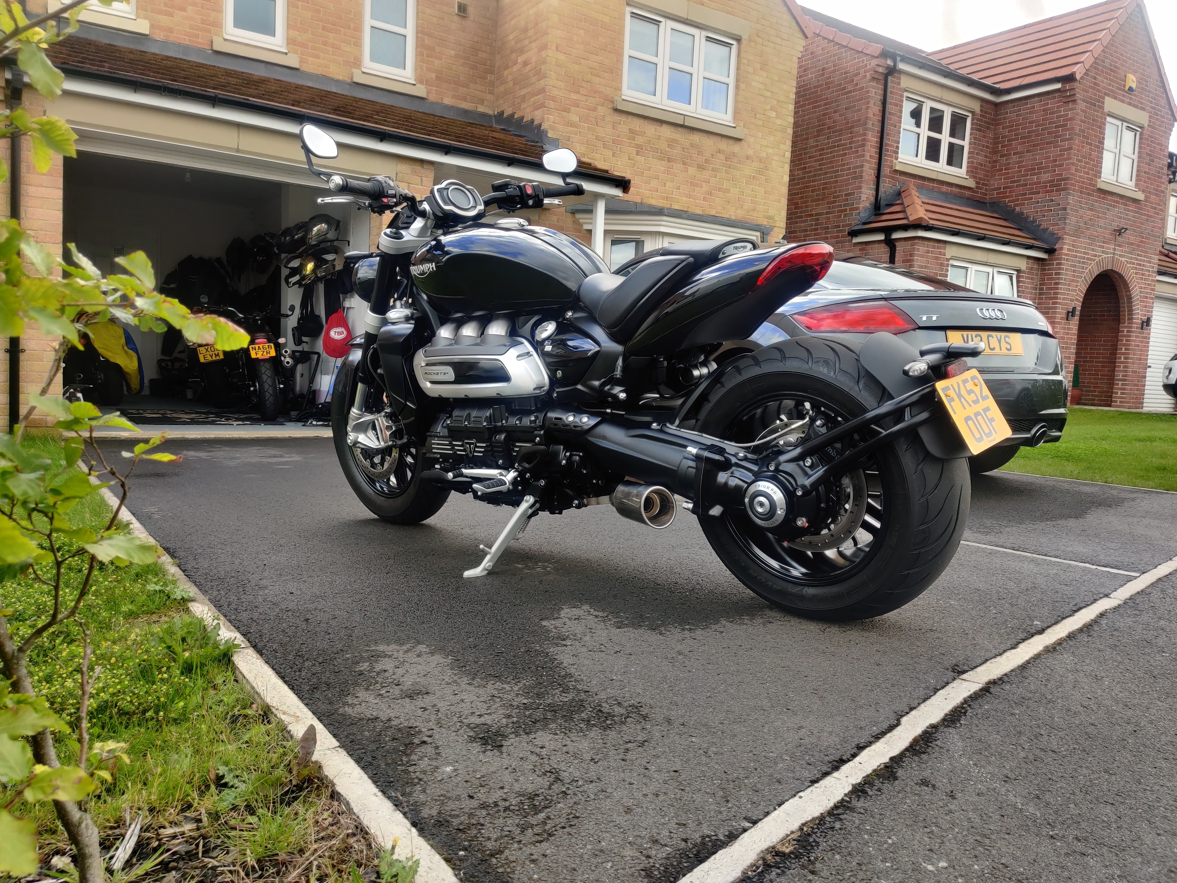

    It does your completely correct Mrb, I've done it a few times on mine, I'm sure it only gives you millimeters of movement/adjustment, just take a look at this fellas exhausts, it would take a miracle to move it cm's :scream::joy:
