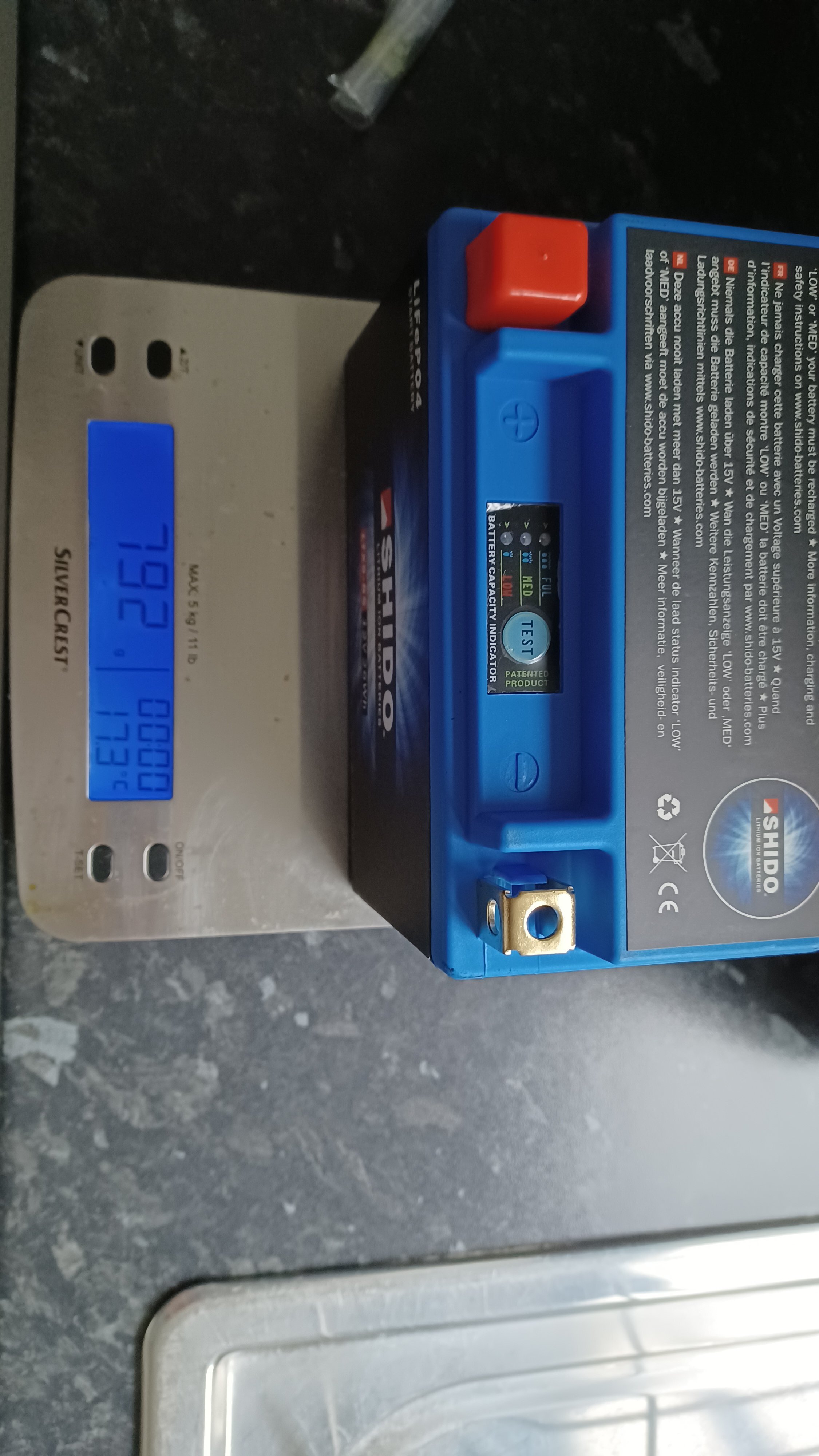

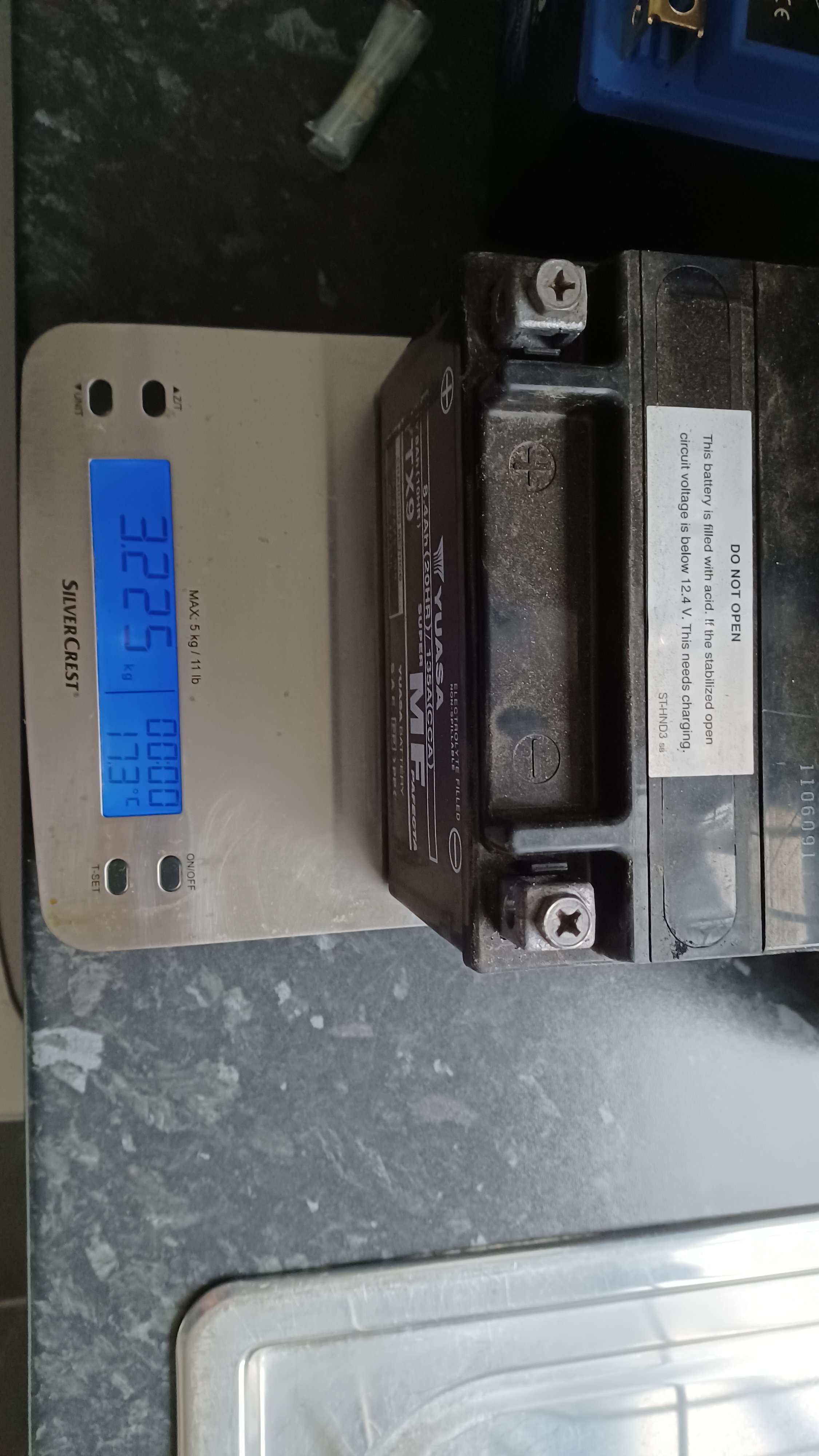

    The weight reduction of a lithium battery is certainly nothing to discount...[/QUOTE]
    Just picked a Shido for the Street Triple from Halfords, LTX9 BS. Couldn't help but put the batteries on the scales, hope there is actually 20211115_140628.jpg 20211115_140720.jpg something in the Shido box!
