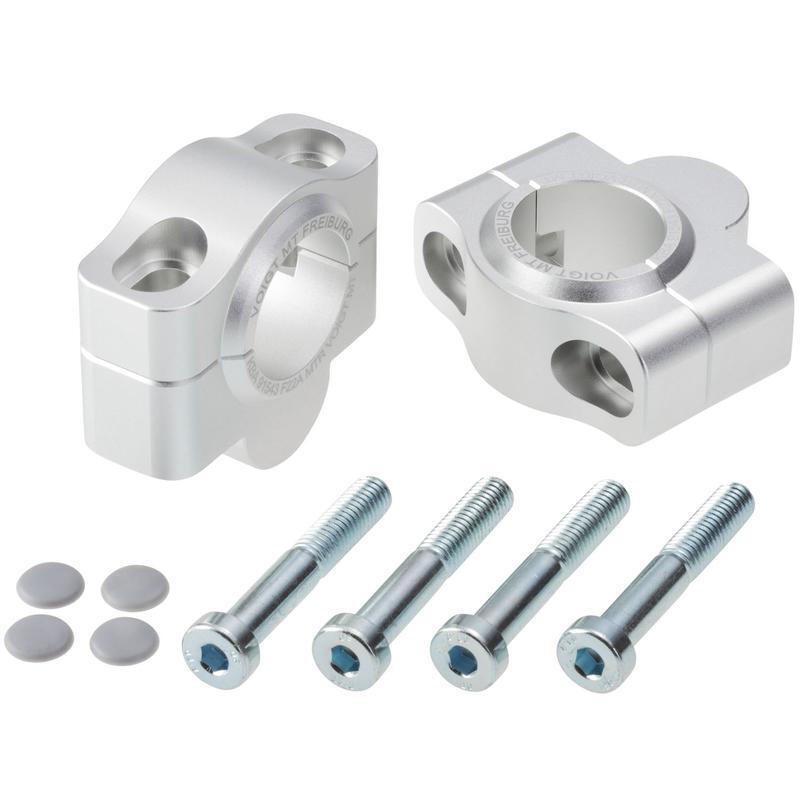

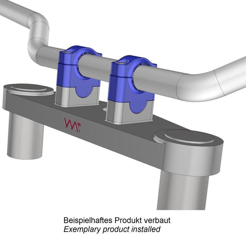

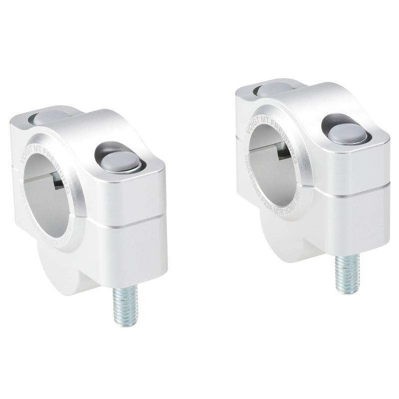

    Just wondering is anyone has fitted handlebar risers to their 2018/19 Speed Triple.
    interested in what size you used, where you got them, issues with cable length (doesn't seem to be a lot of slack available) or any other useful info or pics you might have.
    Not a lot available here in Oz, found the below that look like they should fit, but don't specify the Speedy....
    https://www.motorradgarage.com.au/i...anywhere=bar risers&limit=100&product_id=2512
    Cheers
    Wayne
