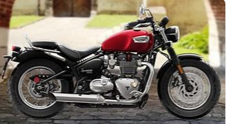

    I know some people like the red/black combo. I don't. I always thought it looked like the bike was assembled from leftover parts. Maybe it's an OCD thing. I bought it because the price was right (2018 leftover) and it was the only Speedmaster on the floor. Always figured on having it painted, but I thought I'd give it some time to see if the original paint scheme might grow on me - it's been a year -
    it hasn't.
    Nothing fancy going on here.
    I have this:
    I'm going for this:

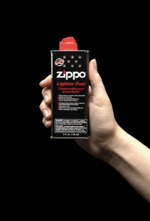

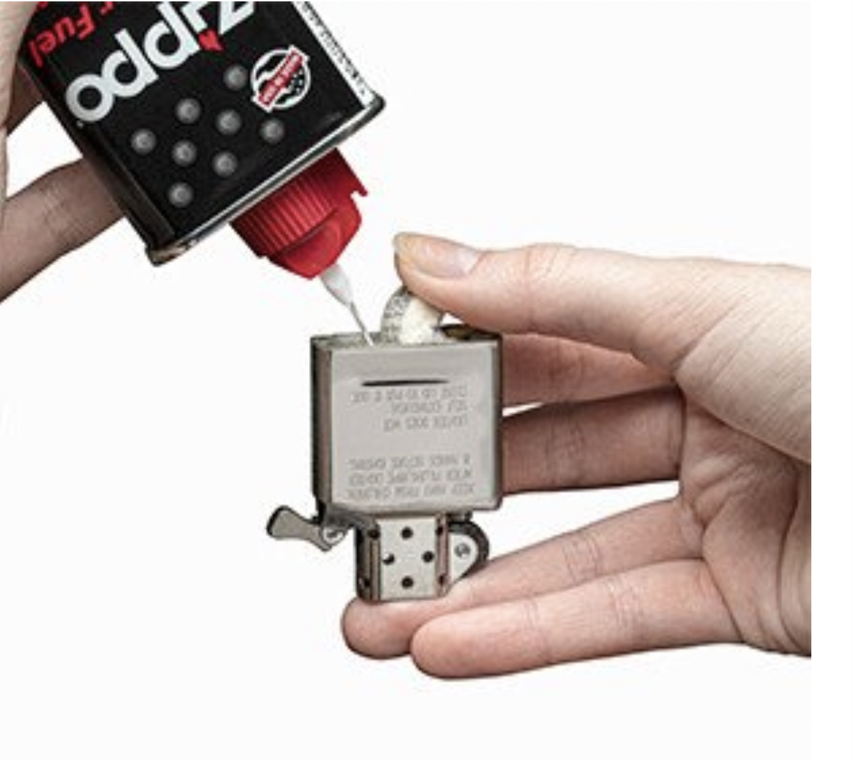

    I'm reminded of a tip I got from the Service Manager at my local Triumph dealer (Arizona Kawasaki--KTM--Triumph). He's a stickler for detailing vehicles. When I told him I used Gu Gone to remove remaining adhesive after removing things like badges or reflectors, he said that he had a better way--lighter fluid. Yes, you read that correctly. Lighter fluid! I asked him a bunch of questions since it seemed like a rather odd and somewhat scary proposition. He instructed me to put a very small amount on a rag, wipe the sticky bits, then follow that up with wiping the area with a wet rag to clean off the lighter fluid. I have to say, after trying it the first time several years ago, I'm sold. It works beautifully. I have a small container of lighter fluid that has a very small spout. I put just the smallest amount I think might do the trick on a rag and it take the adhesive right off! I then make certain that I've removed all traces of the lighter fluid. It works WAY better than the Gu Gone I was using or any of the other things I've used previously.
    I've only used this lighter fluid method on regular paint (not matte paint) and can't remember using it on chrome although I think I have. But I'll let you know how it works on chrome because I'm going to remove the reflectors from my new Fat Boy this weekend and they are all adhered to chrome parts. The first time I tried it I used it on an unobtrusive area of my bike because even with the service manager's reassurance that it wouldn't harm the paint, I still felt a bit uneasy. No problems at all. Has anyone else tried this??
    This is what I use.
    This photo is just to show you the spout on this particular product. It's really helpful in putting just a small amount on the rag.

    Hi @Sandi T , lighter fluids are highly refined top end of the oil spectrum when the raw oils are distilled , so it's got very small very active molecular properties, similar to the plant based Eucalyptus oil ! Eucalypt tree's burn very hot because of this ... Sometimes as hot as 1200/1600°c
