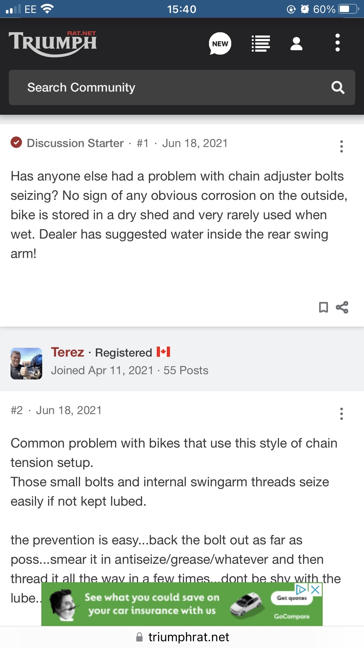

  11. Gary_P
    Gary_P Active Member
    May 19, 2016
    247
    As mentioned by Pegscraper, it seems this is a known issue:
